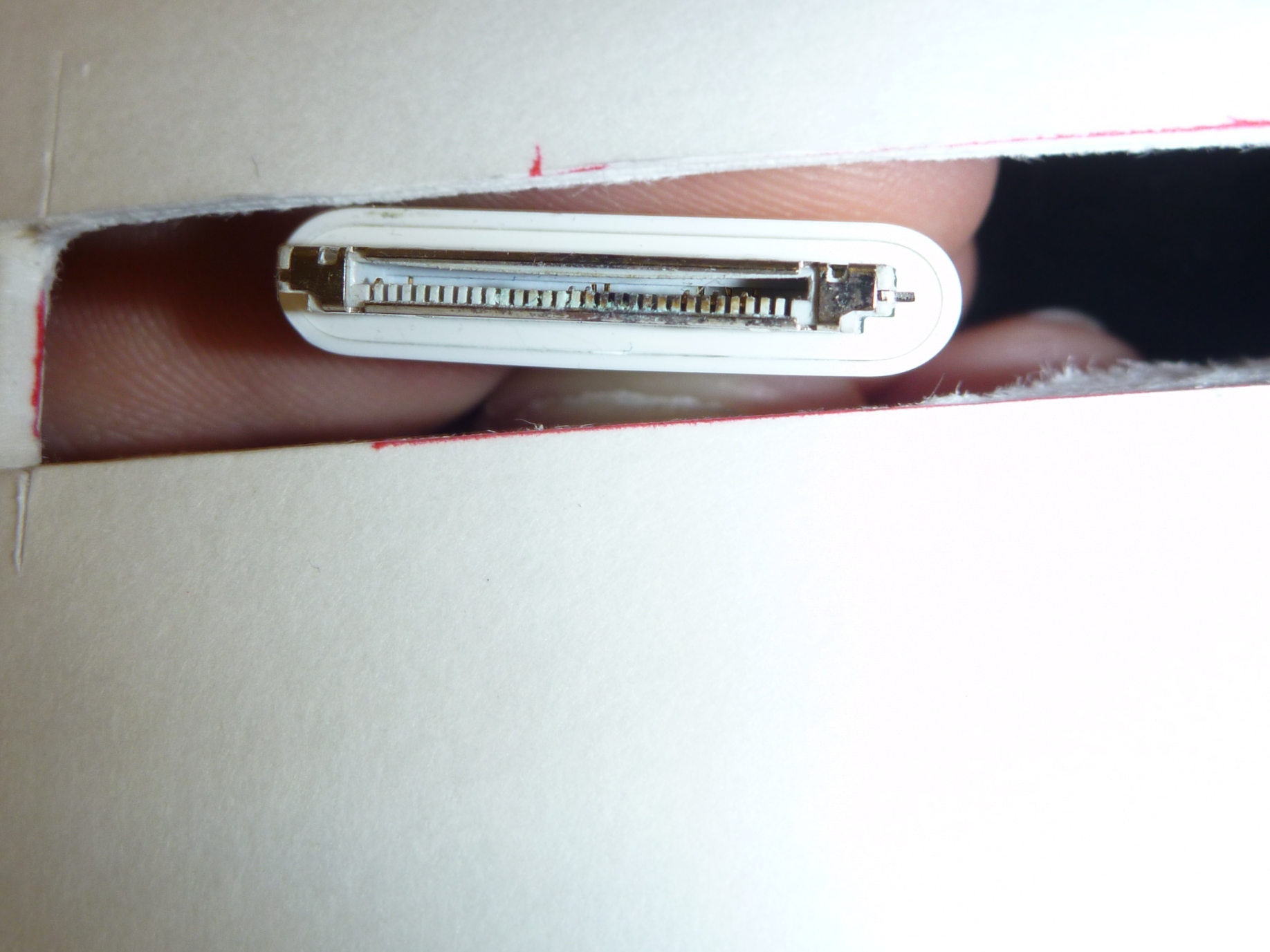

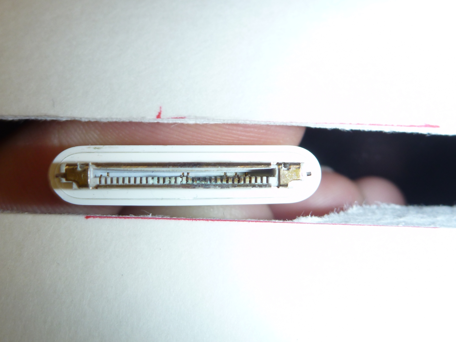

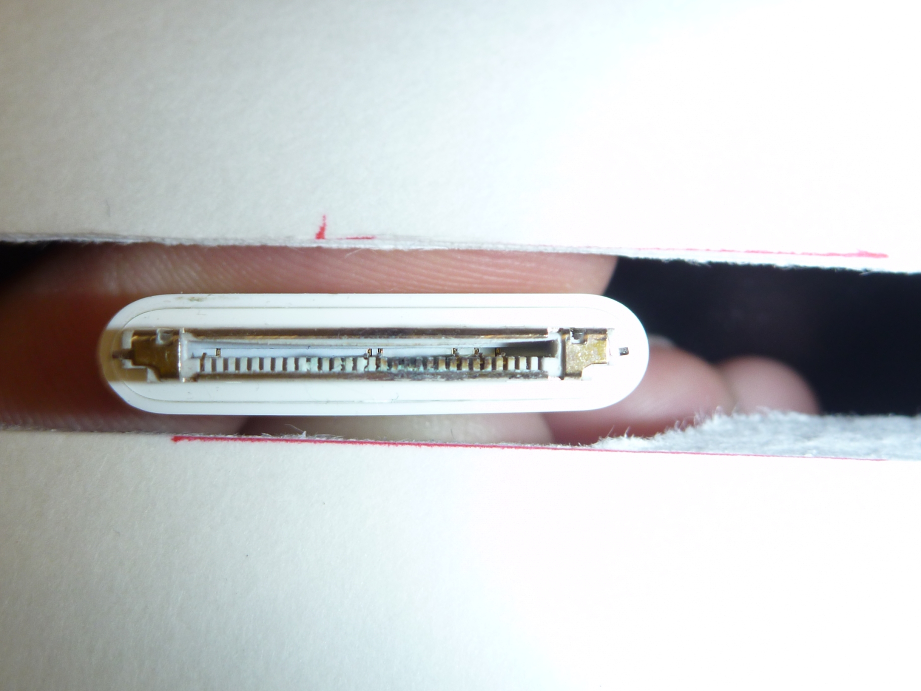

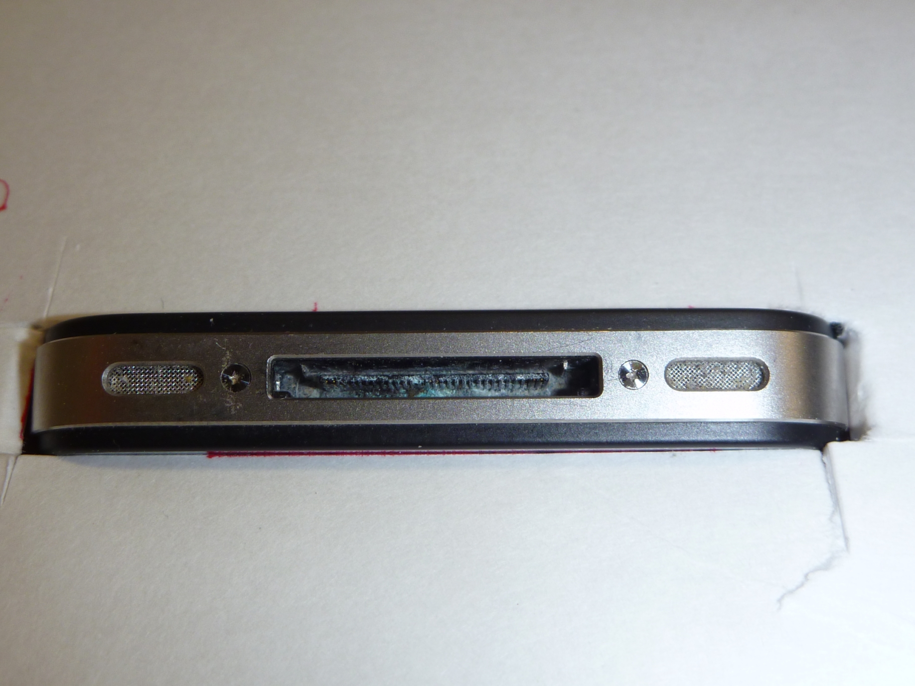

Last night I plugged my 16gb black iPhone 4S into the charger and went to sleep. I woke up an hour or two later to my phone vibrating a lot and lighting up, like it was being unplugged and plugged back into the charger multiple times per second. I picked it up and was almost burned by how hot the phone was. As I gained my senses after waking up, I could also smell electrical smoke. I quickly unplugged the charger from the surge protector, and looked at the phone. I turned on the lights and saw that there had been short circuit and almost a fire at the connection point between the charger cable and the phone.
Some background about my phone: It is just over two months old (per-ordered and received on Oct 14), it has never been dropped, and it has never been wet.
I've heard or batteries overheating and catching on fire, but rarely a connector fire. I took my phone into the Apple Store today, and got it replaced for free in about 10 minutes. The Genius Bar employee who helped me told me that Apple Stores see about one fire replacement per month, I did the math, and with about 358 Apple Stores (as of November, 2011), this means that over 4000 iPhones are catching on fire every year. This seems like a very high number, even with the millions out there. If over 4000 of a certain car model spontaneously erupted in flames every year, there would be massive recalls. Why not with the iPhone?
Here are some pictures of my phone and the charger cable.
Any thoughts?

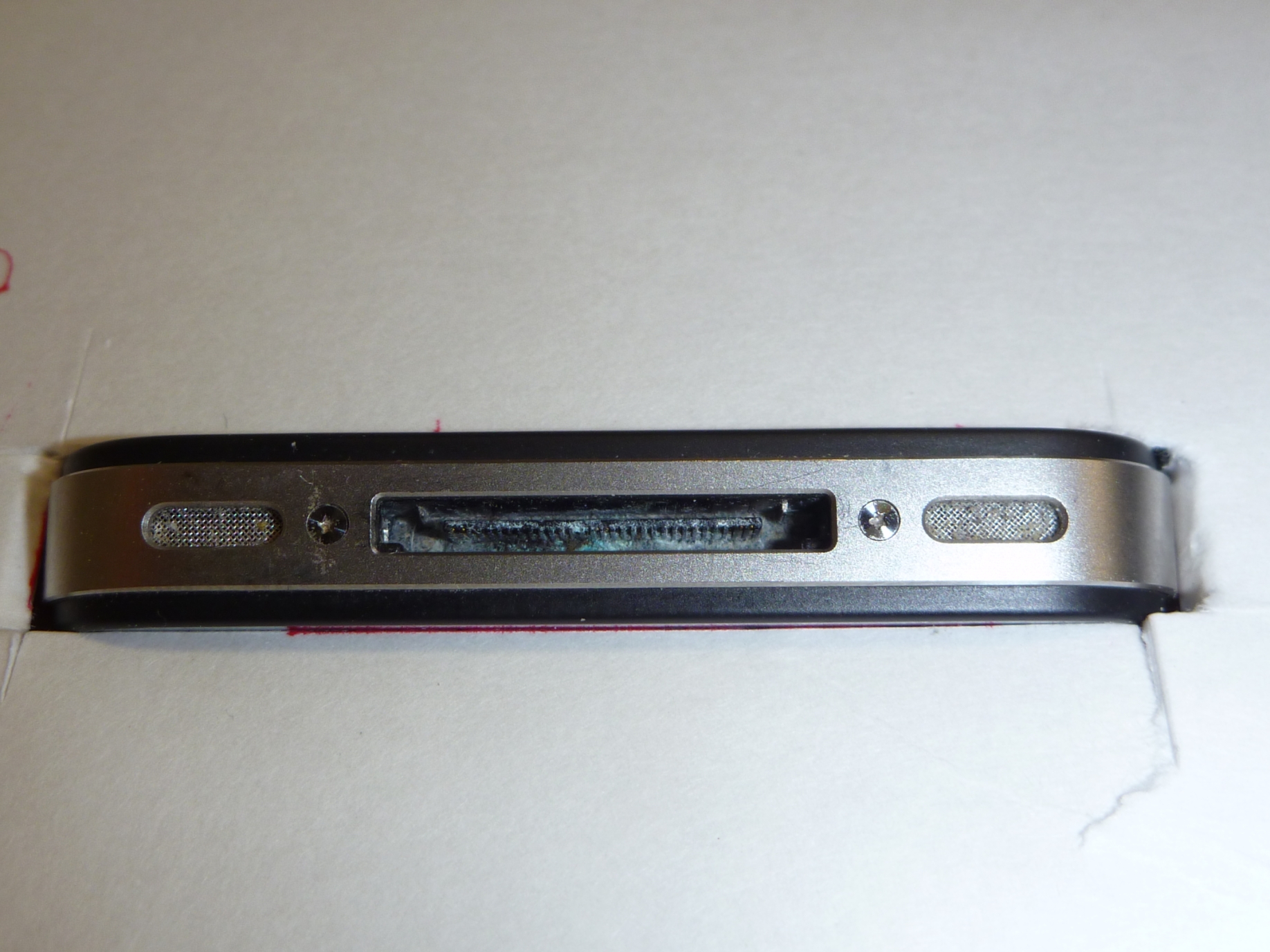

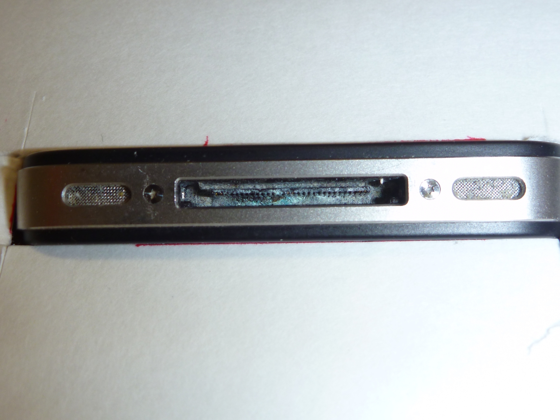

Hate to say this but this looks like negligence. Why?
If you look at the pictures of your dock connection and the areas surrounding it, they are GREEN which indicates CORROSION. Only way to get green in your connectors like that is via water or moisture. Fire doesn't do that. Moisture causing contact points to short, would cause overheating, smoke, electrical issues and eventually fire if not dealt with.
Also to mention, it doesn't seem like you take care of your phone if after 2 months it's all gunked up like that at the bottom. Note the screw holes and the speaker/mic grills. Also along the steel band/bezel.
What this boils down to is lack of care from the consumer.

Fire DOES NOT cause connectors to turn GREEN like in your photos. WATER/MOISTURE causes corrosion. FIRE chars/burns/melts.
Why not pull off the back glass and see the inside? Post pictures of that? Would be curious to see what took place inside.
Corrosion-
You are such a fool if you think that only water can cause corrosion. Battery acid corrodes metal much faster than water ever can. The picture you posted is irrelevant, you don't even say what it is or how long it was exposed to the corroding substance. I had my iPhone 4S for just over two months, and I charge it every other day or more often. Do you really think that it could have been wet for all that time and suddenly catch on fire yesterday?

@OP: Clearly there was corrosion in the Dock connector which caused the short circuit. Not battery acid after the fact. You got your phone replaced so I don't see why else you'd need to tell us.

Um, no offense but I don't see how the battery can "leak" into the connector port since the connection for the battery itself isn't even located near the port. And for that much battery leakage, I think a fire was the least of your issues.

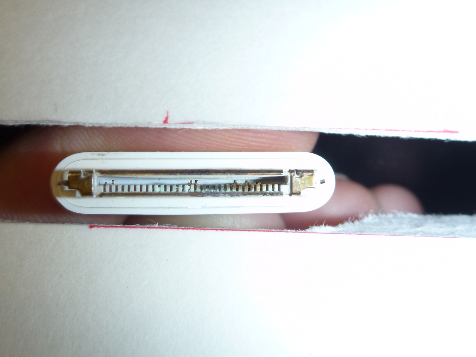

Just looking at the 30 pin dock connector cable photo (#3) you can see the cause of the spark. See those awesome bent pins which are pushed back from using force to plug in an idevice? That caused the short.
Sorry to break it to you but if you were my customer, I would have had you pay for that had you brought in the cable with the phone. Then we could've had a long fight how you claim that you take 100% care of it then demand to talk to my manager but I filled him in that it's neglect and you'd have to pay.
The battery in the 4/4S has about a half inch + between the dock connector and the battery itself. In between them is the audio board. The only time recently I've seen one get hot was near the camera during charging and that was beyond normal temperature.
It's damaged similar to the way a MagSafe connector will get burn marks when the pins on the power adapter are stuck in.

The corrosion you see is due to the battery acid leaking and corroding the metal itself.
I'm not going to say that there was negligence or not, because I don't have the information I'd need to make that determination.
What I DO know is this: if the battery's "acid" had in fact leaked out, it would've done far more than just corroded the contacts of the connector. In fact, any picture you would've posted after such a "leak" probably wouldn't have been recognizable as the bottom of an iPhone 4S.
IF that's corrosion, something else likely caused it. What? I don't know, because I don't know the history of the phone. But it's certainly not any battery "acid" that's inside the phone itself.
But ya know, I don't deal with this **** everyday (sarcasm) and I'm sure your genius just replaced it because it's the holidays or didn't feel like dealing with it.
Either liquid or bad pins it's still damaged.

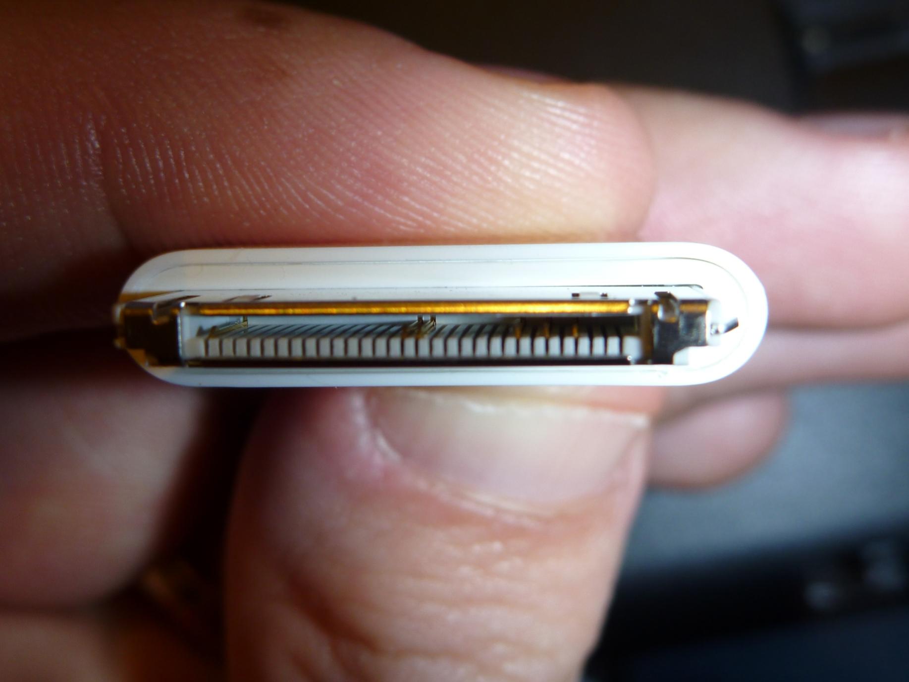

It sounds like work at an Apple Store and you don't know your own product. The new cable I got today has the EXACT SAME pins sticking up. Here are pictures to prove that you are wrong. I would have made sure your manager was informed that you have no idea what you are talking about when it comes to knowing the products you sell.

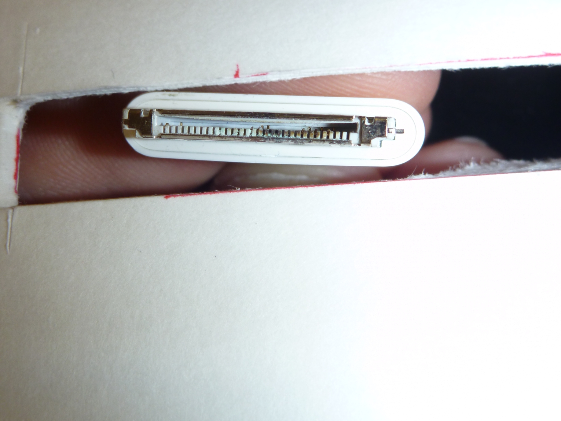

EDIT (again): @OP: the corrosion on the iPhone connector is not matched by corrosion on the cable, and the corrosion on the iPhone connector seems widespread and rather heavy. I'm just saying that if the iPhone leaked corrosives as you hypothesize, then it would cause comparable corrosion on the cable connector. Perhaps the phone got wet without you knowing about it - have you ever lent it to somebody? Do you live near the ocean?
