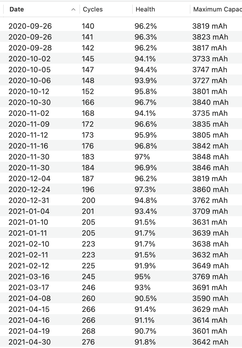

Apples battery health won't show you but that percentage fluctuates all over the place. I wouldn't worry about it.
Couple lines down further and it goes back up to 94%. And how 10 months later its at 84 according to Coconutbattery and 82% according to Apple. On top of that its 70 dollars for me to have Apple replace it. While I'm by no means rich I've never lost sleep over a 70 dollar bill I might need to eventually pay....
The battery health statistic varies from battery to battery because of the variances in the batteries themselves. It's also not linear. You can drop a few points in a week or two then remain on a given percentage point for 6+ months. As stated above it goes up and down. Different applications record it differently as well (cocoanut vs iOS). People engage in pedantic charging routines with wildly different results from user to user. (40-48, bla bla bla)
Since it's really not reliably predictable or meaningful, it becomes a completely useless metric.
