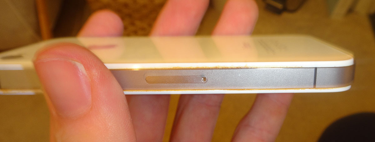

The phone continued getting hotter for the next 20 minutes or so, to the point where I could no longer hold onto the phone without discomfort. The heat was especially intense around the point on the metal band where the gap is (the antenna I believe?) Seriously, you could not hold the phone for more than a few seconds. Eventually, the heat died down, I guess because it ran out of power.

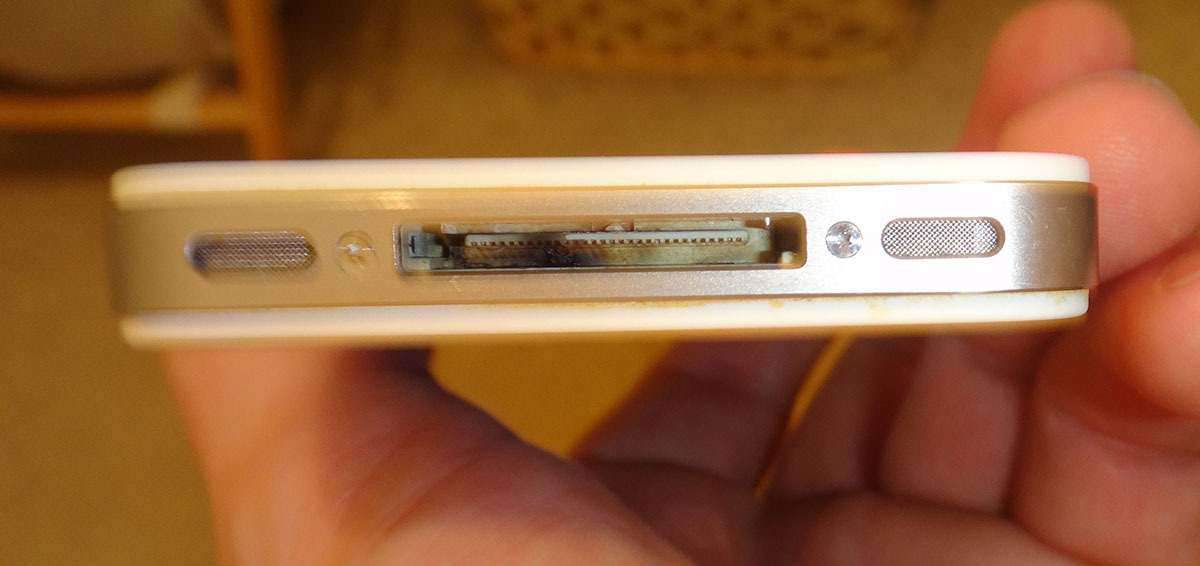

It was then I noticed some kind of discharge from the dock connector..

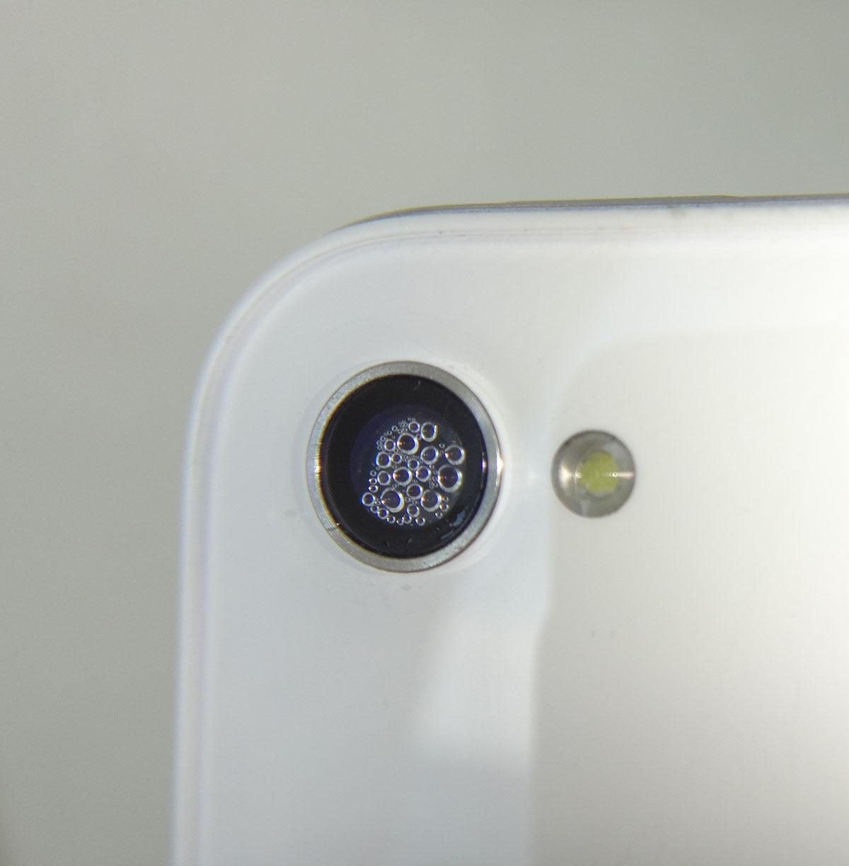

As the phone cooled down, the discharge continued, and condensation then started to form behind the camera lense..

Apparently, the reason is that the condensation behind the camera means it has come into contact with water. Not being her decision, I calmly explained that the 'water' only appeared as the phone went from being red hot, to normal temperature. She could not really advice on this, and has told me I need to visit an apple store - which is 40 miles away, and it is likely that I will have to pay for the replacement. Does this seem fair to you guys?

I'm asking because something had to trigger this, and the most common trigger is a short circuiting of the connectors.
Maybe it WAS a bad battery that jsut decided now was a good time to fail. But I can see where the skepticism on Apple's part comes from though. The crud on the dock connector looks a lot like metal corrosion, and where there's heat, there tends to be fire, not water condensation.

Can you see the 2 water damage indicators, or are they obscured by the damage? Surely if they are still both white apple dont have a leg to stand on?

This happened to me with a 3gs. Long story short, either the condensation or the "discharge" triggered a liquid indicator and I fought with apple until they decided to only charge me $50 to replace the phone (as opposed to the $200 they initially offered). I took it because at the end of the day it was my word against theirs and they have no reason to believe me. They could have also argued that the hardware failure was due to contact with water.

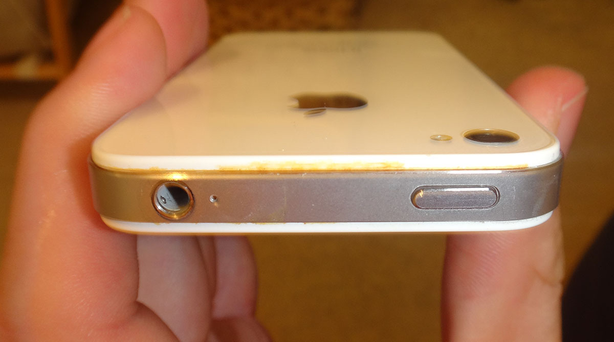

Luckily for you, it appears none of your indicators have triggered (you'd see a red dot in the headphone jack and/or near the charger jack). You have a very solid case. I would say its worth fighting even if you're told "no" a few more times.

Well, I've just had another look at the sensors, and they definately arent red. Is it an obvious red colour? From what I can tell they look white. The headphone sensor definately is white, but the dock one is a bit chargrilled, but certainly doesnt appear red

And the condensation on the lense.. this appeared only when the phone had become super hot, and then began to cool down. At least thats when I noticed it. It quite quickly disappeared though
I dont have a chemistry PhD, but here is my thought.
The condensation on the lens might not be water. Water condensation can only appear on the lens when the lens is much cooler, which contradicts to what you've told us. (Try breath onto a piece of hot glass and you won't find any condensation.) And if the droplets on the lens is the water condensation, they shouldn't disappear this fast either. Because the evaporation point of water is pretty high too, and if the water droplets got trapped in the inside of a device, it will stay there for a few days at least.
That means there was no water inside your iPhone when the iPhone became very hot.
Yeah, agreed.. I dont think its condensation as such. But I dont know what could evaporate within the phone to leave these droplets?

. Apparently, the reason is that the condensation behind the camera means it has come into contact with water. Not being her decision, I calmly explained that the 'water' only appeared as the phone went from being red hot, to normal temperature. She could not really advice on this, and has told me I need to visit an apple store - which is 40 miles away, and it is likely that I will have to pay for the replacement. Does this seem fair to you guys?

The condensation is probably from the battery liquids. If this happened to me I would demand a full refund and a new phone.

Insist that it was NOT water condensation, (which I don't believe it was), and both LCI's are not damaged. Good Luck.
