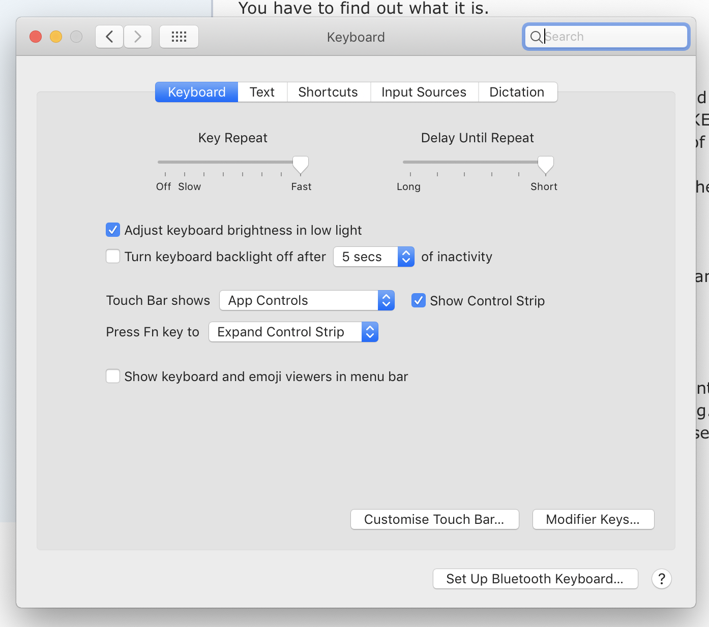

I had this fault some time ago, it was due to the backlight on my keyboard, when the backlight went out, and I turn moved the mouse or something it caused a few second lag. To solve this, I just left my keyboard light on all the time.
I was fuming when this was happening for the first time, I too thought about a robotic arm, or at least a programme that would move my mouse a few pixels every second.
Hopefully this works.

Unfortunately, the default settings are already like your screenshot =/
