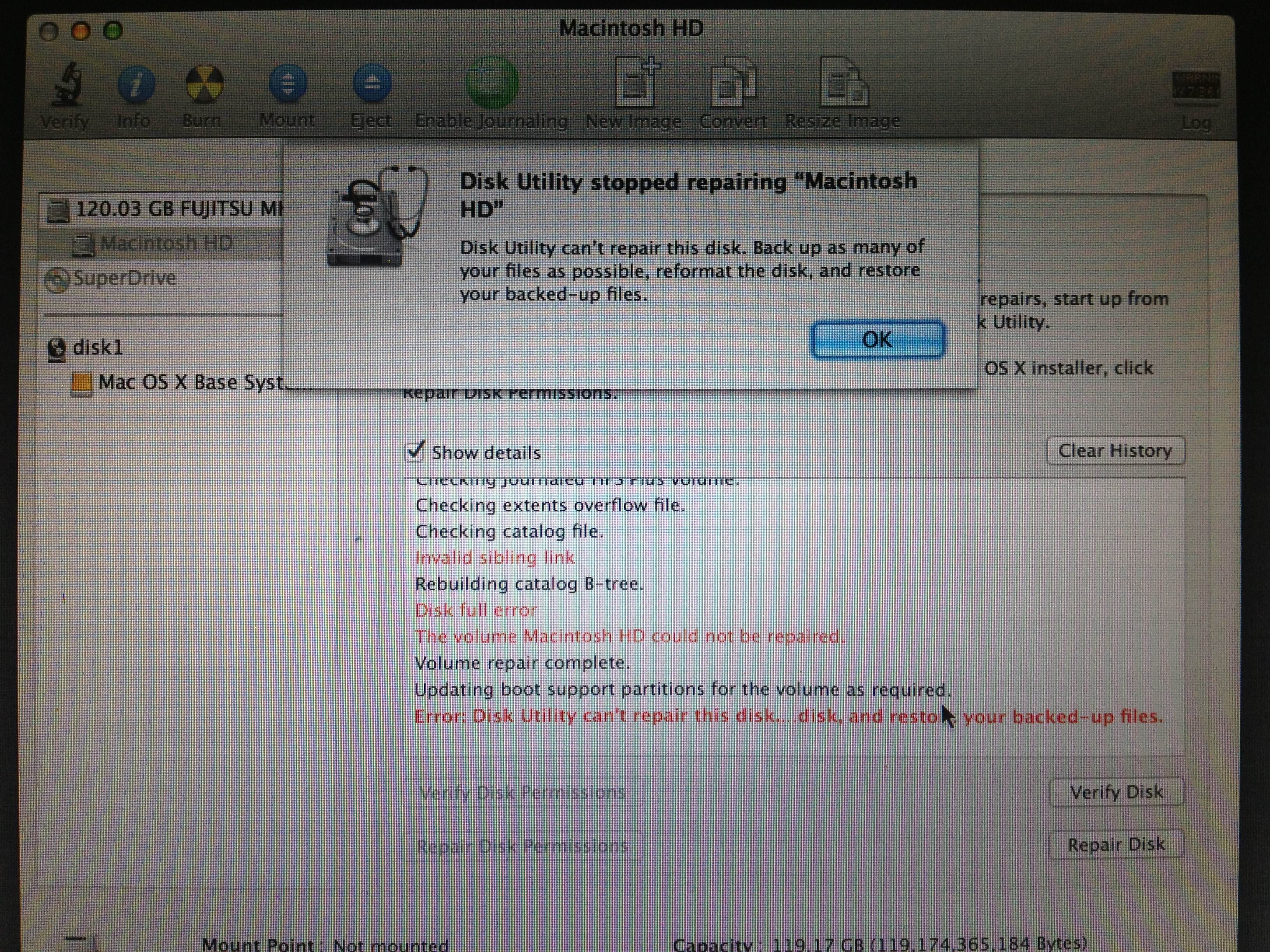

My Macbook Pro had a logic board failure about a month ago, so I had to get it repaired through Powerbookmedic.com
I received it back without any acknowledgement from the website whether it was actually fixed or not; regardless, they charged me $400 for it. When I hit the power button to turn it on, it displayed the usual white screen with the Apple symbol background as usual (And the start-up sound). Then, it would just immediately shut itself off after about 10 seconds instead of taking me to the log-in screen.
I tried both SMC and PRAM resets to no avail. So I tried powering it up with Command, P, R keys pushed in, which took me to the Mac OS X Utilities screen. (On this screen, the Disk Utility option is on the bottom)
Once I got in there it let me choose my hard drive on the menu. It had Verify Disk and Repair Disk options. I started with Verify Disk which resulted in a message saying:
"The volume Macintosh HD was found corrupt and needs to be repaired
Error: This disk needs to be repaired. Click Repair Disk."
When I hit Repair Disk it ran its own diagnosis for a few minutes and this message popped up:
"Error: Disk Utility can't repair this disk..., and restore your backed-up files."
(Photo attached)
So basically the Repair Disk function under the Disk Utility is no good.

The disk may well be damaged. You'll very likely need to buy a new one. If you are within the US, I can give you a site that is well known, respected and offer great deals on HDDs.
