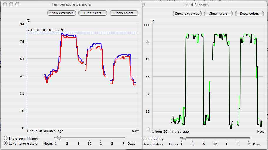

A nice graph to show real temperature changes
To load the cpu I ripped an 11 minute DVD using Handbrake and encoded to H264.
The first temperature plateau is with the fans on default. Temp max 86 degC.
The second plateau is with the fan at 4000 rpm. Temp max 76 degC.
The third plateau is with the fan at 5000 rpm. Temp max 66 degC.
I think I will use this code when I am doing serious cpu loaded work, eg video encoding. otherwise I will leave it on default.
thanks for the code. I look forward to a preferance panel!!
