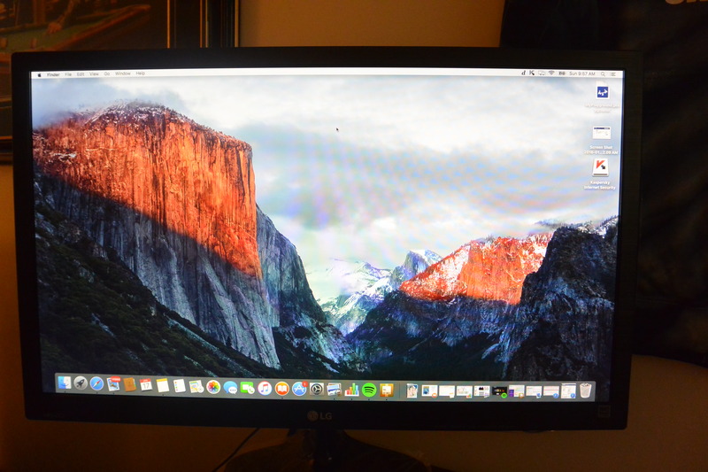

So I just bought this new 27" Monitor but the Text looks very grainy and Color's washed out...I thought everything was going to be nice & sharp
I'm using a old HP Pavilion G6 hooked up via HDMI for testing purposes. This Monitor was bought for my 2010 Macbook pro 15"and I'm waiting on the HDMI to Mini display-port cable.
I'm new to the monitor game and thought LED/IPS 1080P was everything checked off.

Sounds like it has an overly aggressive amount of antiglare coating. There are ways to remove it but it's very difficult (you have to take the monitor apart) and voids your warranty. There are guides available online but it's probably easier to return the monitor and get a different one. Check professional and user reviews to see if a monitor you're looking at has this "feature".

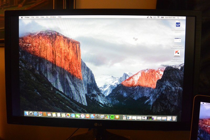

So my old HP was only doing 1366x768 and I bought my adapter and the results are amazing on the Mac now. I do have questions I was hoping you could help with or other members.

Here's my screen shots, I only see 1080P
If I return this monitor and buy a 2460x1440 or higher 2560x1600 would it even work?
Here's the other strange thing, it's not displaying full screen with the lid open but closed everything is fine?
When you have the lid open, and you want the same image on both the internal screen and your external - then you are limited to mirroring, which means you are limited to the resolution of the built-in screen. Both screens show exactly the same image.
You can turn Mirroring OFF, in your Displays pref pane, then adjust the settings for the external to your preferences. It will then be an extension of the your internal screen, adding to its screen space.
When you shut the lid, the external is simply your display, and would work full size, and you also would use an external keyboard/mouse. Your MBPro then works much as a desktop would. That's known as "Clamshell mode" - operating with the lid closed.
If you want that full resolution that your MBPro would be capable of doing (2560 x 1600), then you would need a different external - one that supports that resolution. Your LG display does not support more than 1920 x 1080
If you do trade out to a higher resolution display, your MBPro will support that, with the correct adapter (the one you have now may be OK with a better display)
Keep in mind that going to that higher resolution also means that menus and other on-screen text will shrink according to the higher resolution (text will be smaller).
