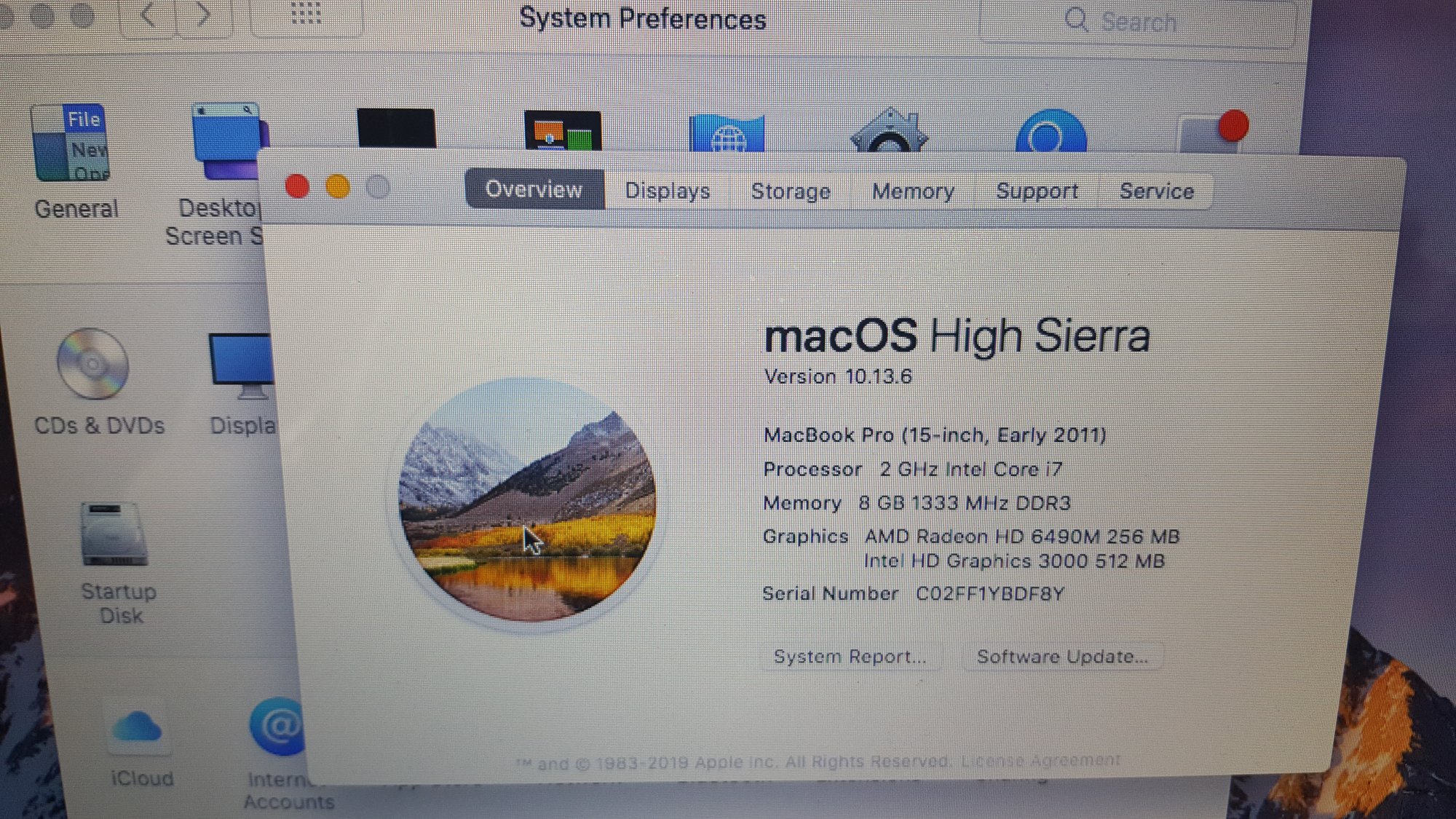

Stupidly I put the os of my music Mac. This one is High Sierra.

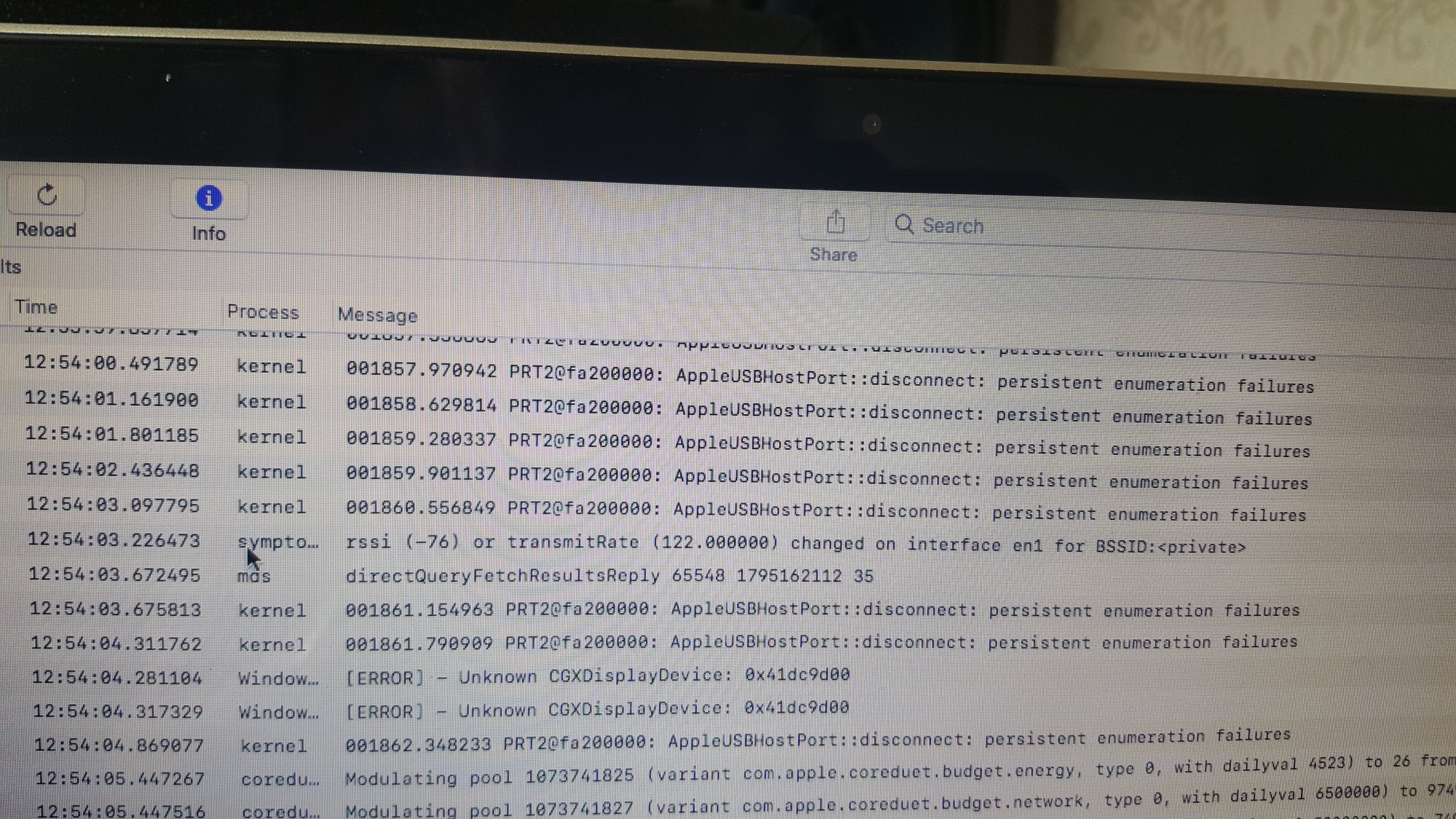

Are there error logs I can view.
So I found the error logs. Yes I am a novice. Nonstop errors below....
AppleUSBHostPort::disconnect: persistent enumeration failures
Nothing plugged in usb ports. See attached - thanks in advance for any help:

It's a 15 inch. I think it's graphics related, getting lots of glitches. But of course could be the mother board. Not sure about it being hard drive related and using a 2011 machine by necessity not by choice(no money).
I'm exploring the issue of switching off the GPU completely and just using the Intel.
