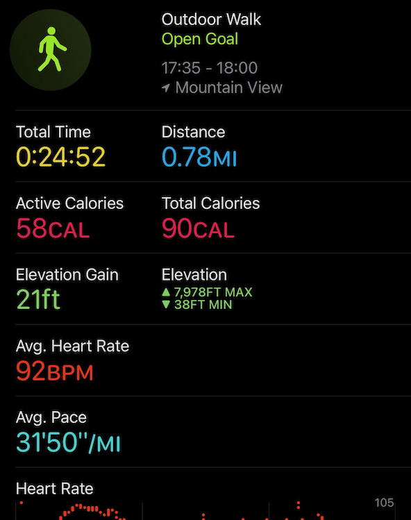

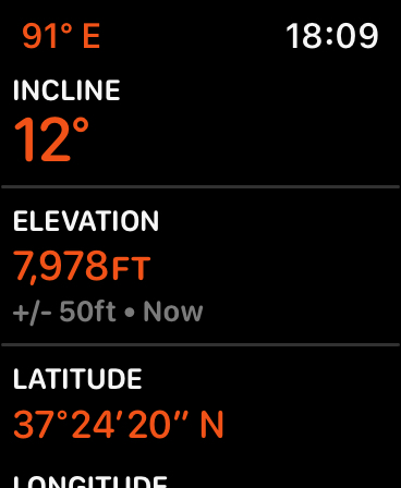

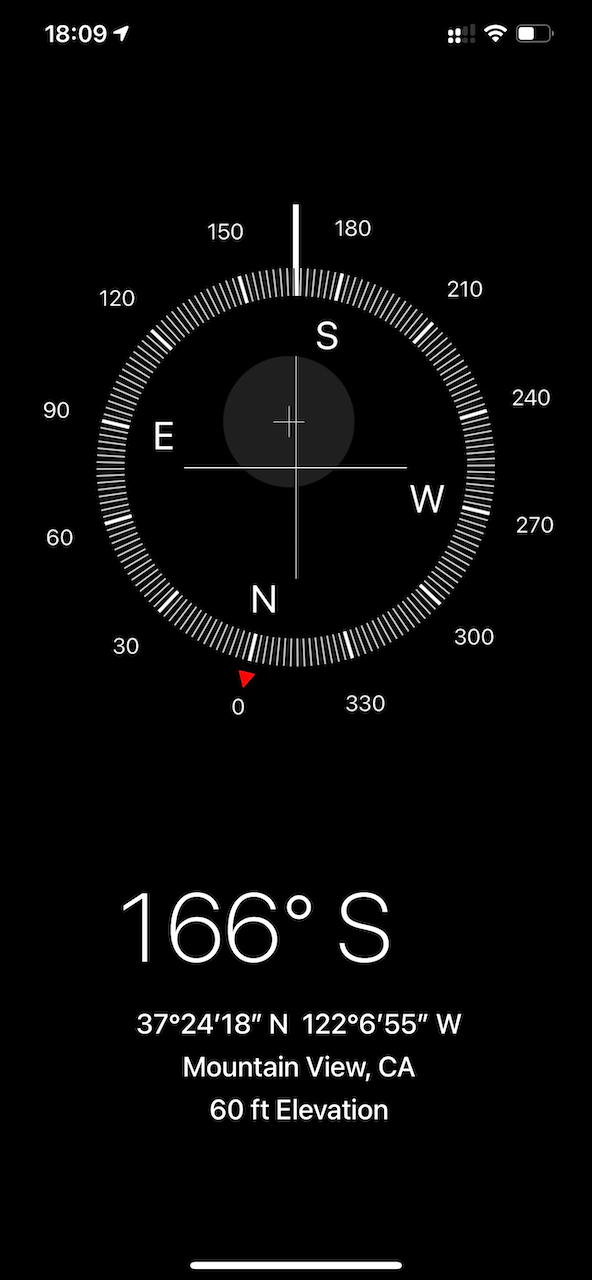

So I have spent the past month going back and forth with Apple trying to solve this weird issue on my Apple Watch Series 6 cellular model, which started happening since I moved from NYC to the Bay Area:
As the screenshots show, my watch puts me about 8000 ft higher than what my phone tells me. I tried resetting the watch, which would initially fix it. However it does go back to reporting the wrong elevation after I do an outdoor workout. Relative elevation gain is correct, but the absolute value goes absolutely crazy. This is what happens when I do the first outdoor workout after resetting the watch:
