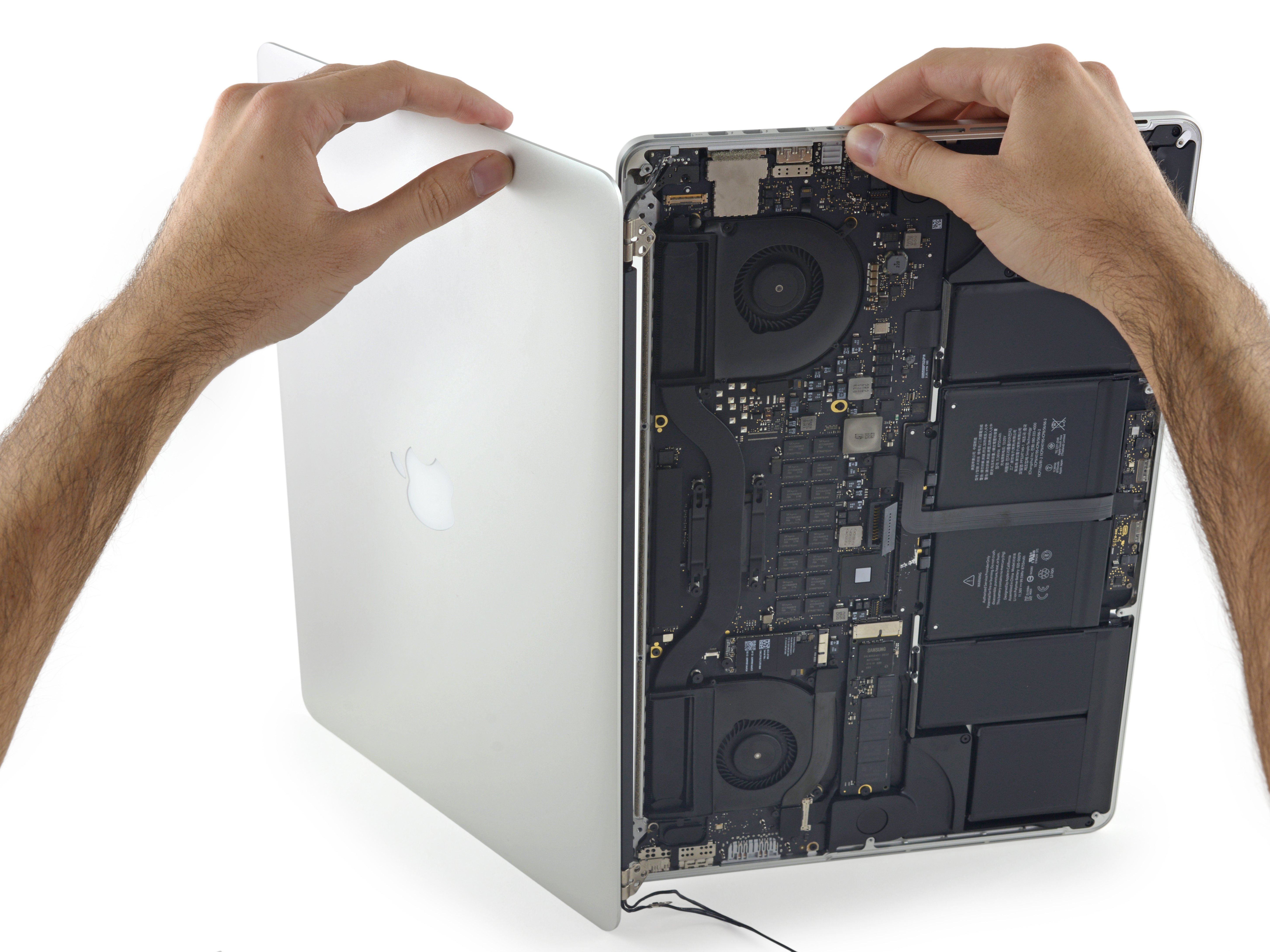

Looks badly bent, but if the screen occasionally works fine, then I would first suspect a dislodged cable. You need a P5 Pentalobe screwdriver to remove the casing and once removed check all the connections to the monitor. An iFixit guide will explain which cable does what.
(By the way - no need to disconnect the battery - just don't prod randomly around with anything metallic :) )
As I posted above ...
The case components are so badly damaged that "repair" is all-but impossible -- only solution would be to replace them.
Motherboard may be damaged, as well -- if the blow was strong enough to bend the chassis like that, it was certainly strong enough to damage the motherboard.

As the others have stated, testing it with an external monitor is a good start. As other others have stated, taking the bottom off and taking a peek, is a good idea, too, especially in the context of iFixit repairing the screen cable or entire screen.
In response to concerns that it is irretrievably damaged because the chassis is bent, I've had an old unibody 15 mbp crash through a glass table top and bounce off a patio concrete floor. It was bent much like in the picture (ethernet port was mangled)...that thing continued to work fine for several months (screen wasn't even cracked).
