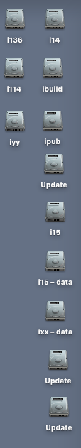

I'm not 100% certain this is M1 Mac related or even Big Sur related, but I can't find anything online to corroborate this. But for the past several weeks, a mysterious volume keeps popping up on my Desktop called "Update." The contents of which are:

Hi
I think its a readonly copy of a Catalina or BigSur Update, Just leave it, I got 3 "Update" and some "xx-data"
This iMac has 10.11 - 11.1 installed and bootable 🙂
Just dont delete them "Update" and "?-data" you probably have to reinstall the os 🙁
I just let them be ... think it's an bug in the APFS that causes this...
/A
