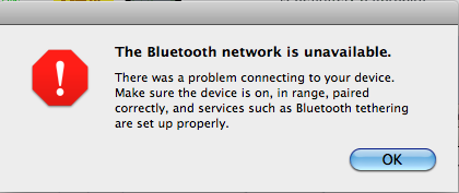

OK, I have a 13" MacBook Air (2010) and the latest version of MyWi (4.5.1) on my iPhone 4 (4.2.1/greenpois0n jailbreak).
I was able to complete the initial pair with my iPhone 4 and my MacBook Air, but whenever I then try to initiate the connection from my MacBook Air to my iPhone 4 after that, my laptop says says "The Bluetooth network is unavailable".
No matter what I do, after the initial pairing I can't connect at all. And of course, Bluetooth tethering is toggled on in MyWi. I even tried going to the Advanced Bluetooth settings in MyWi to change the Bluetooth Bridge DHCP Network to no avail.
USB and Wi-Fi tethering work just fine.
Any ideas?

I have exactly the same problem. When I try to connect via Bluetooth, I do get the tether bar come up for half a sec and then it goes away again. Also get the "network not available" error on my mac. The Bluetooth activation button in MyWi is not very responsive either, it sometimes just hangs when I try to turn it off.

I have the cracked app... i am assuming that i will use my Mac's bluetooth connection wizard, i pair it up everything seems fine then when i try and connect, it doesnt work
That's the exact same message that I get... but I'm not using the cracked app. $20 is a small price to pay for the functionality provided.
