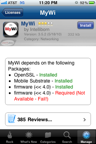

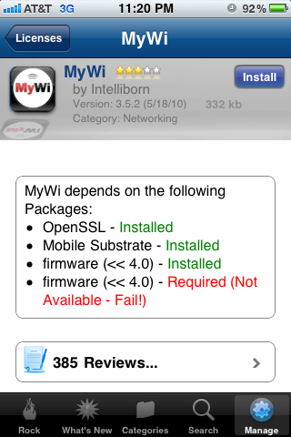

It does not let you install the ver 3 of mywi if you are on ios4. I have jailbreak the new iphone 3GS 8GB and have the same problem. Works with usb but not on wifi. I think the app needs to be updated
you're so wrong.

Thats what says when I try to install the old version of mywi on rock
