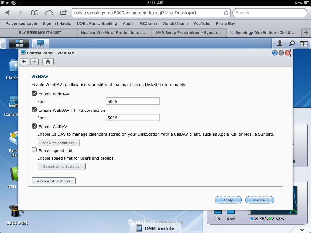

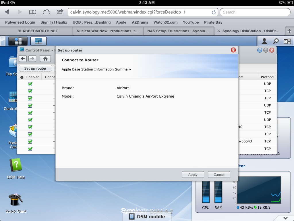

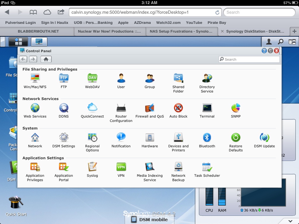

I had my DS213 for about a little over 2 months now, and it was indeed a little confusing at first. But after you have got around to it, everything now seems to make sense.
If my understanding is correct for Remote Access, you would need to set up your Router Configuration, WebDAV and DDNS.
Router Configuration:

Everything looks ok.
1. Why do you have so many ports forwarded? For remote, you only need 5001 (DSM) and 5006 (WebDAV). Maybe 80 if you have a web server.
2. Don't use port 5000 to access DSM via internet!!
