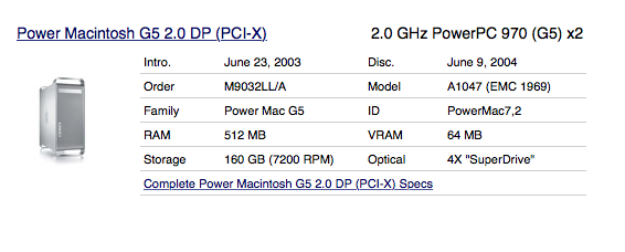

Checked every identifier and this G5 is definitely the correct one. It is 7,2 1st gen G5, M9032LL/A, (dual 2.0 GHz) (see above attached
