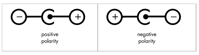

A big issues is going to be the plug itself. There's a whole slew of shapes and sizes. The wrong one and it won't work. Another issue is going to be polarity. You want to make sure you've got positive going to positive and negative to negative. There should be symbols on the manufacturers label. Which indicate the polarity of the connectors.
