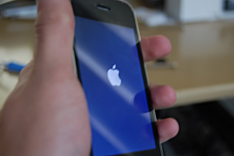

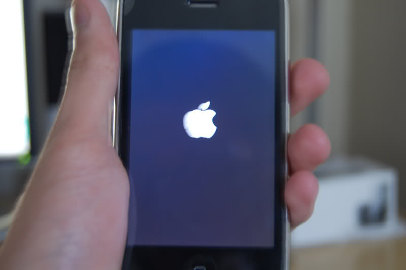

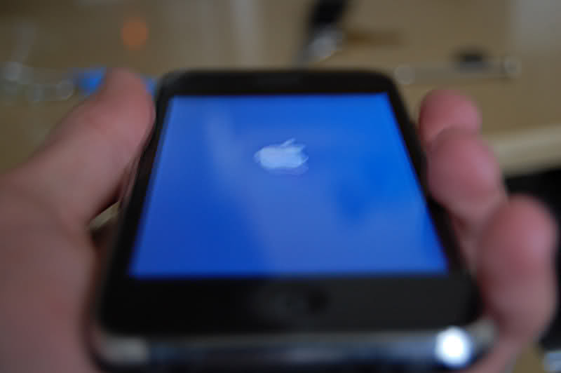

here's the grey washed-out apple oem replacement screen (matt screen protector applied, but this does not change the contrast).

Both of those examples don't seem washed out to me
It looks more like its an issue with the backlight/viewing angles
In other words
It's not that the contrast is low
is that at wide viewing angles you are getting backlight leakage ( either a problem or inherent in the LCD panel technology) that is causing black levels to appear brighter = making the contrast lower.
The best example i can give you is the difference between TN panels and S-IPS panels
OP what I would do is try to find another 3gs phone ( friends or in an apple store) and compare it to your phone.. IF it is your phone, You can use my guide to try to replace the LCD on your own ( its a pretty easy procedure)
