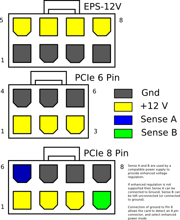

^^^^As we all know the GTX780 has either one six and one eight pin connector or two eight pin connectors.😱
I received my Gigabyte GTX780 yesterday, and rushed it off to MacVidCards. But before I sent it off, I noticed that only six pins on each of the eight pin connector are live. The PC connectors that come with the card, again only have six cables coming out of each connector, and only 3 pins are in each of the four molex connectors. I don't know what this means, but I have asked MacVidCards for an answer. I'm intrigued😕
Lou
Judging by the image I included, the pins we should be concerned with are 1, 2, and 3.
According to the findings of ActionableMango and Varmann, there didn't seem to be any scientific way to determine where the video cards would draw power from and how much of it they will draw. Therefore, even if the video card is underclocked to pull a maximum of 220W, there's no guarantee that it won't attempt to pull 150W of the 220W through the 8-pin connector.
Of course, the video cards should only pull their max TDP when stressed to the limit. I also do not know how much tolerance the traces on the Mac Pro logic boards provides. I just know that they were intended to provide 75W per 6-pin connector. That being said, after having lived a lifetime of ill fated luck, I try my best not to test fate whenever possible.

^^^^The connectors that came with my card are configured like the attached image.
Lou
I think the important thing to keep in mind is that the 8-pin connectors are specced to provide up to 150W, twice what the 6-pin connectors are specced to provide and is what we have in our Mac Pros.
There are apparently a fair number of people who use video cards with one 6-pin and one 8-pin connector and we haven't seen any reports of blown logic boards, so we could just be scaring ourselves. But, personally, I would definitely install one of those auxiliary power supplies that fit in optical bays if I were to move to a video card with an 8-pin connector. I can't justify risking my Mac Pro for a few extra frames per second in a game.
