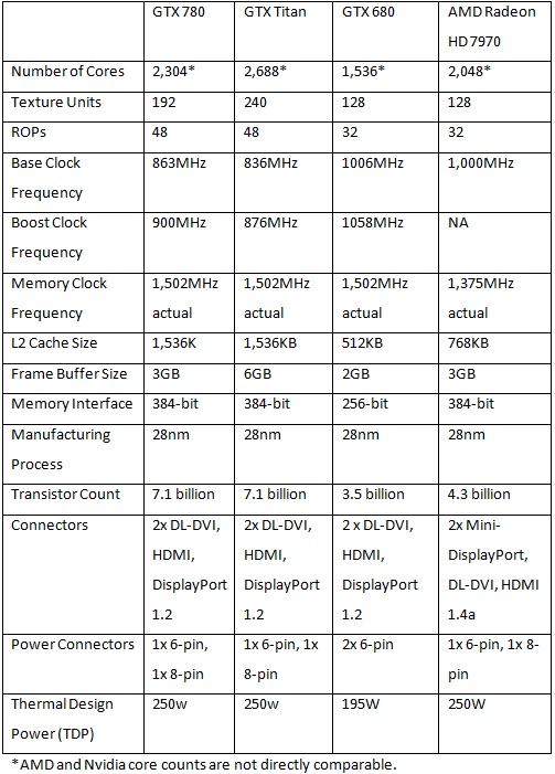

The following chart was taken from www.maximumpc.com. It shows that the GTX 780 TDP is 250W which is the same as the Titan's TDP. Therefore, if a Titan requires an auxiliary power supply, why shouldn't the GTX 780?

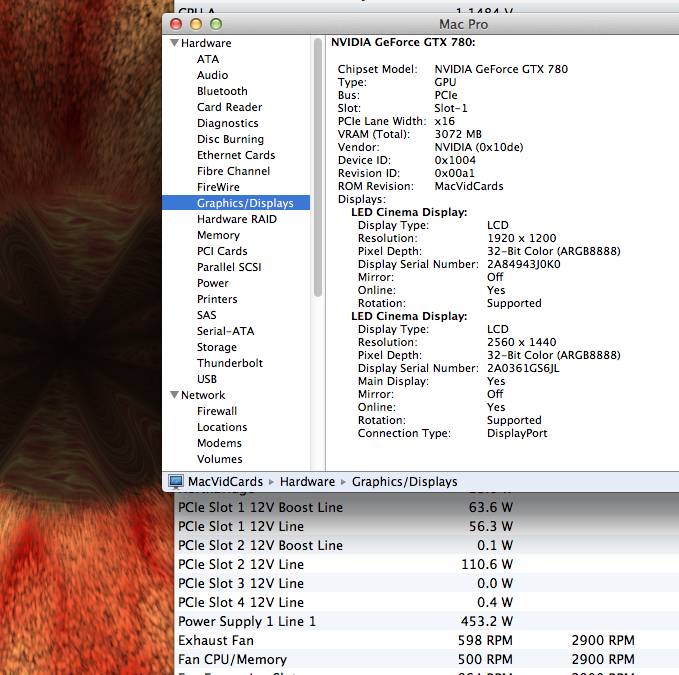

^^^^Because of this post and the testing behind it:
I realized that "Hardware Monitor" offered the ability to read power draw from PCIE slots and the Booster cables. Unfortunately, you need to get the paid version to do this, but for $10...why not?
My testing of GTX780 EFI cards has found them stable in MP using existing power while running Titan on existing power can do a violent shut down if you try to run "FurMark"
I wanted to put some numbers on this and this software offered a chance to find out some actual answers.
It seems that 3,1 MP reports higher current draw then 4,1/5,1, but I will start with the 3,1 numbers. You may wish to send your children from the room, these numbers are alarming.
I am going to start the thread with a comparison of GTX780 with GTX570 2.5GB. The GTX570 is a well loved card that many use in their MP. I do not know of ANYONE reporting power issues with them, whether EFI flashed or running using the self0 initing drivers. I ran a bunch of recent Nvidia cards through the After Effects benchmark on this board and found that the GTX570 is equal to the new GTX680 for that test.
I also decided to use that render as one of my test points for power draw.
GTX570 AE render 161 Watts
GTX570 Furmark 250 Watts
GTX780 AE render 169 Watts
GTX780 Furmark 230 Watts
Forget the totals for a minute. The fact that the sum of draws (230W) is close to the sum of sources (225W) does not mean it is safe.
That post you linked to actually identifies the problem. Look at the last picture:
attachment.php
The Mac Pro provides:
PCIe Slot: 75W
6-pin connector: 75W
The last screen shot from that post shows:
63.6W
56.3W
110.6W
The first two are fine. The third, presumably the 8-pin connector on the video card, is over spec by a whopping 47%. Someone please correct me if I'm wrong, but to me it looks like an awful lot is being asked of that third source.

This post lists total power draw. It does not describe where the cards are pulling the power from. It also says running this Furmark benchmark causes Mac Pro 3,1s to shut down.
My interpretation of this post is that, at least in Mac Pro 3,1s, the GTX 780 is running along the edge of the cliff of acceptability.

The GTX570 (Furmark) caused the 3,1 to shut, the GTX780 completed the test with no shutdown. That's the way I read it.
My previous 3,1 with a GTX570 never shut down on me. It worked just great under load.
Lou
Only the Titan was able to drop the 3,1.
Barefeats couldn't get Titan to kill 5,1, even with Furmark.
The point I was really trying to make is that the card we have all been calling "safe", the GTX570, is capable of drawing just as much current as GTX780. I have yet to hear of a single instance of a 570 doing damage to a MP, so, ipso, ergo, other legal sounding word, the GTX780 is safe.
The only person to positively damage a MP via a GPU was the guy in Germany who used a GTX580 3 GB Windforce Edition. This card runs higher clocks than standard GTX580. He then not only over clocked it but OVERVOLTED it. AFter hours of playing games like this, his MP was never right again.
How he was able to do this damage without machine shutting off I do not know.
But now that I have seen the actual numbers and can see that a 570 can draw similar current running Furmark, I have deemed 780 safe. Titan is just over the edge. Running a line down from optical bay may help load balance a little more, but I don't think we know how much current those lines can deliver. The spec for the Molex connector is even higher than the 6 pin.

The 110.6W is my primary concern.
