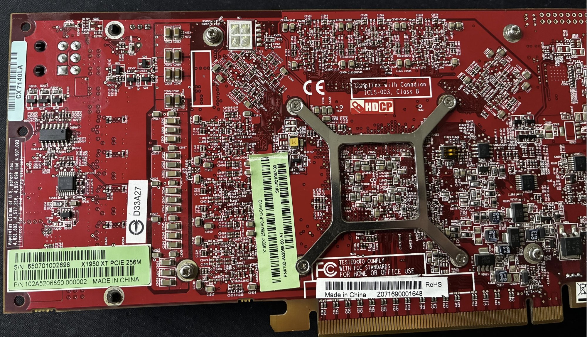

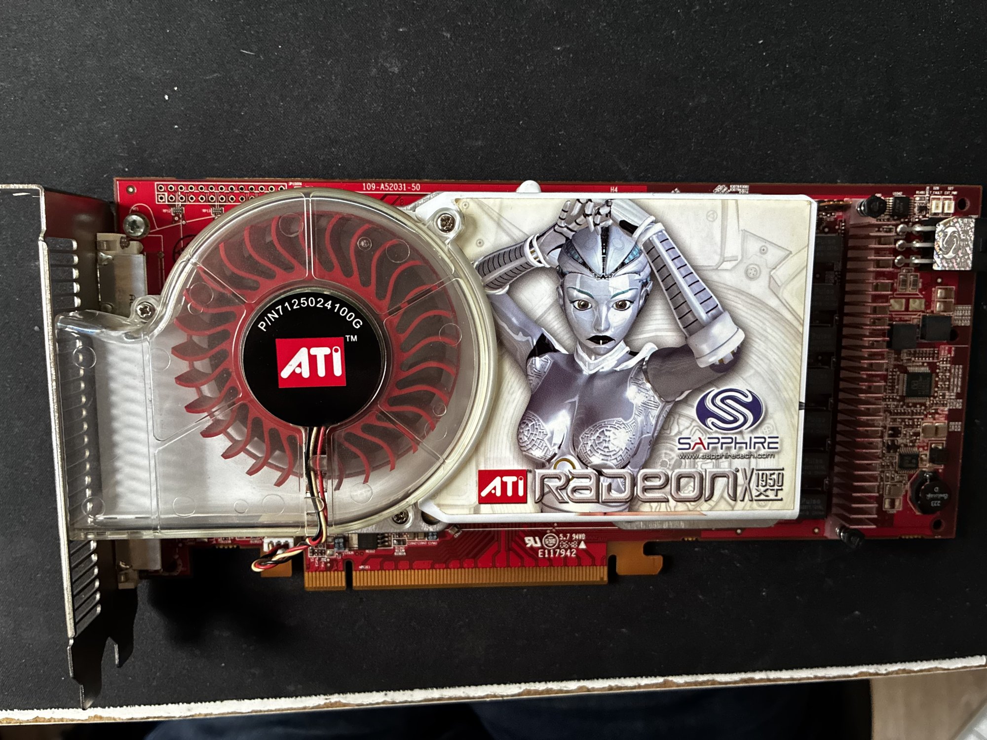

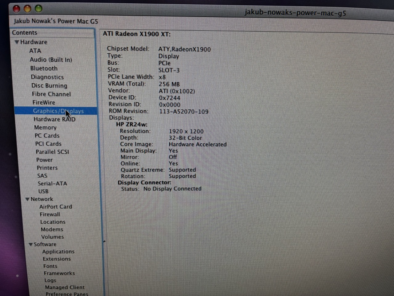

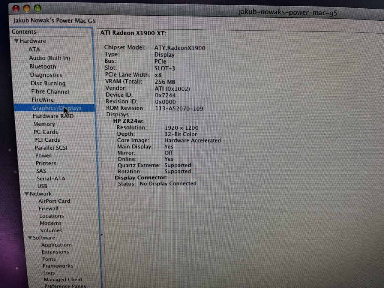

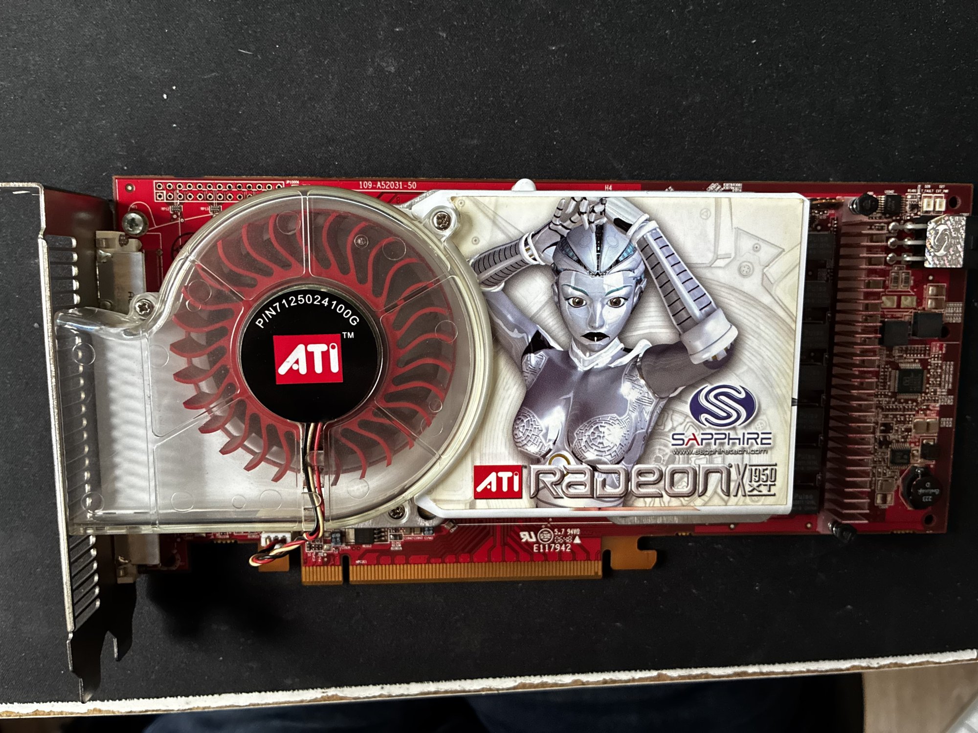

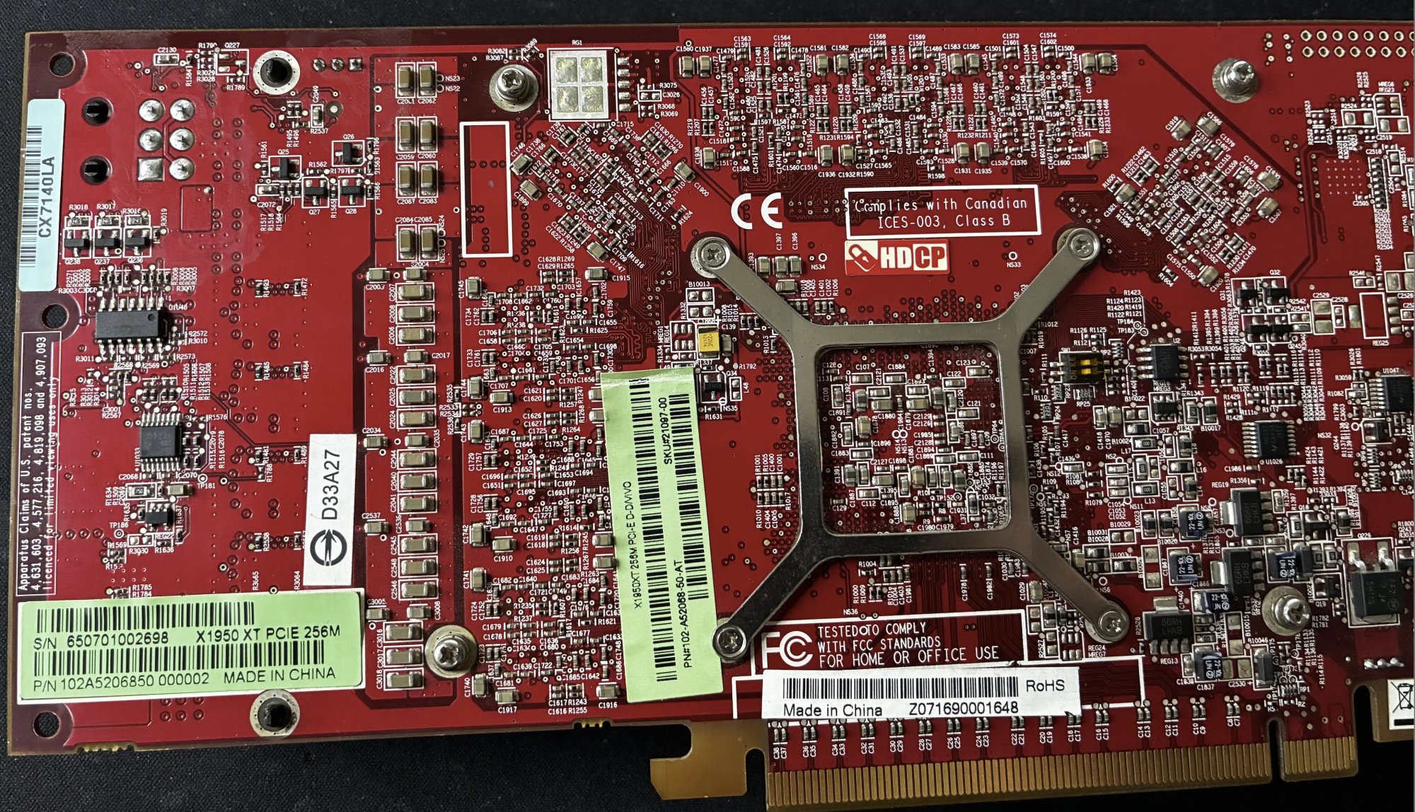

So, here I am, flashing sapphire x1950xt 256MB for my quad.
I run freedos, successfully flashed it with this one, on first shot: https://forums.macrumors.com/threads/need-help-flashing-a-radeon-x1950-xt.2192094/post-30671833
The problem is the card doesnt wake up on first pcie slot in my quad - no chime 🙁. When I try second slot it works, boots up. I think I must be doing something wrong. Second slot is not satisfactory 🙁
Can you help me?
PS: There's one more detail. For now I'm running the card from external ATX PSU as I'm still waiting for the adapter. It works no problem on second slot though.
PS2: Geforce 6600LE works on first slot
PS3: I heavily tested before the card in windows 7 3dmark 03 05 06 - works fine
PS4 I flashed on optiplex 9020 i7 4790, gpu - Intel® HD Graphics 4600. Don't have any pci card.
