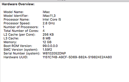

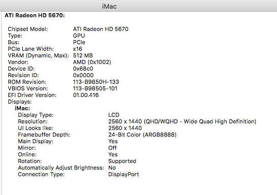

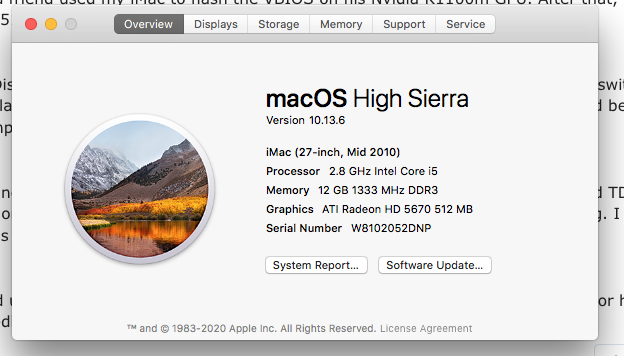

I'm using MacOS High Sierra 10.13.6 which still supports TDM, and below are my display specs
What version of macOS installed in iMac?
Please post screenshot or copy output of System Information > Displays.
Hey Bigwaff, I have updated my post to provide the information that you required. Can you please help me check it?

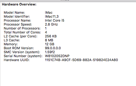

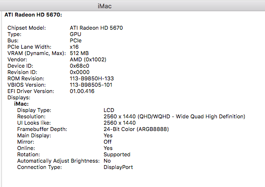

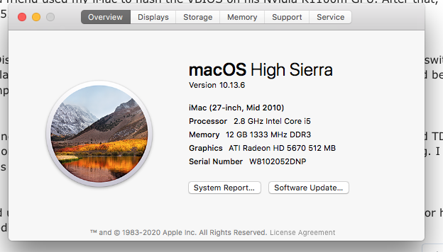

View attachment 2500595View attachment 2500596
Your iMac looks fine for TDM.
How about trying PRAM reset?
