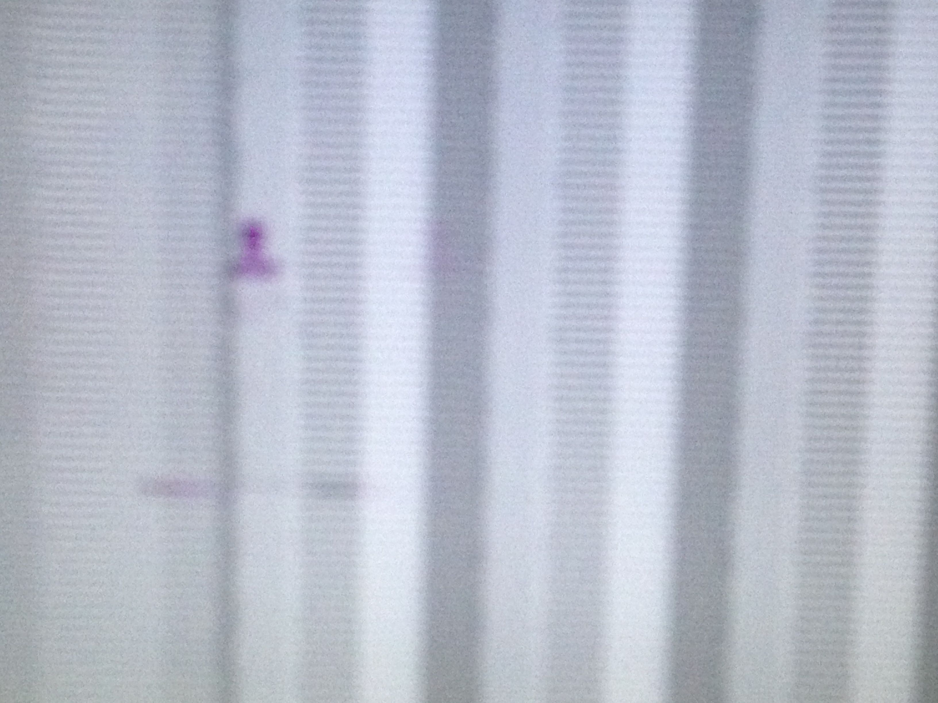

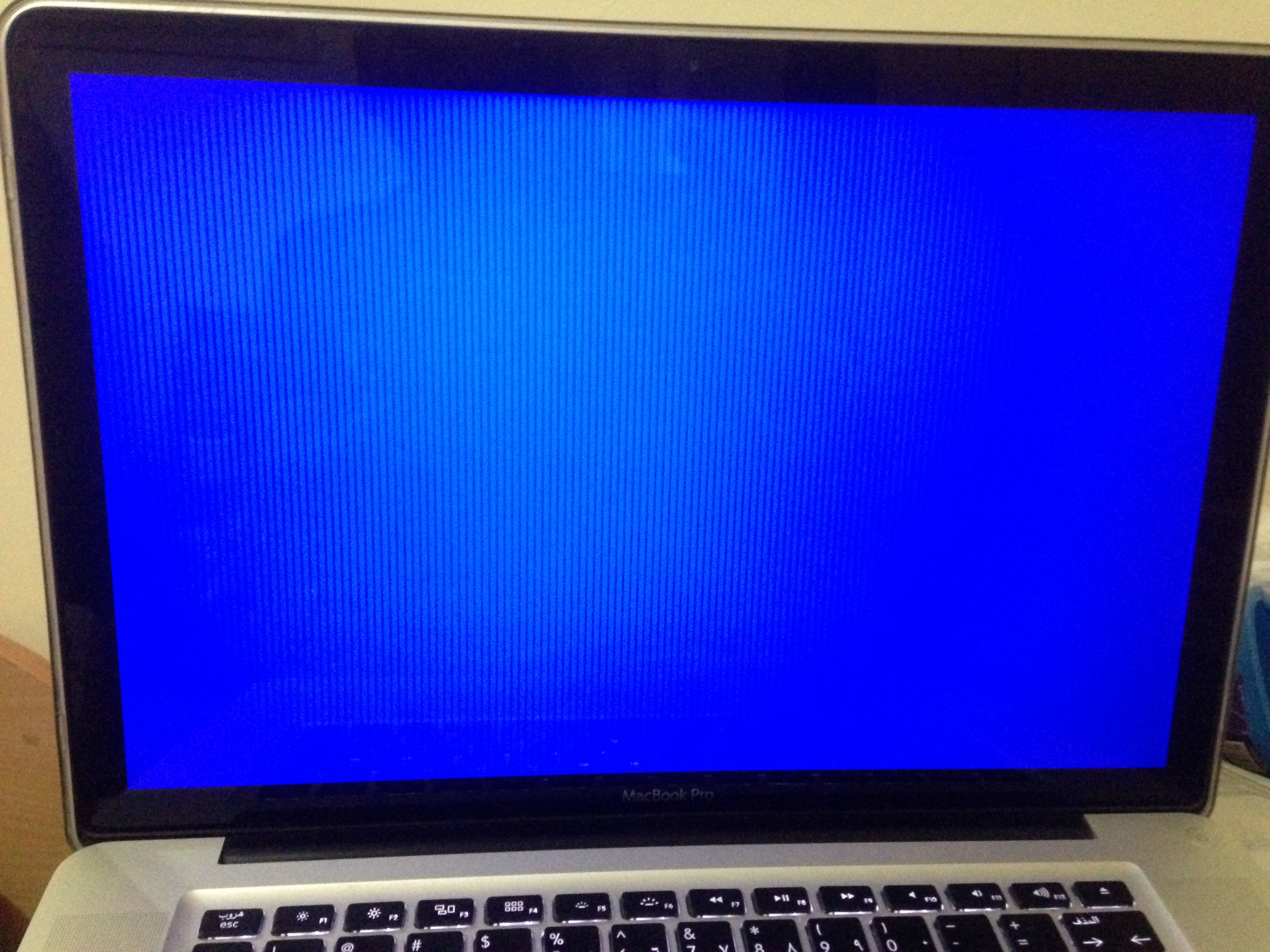

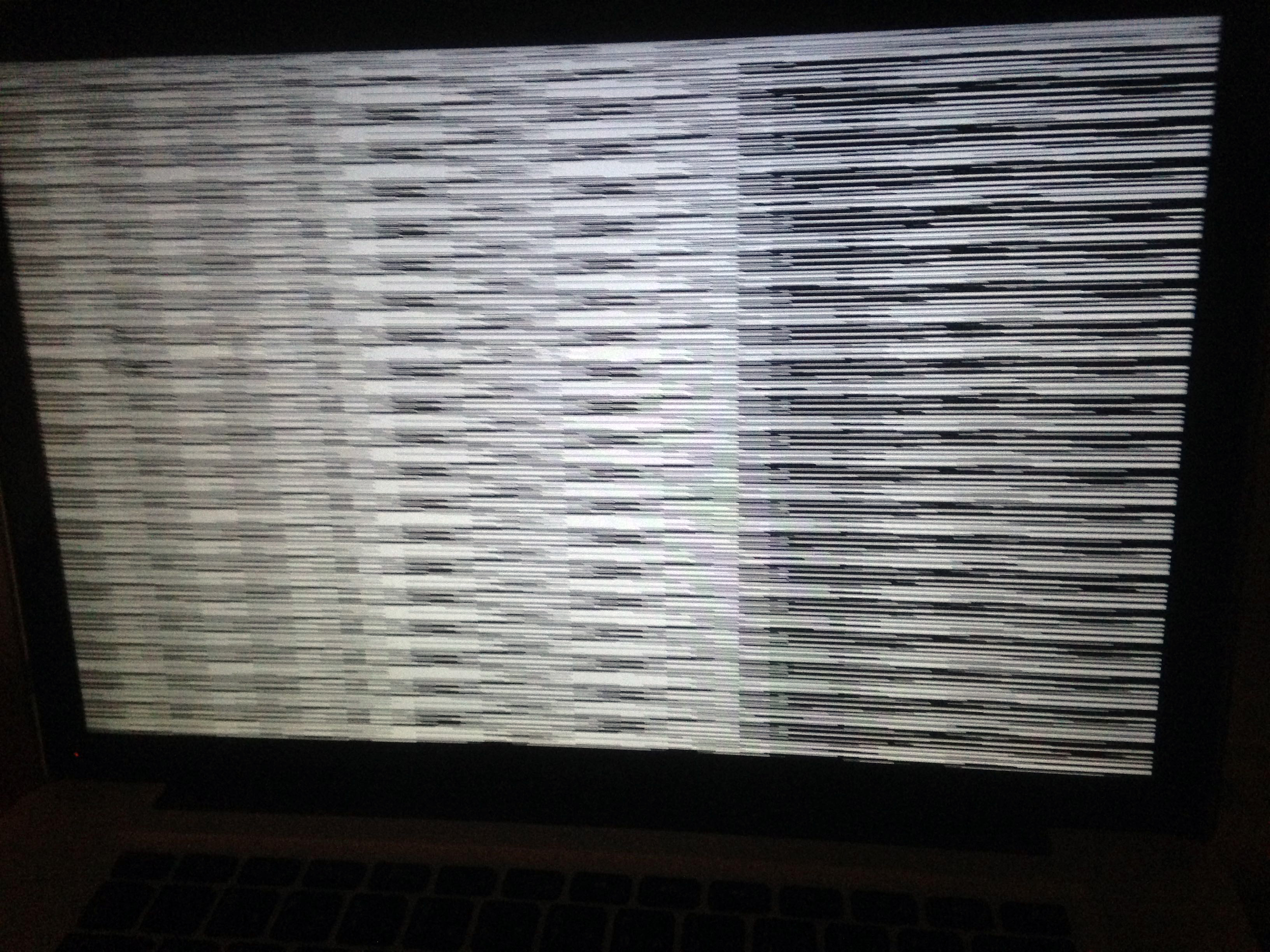

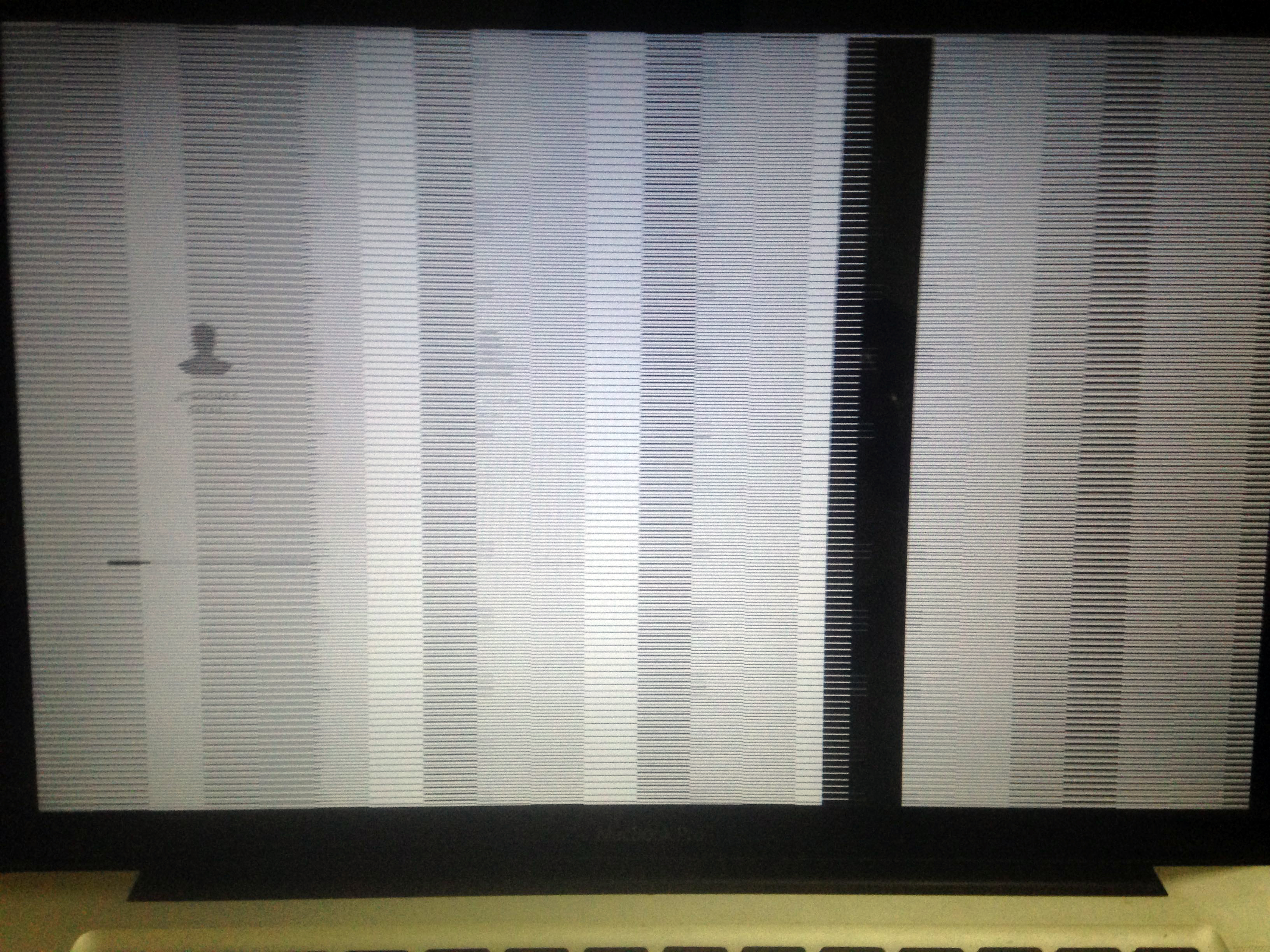

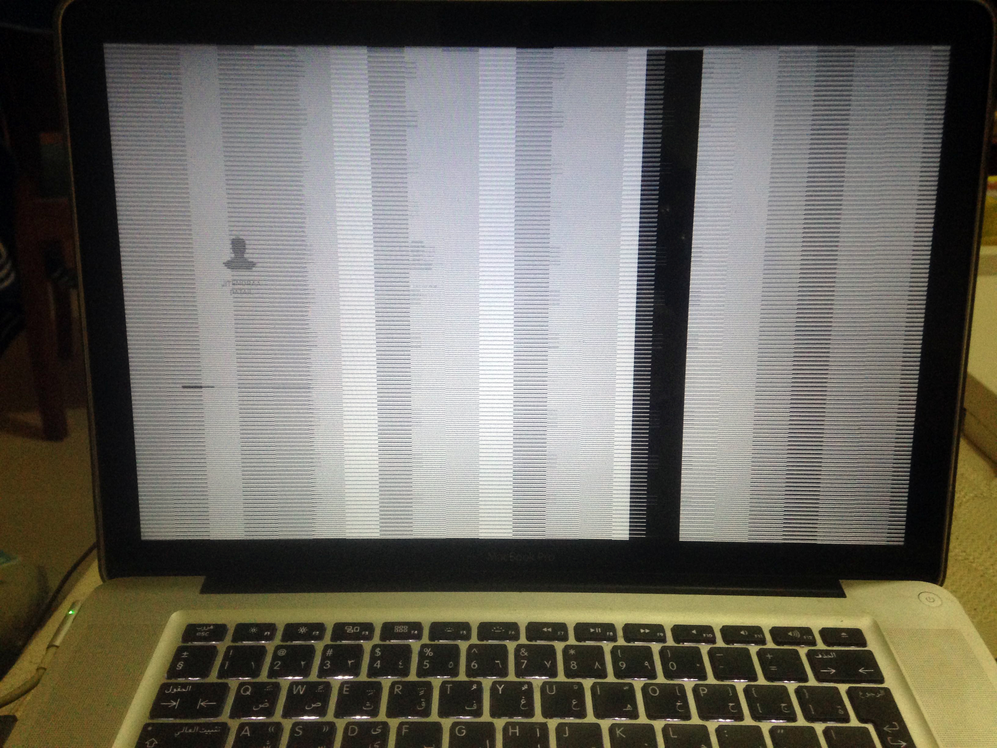

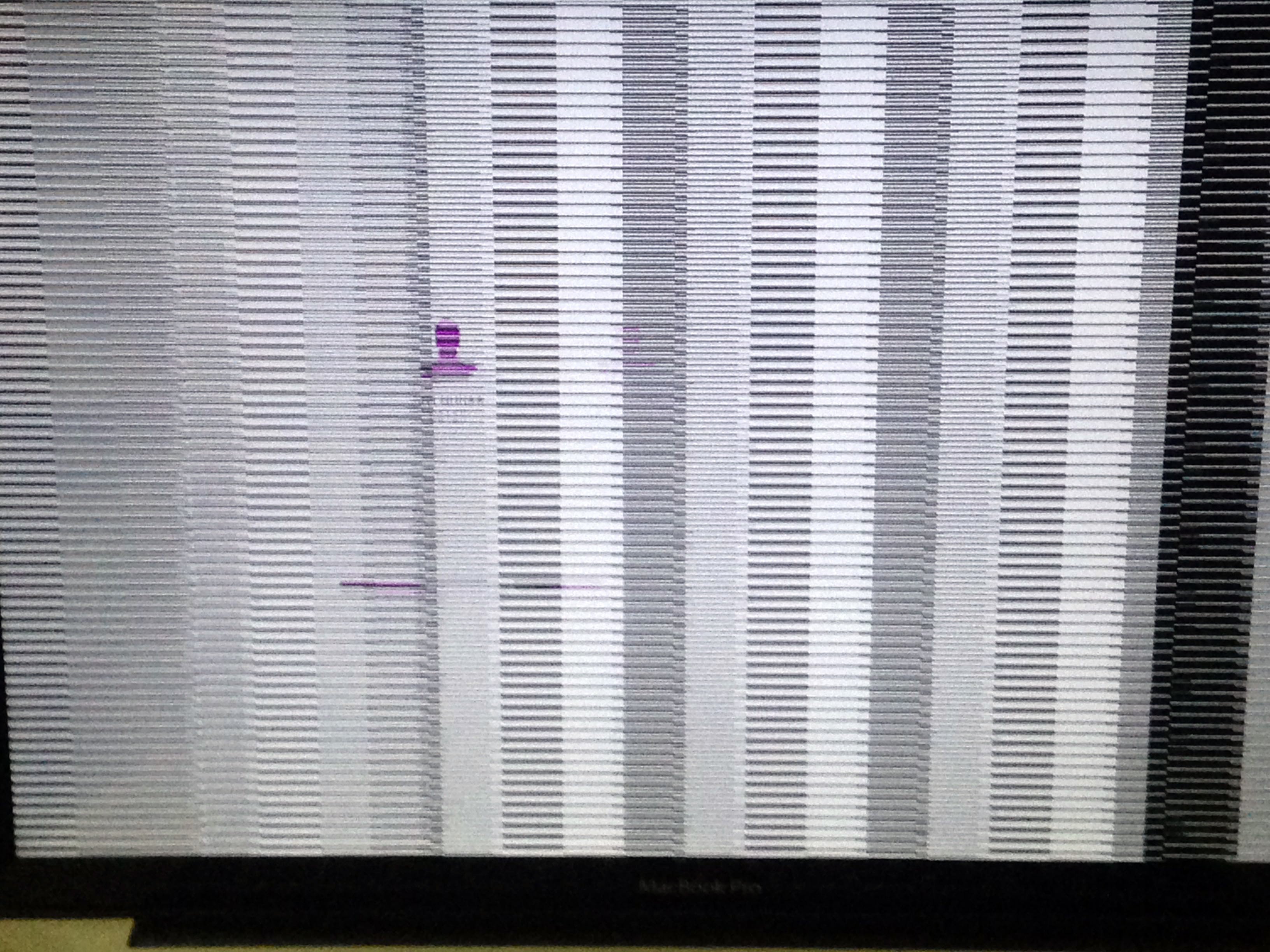

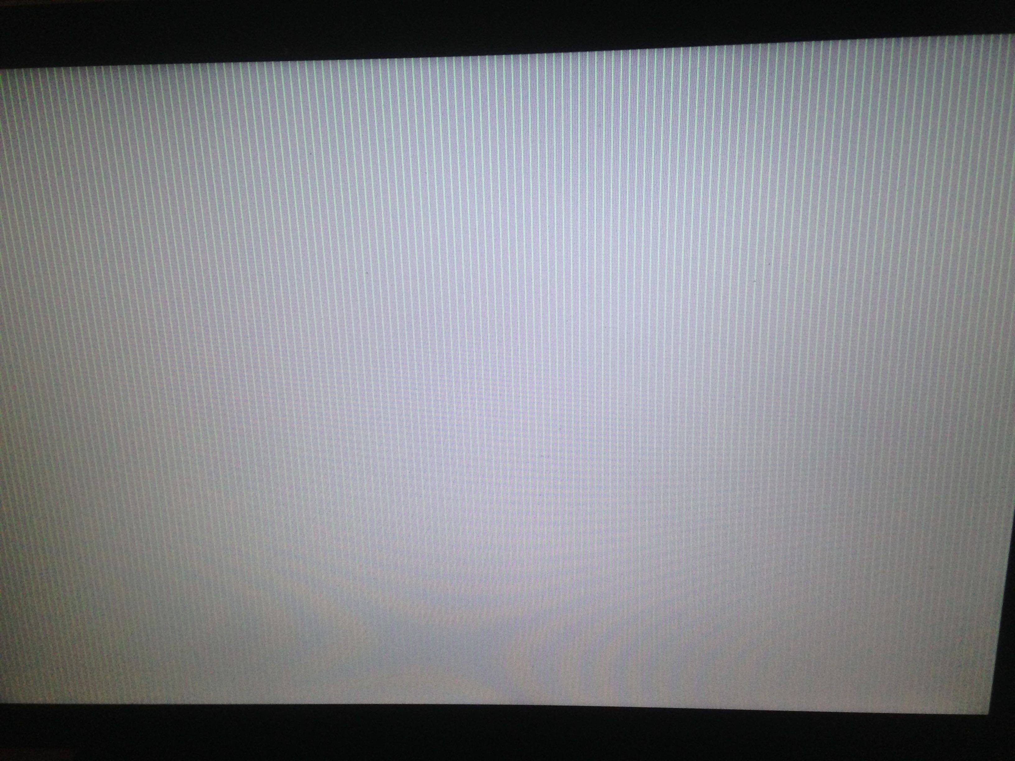

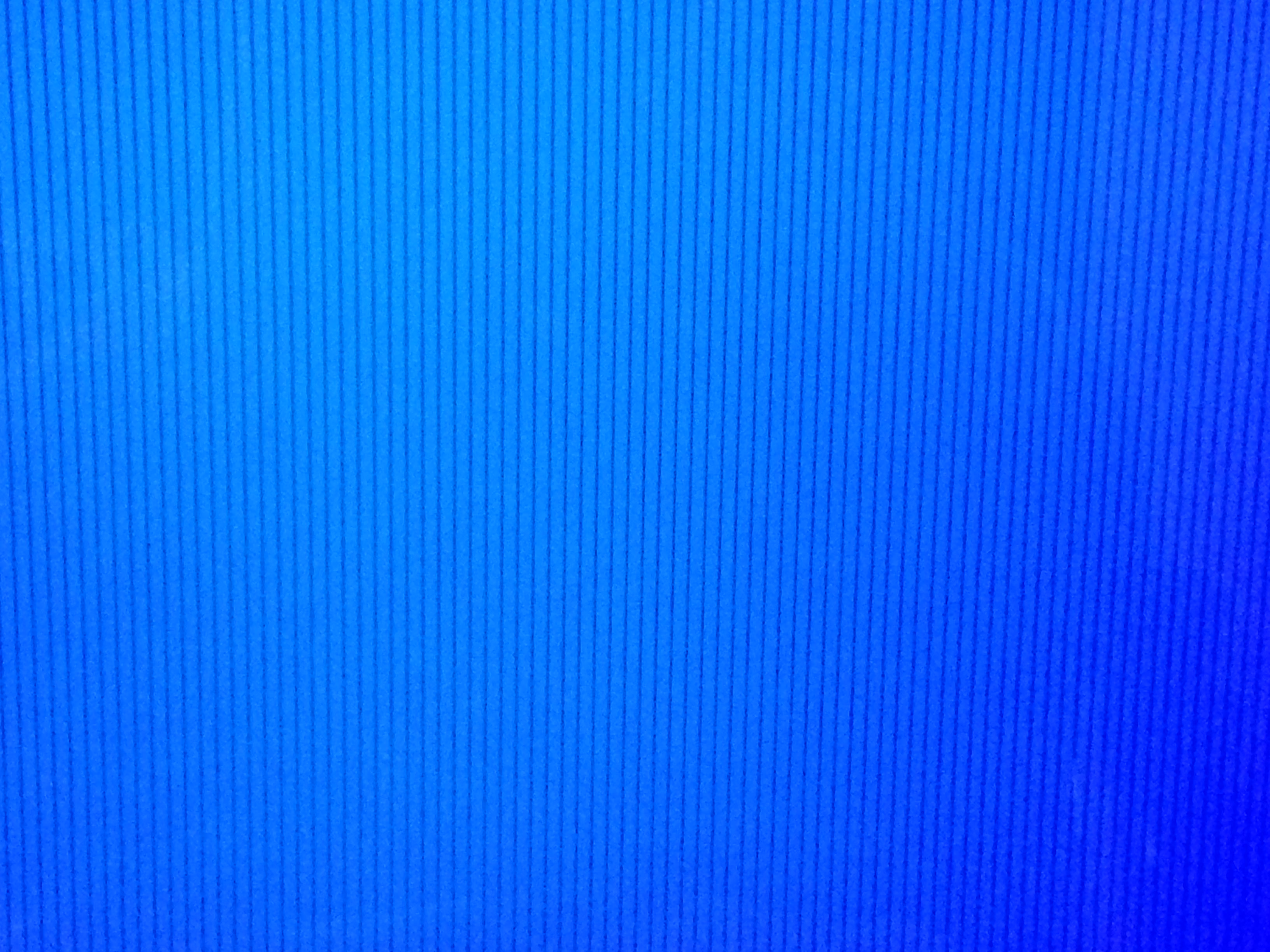

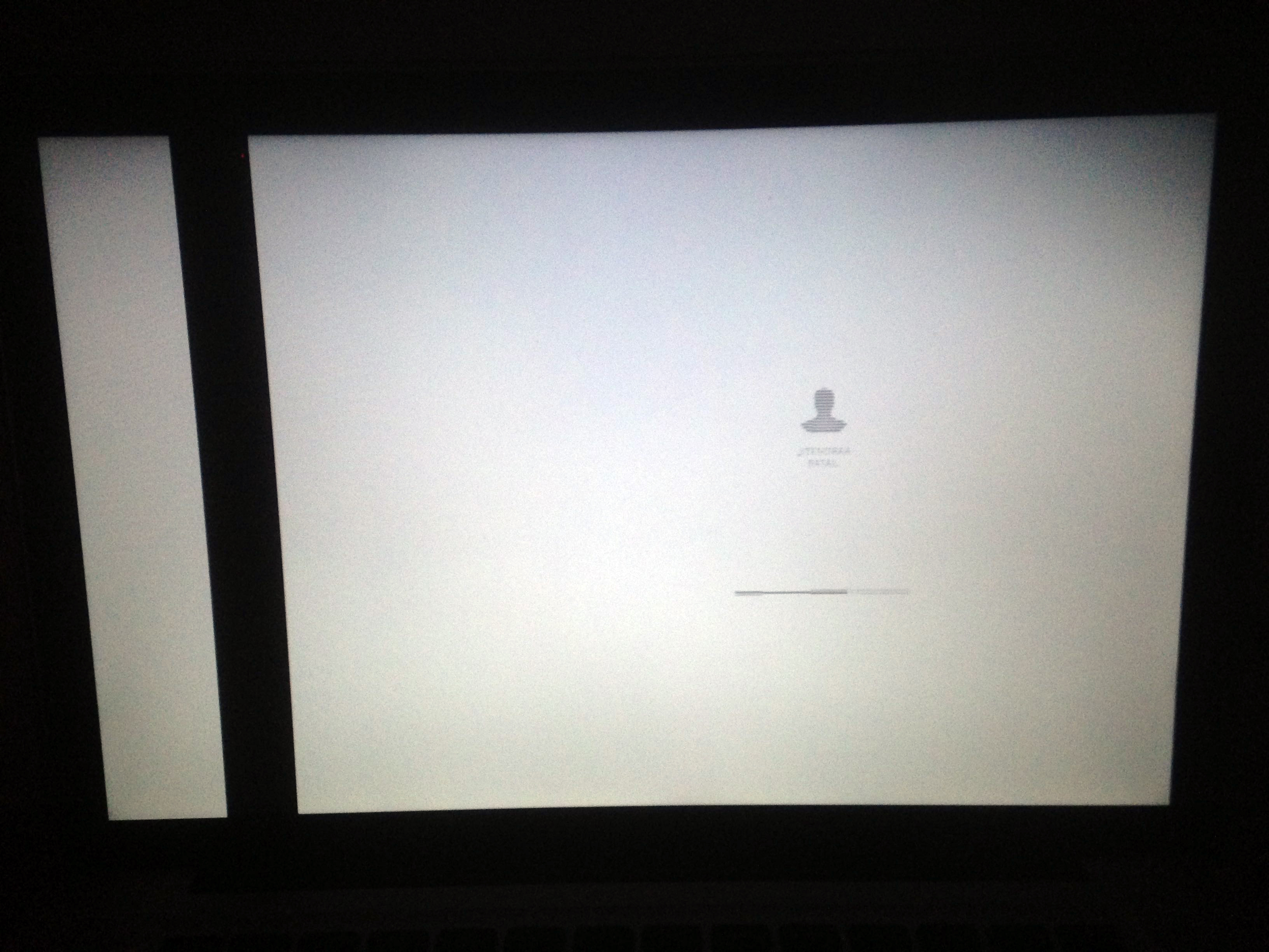

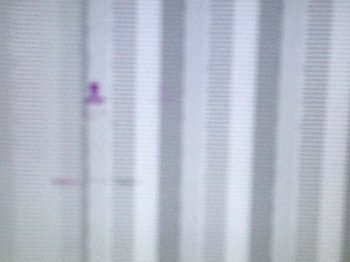

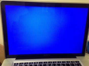

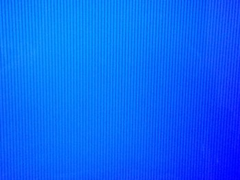

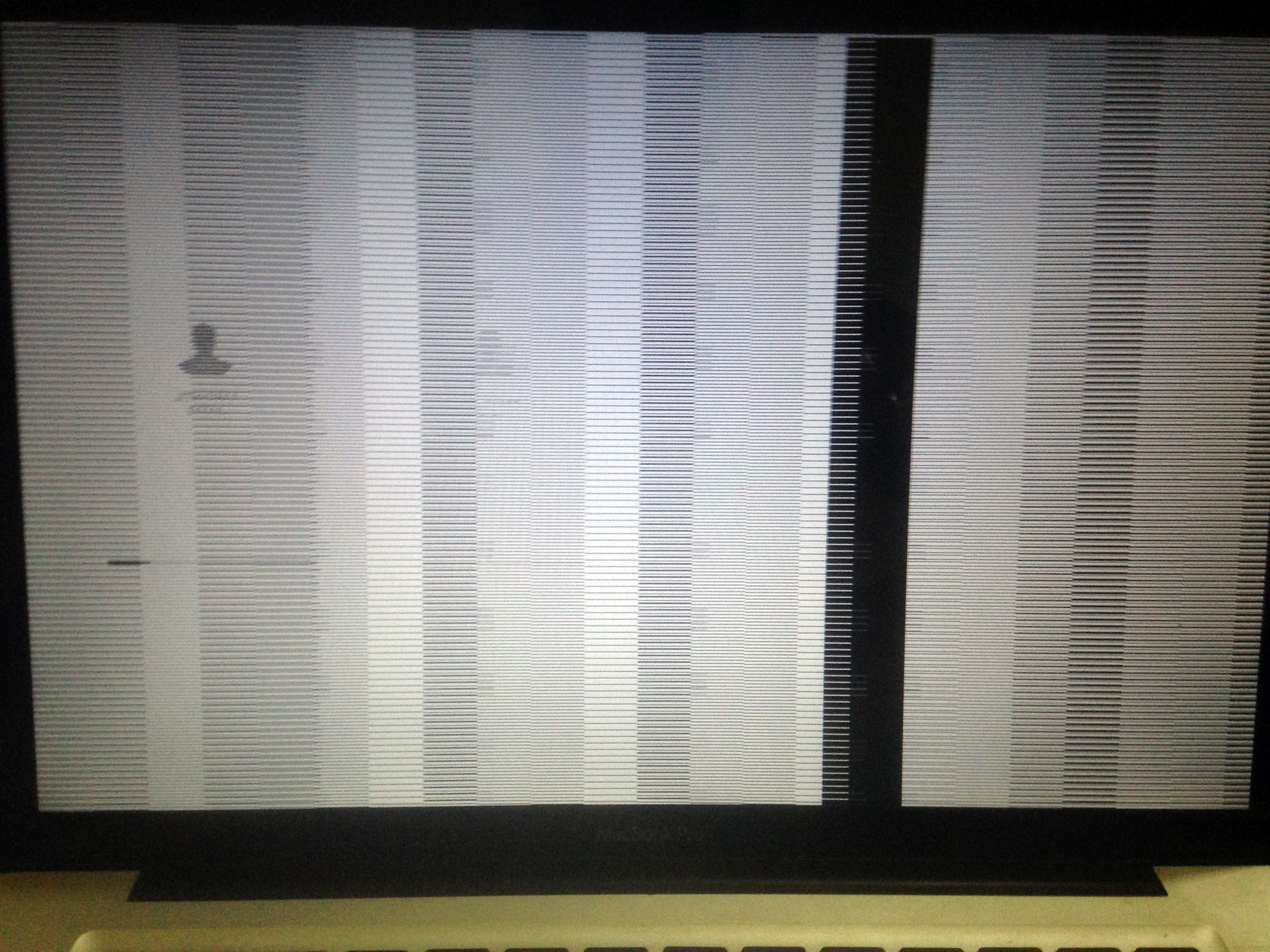

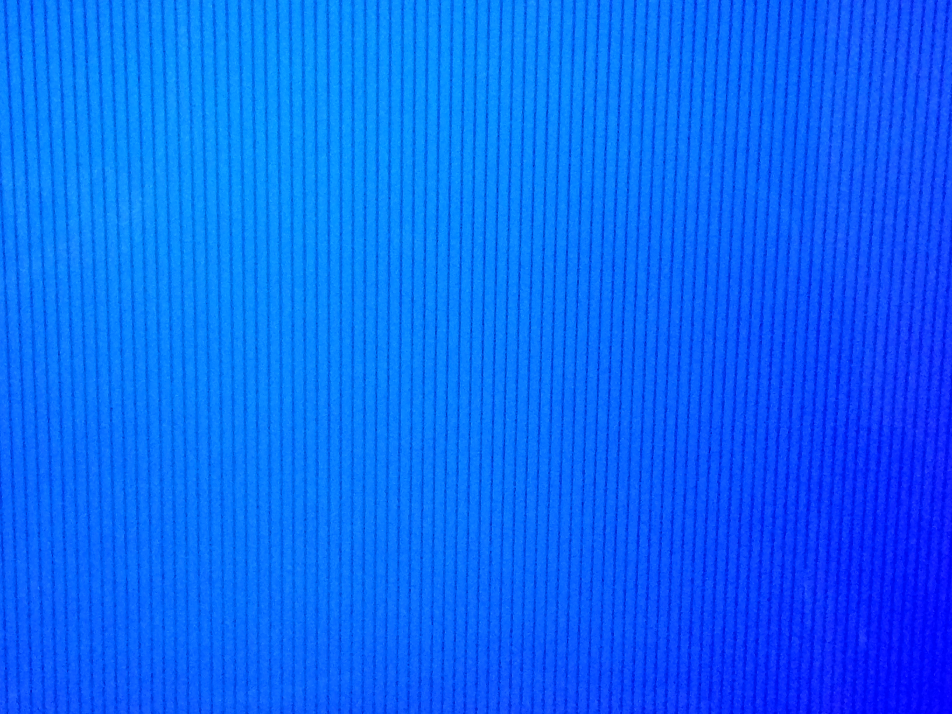

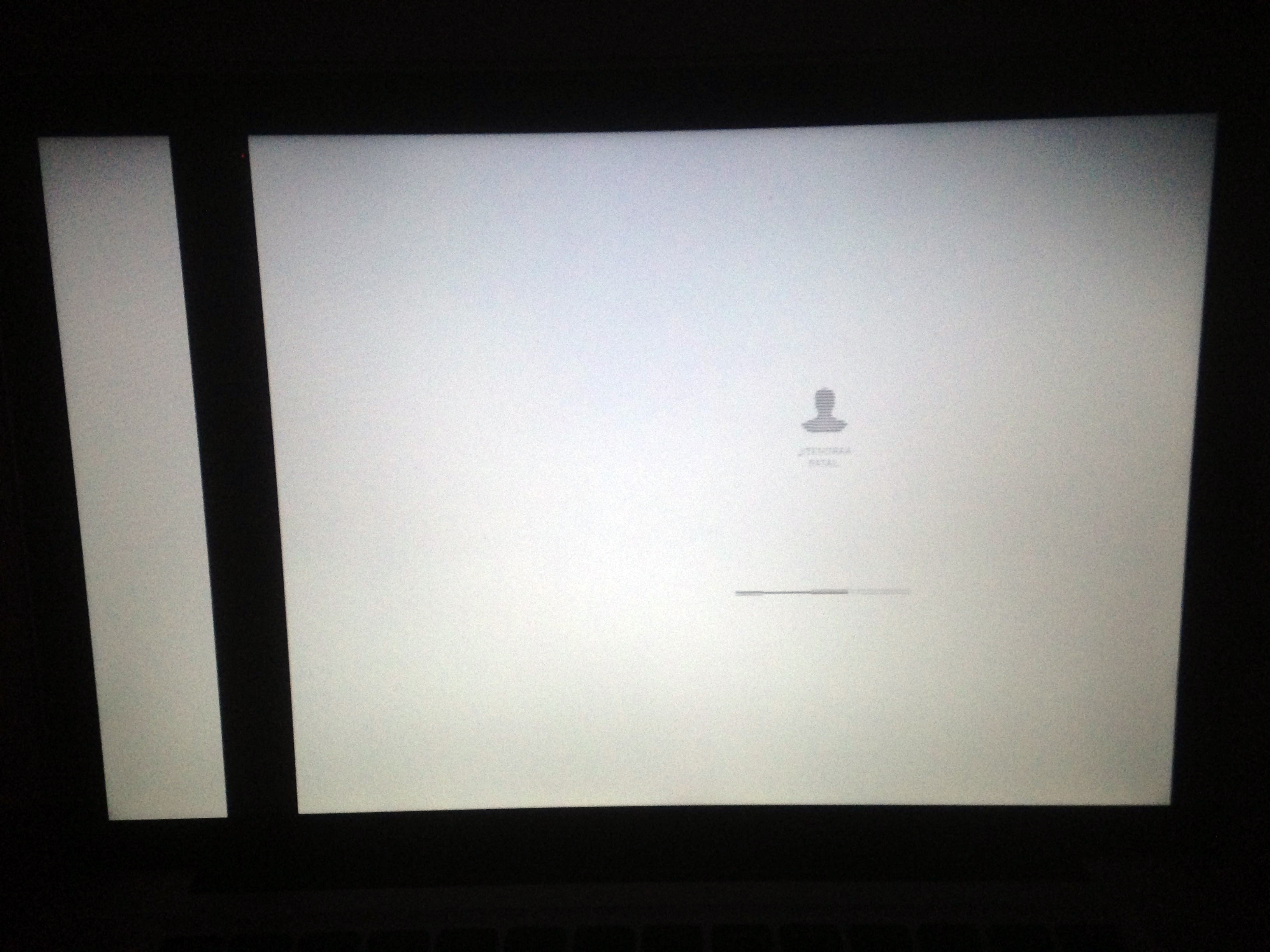

Problem:

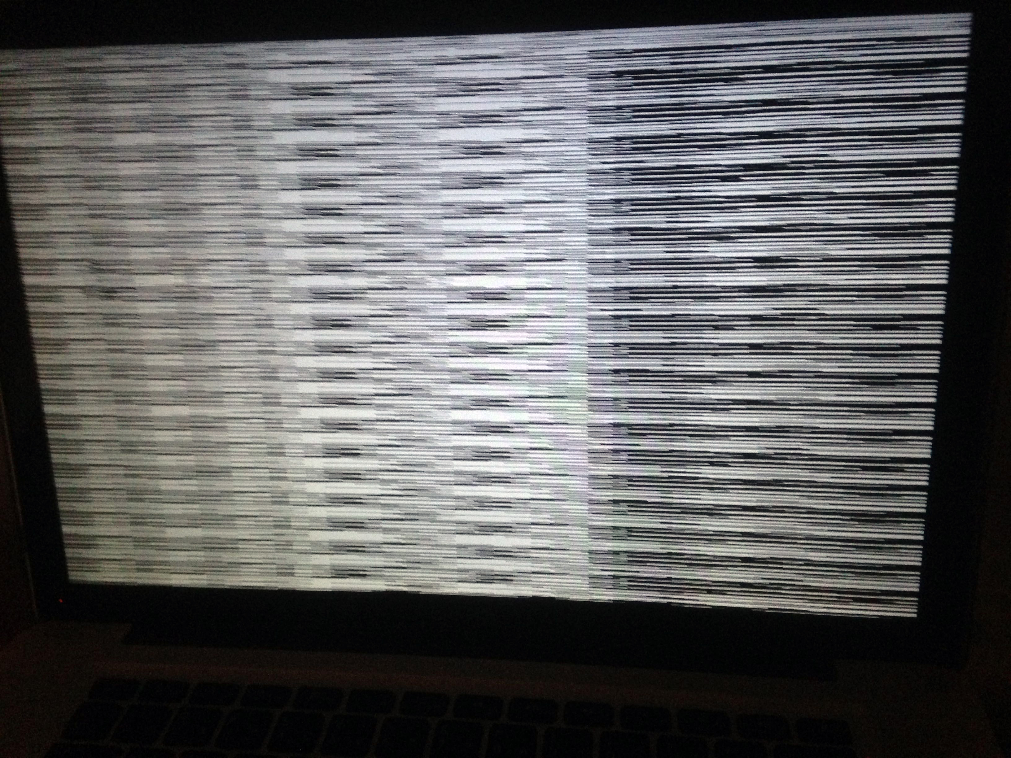

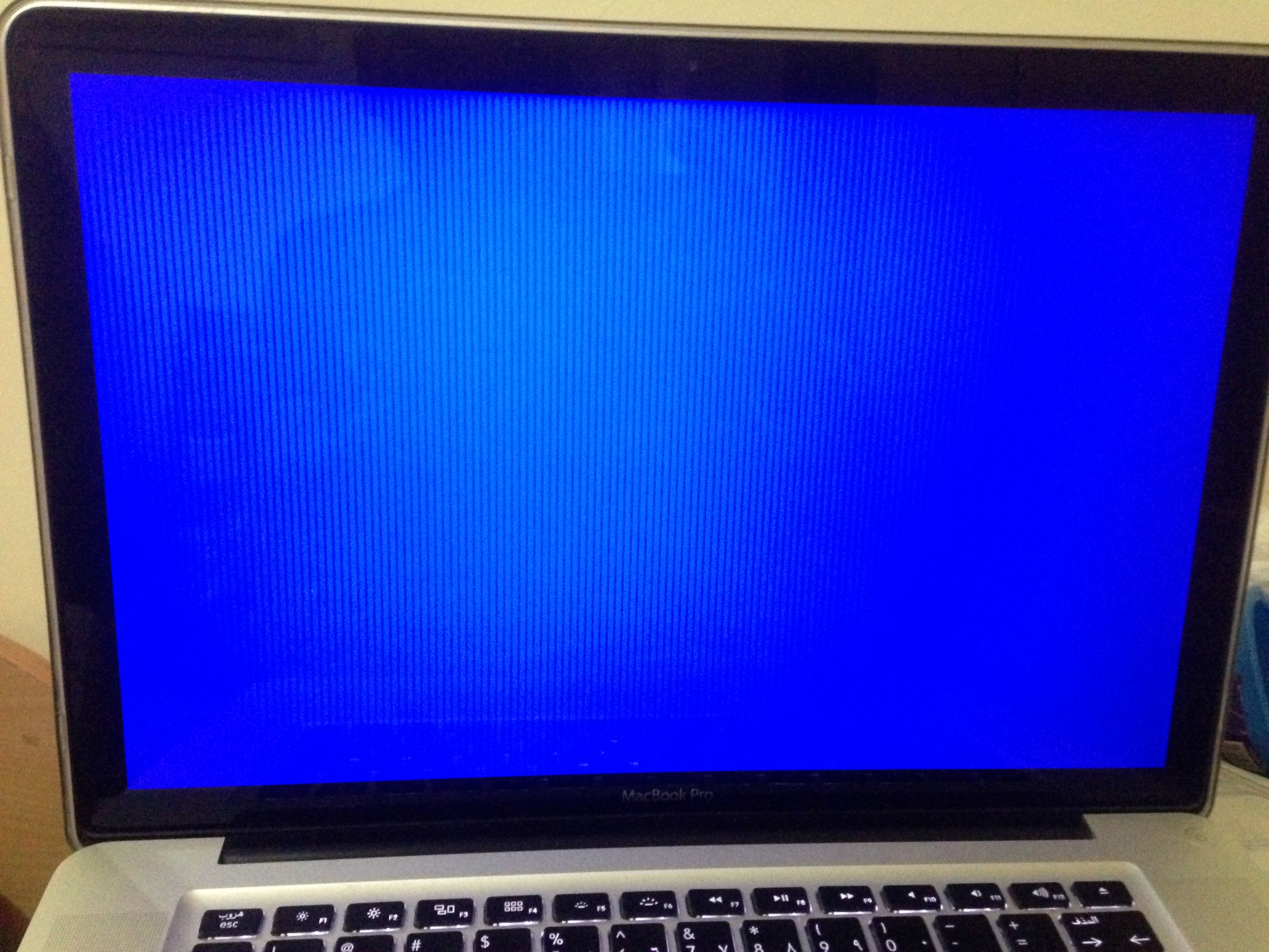

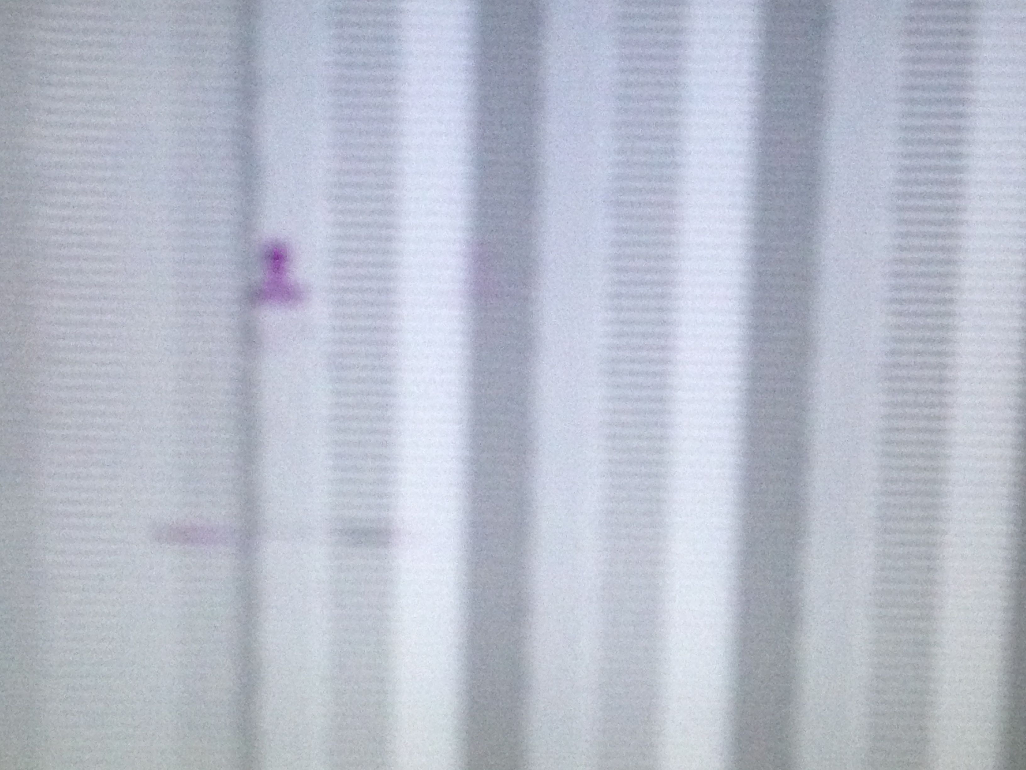

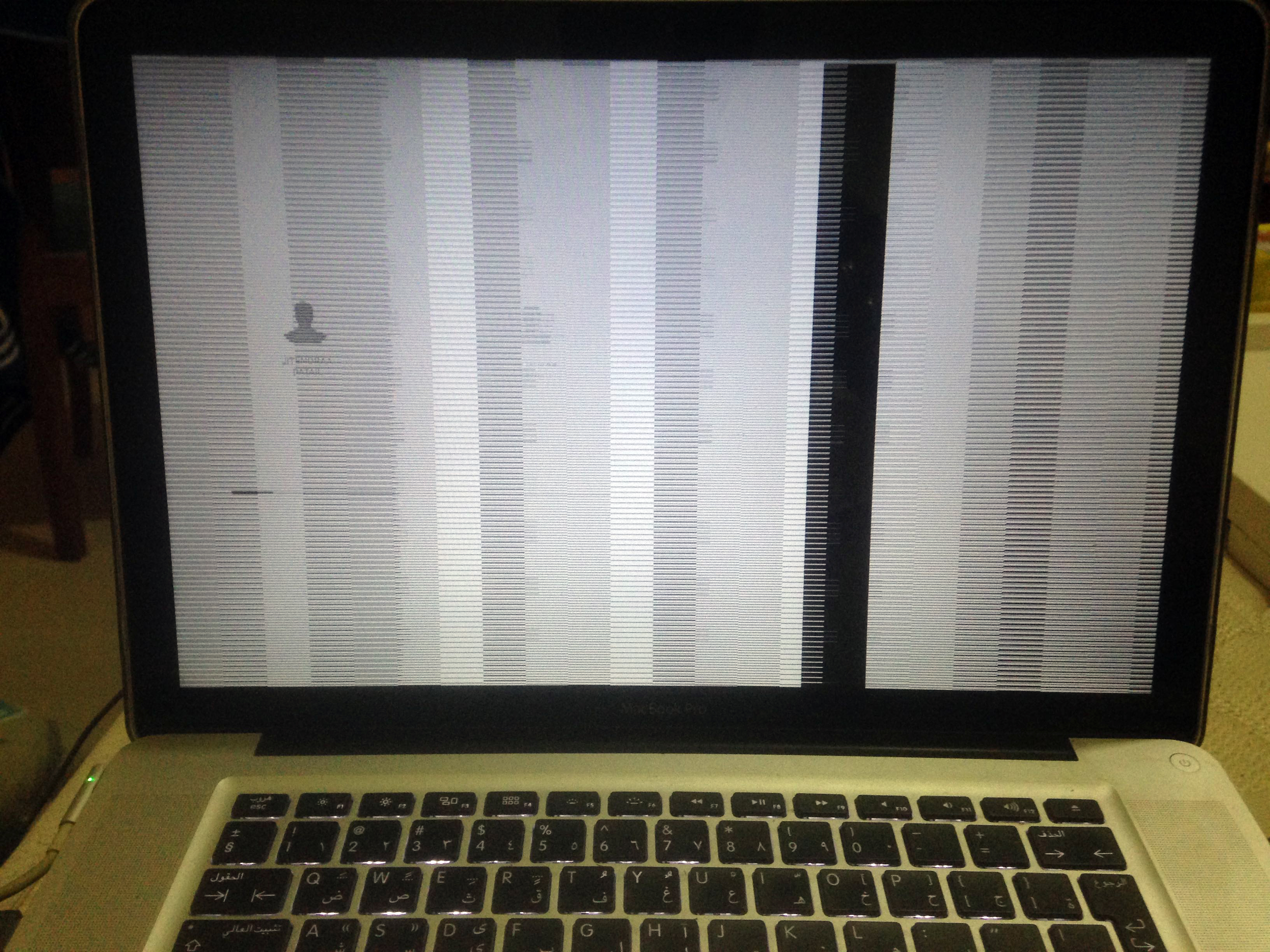

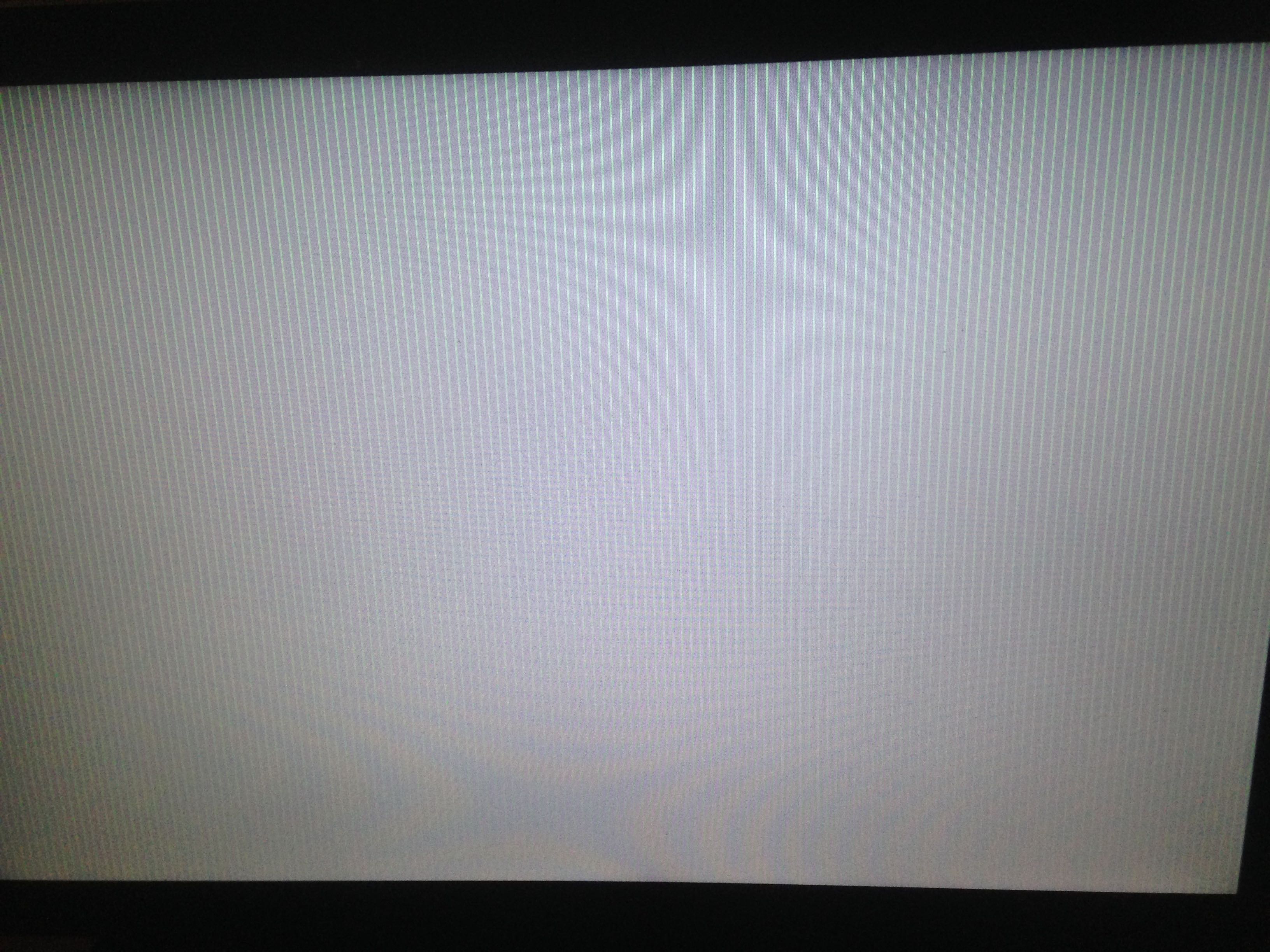

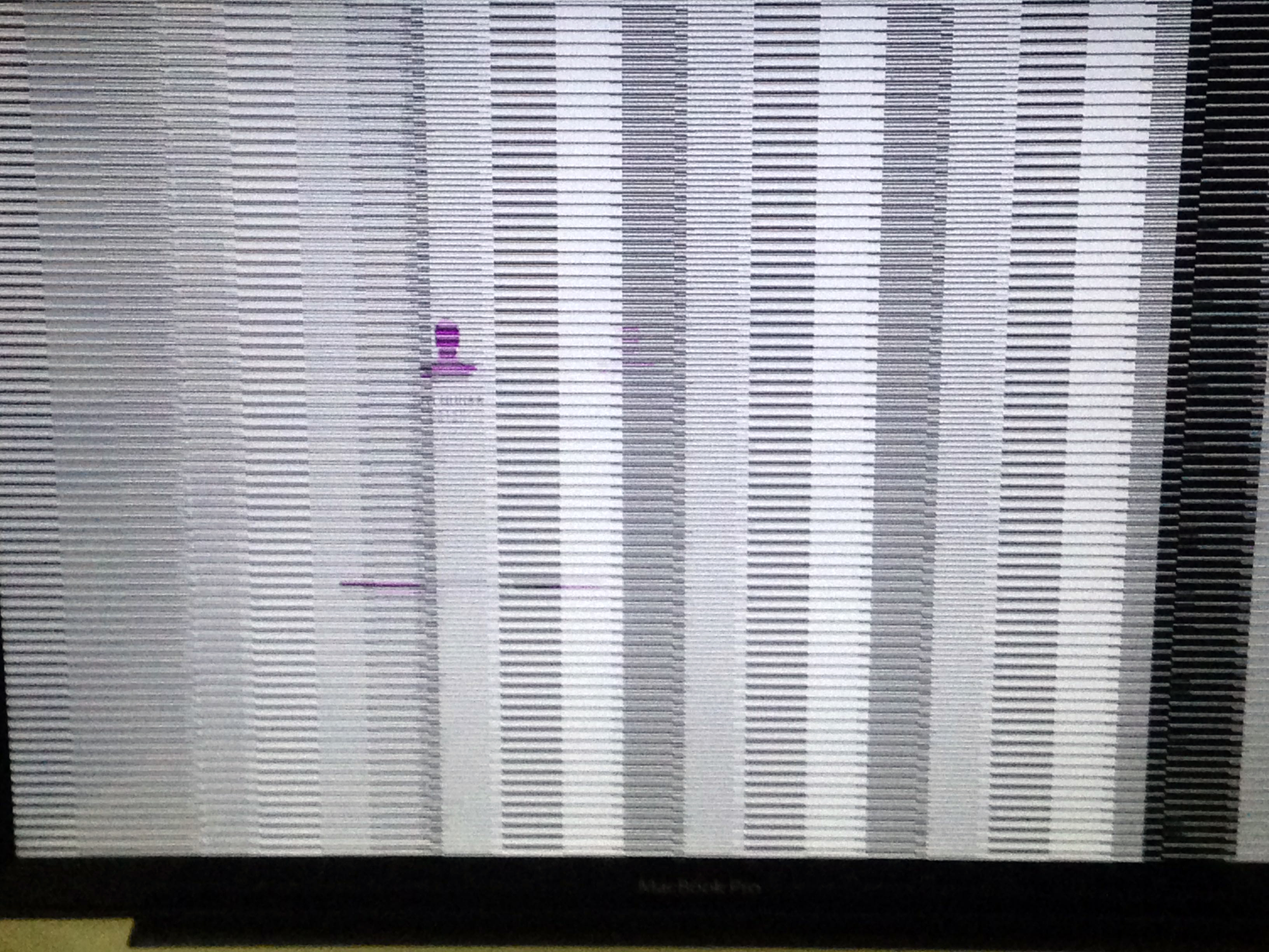

Now, its getting hot SOMETIMES and shuts down automatically.
Also the screen getting weird SOMETIMES when I was working on MBP. Amazing thing is everytime its new screen color or design pattern on the weird screen.
I will attach the photos for the reference. I just wants to know why this happens. Which hardware needs to be replaced? etc.

It's graphics card failure, very common on the 2011 models. You can try disabling the dedicated GPU with the instructions in this thread but there's no permanent fix unfortunately.
THANKS MY FRIEND. So I just need to replace Graphic Card? or the whole Logic board?. MBP also getting hot sometimes. Is it repairable?
Whole logic board, unless you can find someone who is comfortable with BGA soldering. That being said, this is a known defect and it could come back even after a logic board replacement, so it might not be worthwhile putting that kind of money into a 2011 MBP.
[doublepost=1561399634][/doublepost]In the meantime, use the software workaround in the thread I linked above.
Reactions: theapplehead
Thanks bro. Thanks for the valuable information. I will try that.
