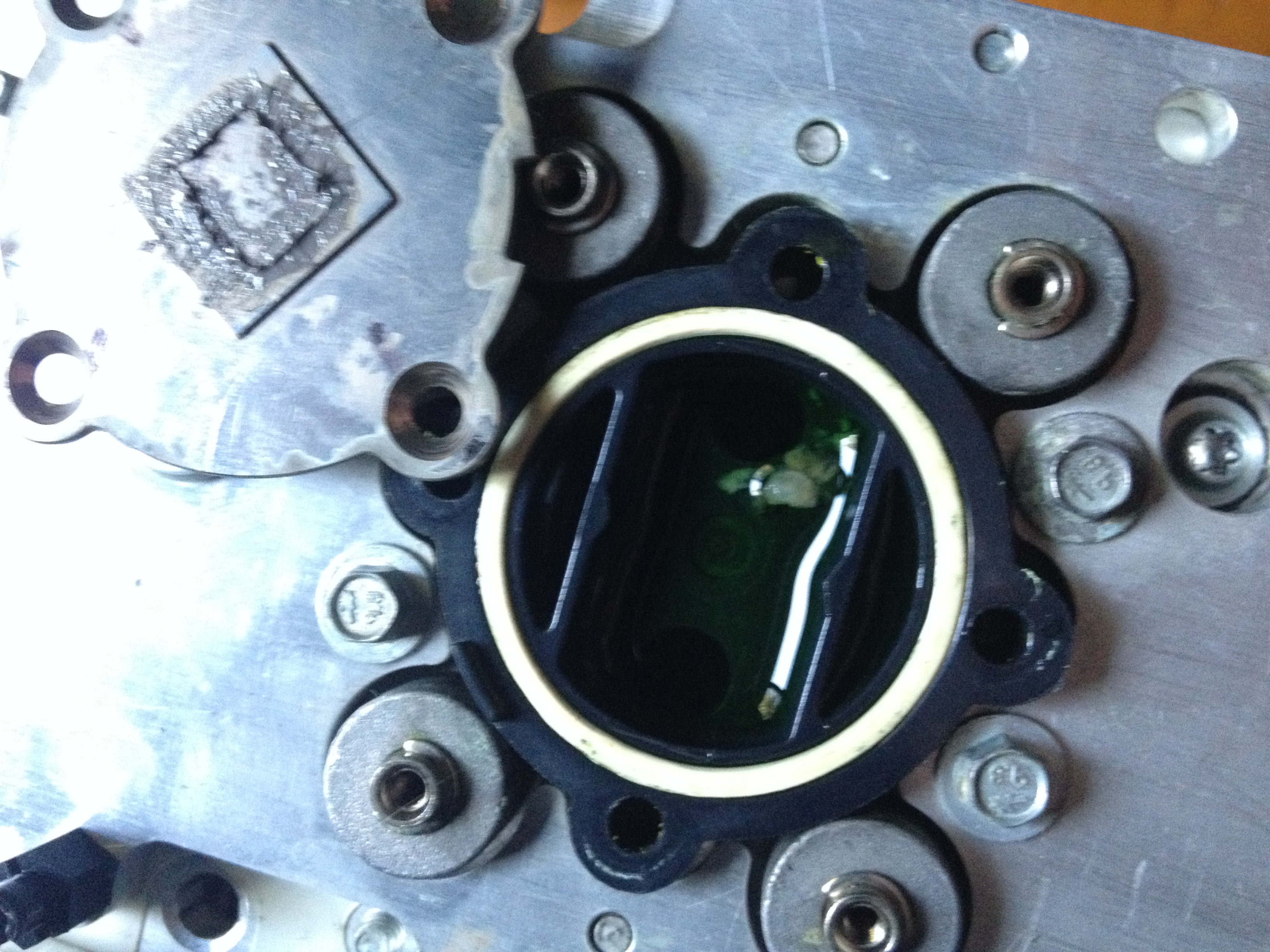

Ok so i obtain 2 power mac g5's, 1 of them is a dual cpu 2.5ghz watercooled model, and the other a dual cpu 2.3ghz normal heatsink fan cooled.
Now the issue with the watercooled one is according to previous owner sometimes it will boot up and sometimes not and when it did boot up to mac desktop randomly it will shutoff.

The LCS may be leaking, pull it and check. Random shutoffs mean it's overheating. It's a good idea to replace the O-Rings and flush the system. I did this with mine and it runs fine.

Ok so pull out the lcs unit and check for leakage, if I dont see anytrhing how do you check if theres fluid in there, and what type of fluid gm dexcool? lol

It kinda is! Like mine refused to start yesterday although it had been off for over 20 hours. I pulled it apart and found it had a coolant clot! Something was completely blocking the flow through the water block. Only thing that is weird was it wouldn't boot right away, and there were 2 red LEDs on the CPU cards. Flushed the system and made sure no air was in the lines. Runs better than ever now! I removed the virus and it's no longer sick
Dexcool sounds great! Actually I used Feser One but I'm sure you could just dump a gallon of water in it to keep it going! Kiddings 🙂 Leaky cars are no fun
The easiest way to check for coolant and drain most of it is to take off the CPU block. You can take off the hose at the top of the radiator, but don't cut it or anything unless you'll replace it. The fuel line (yes, FUEL line!) has a weird inside diameter. Fitting 3/8 on the fittings sucked, but it works.
