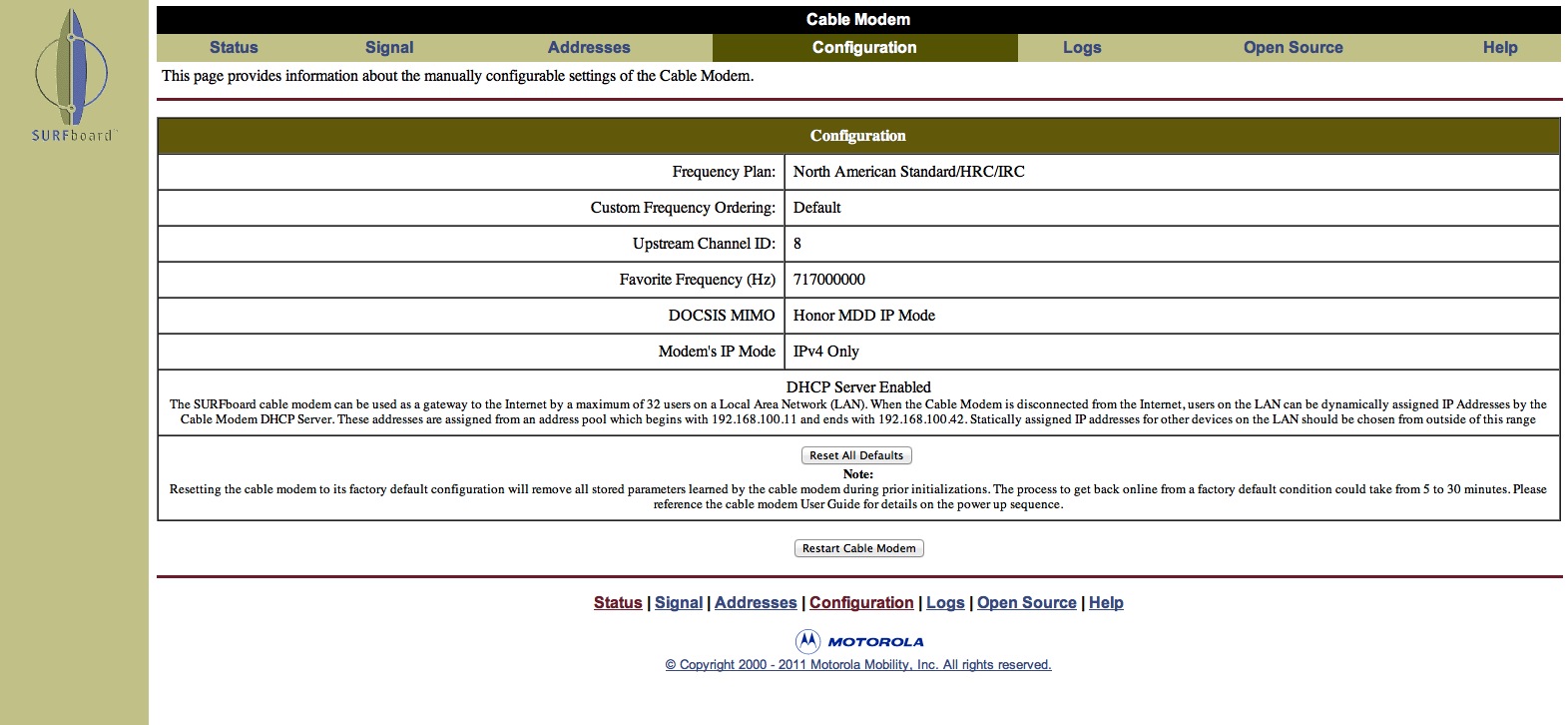

I did notice these errors (strange the date changes to June 1970)....but anyway, the look ominous with the words "Critical" attached to them, but beyond that... i have no clue what it means.
Does seem that the date change and these errors always appear in the modem logs when it disconnects/ i get the double nat error.
I have reset my Airport extreme
re-did settings

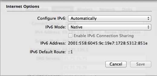

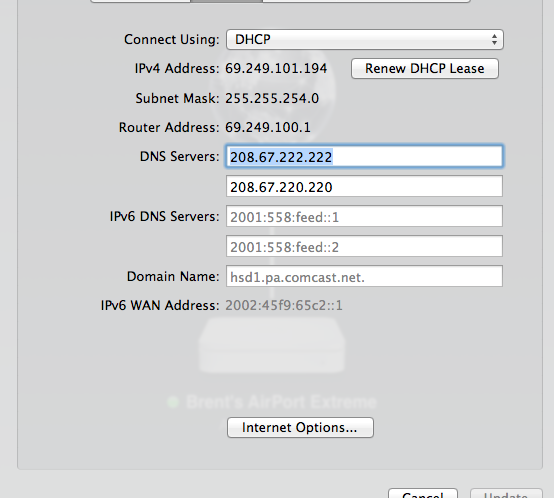

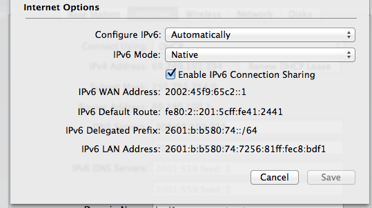

Did notice some ipv6 settings that i hadn't noticed before
So guys, i turn to you...
Basically, can you tell if my modem is just flakey and need a new one ( own it/ dont rent)
or is there something going on with this ipv6 stuff?

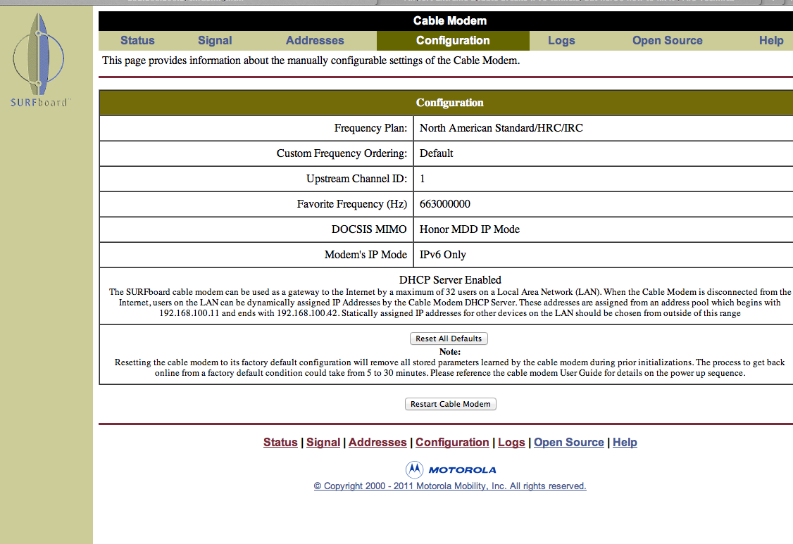

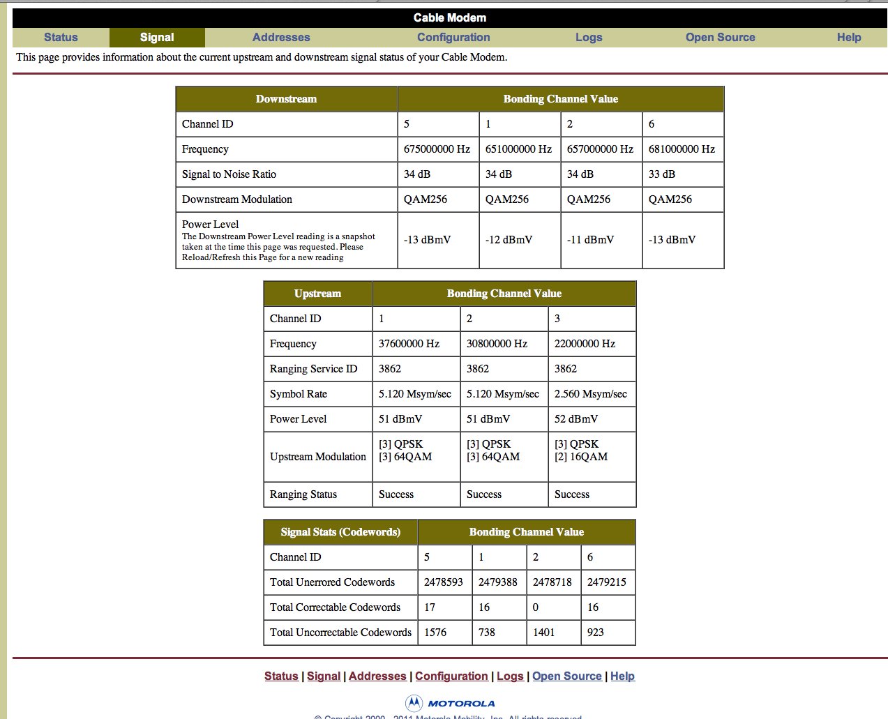

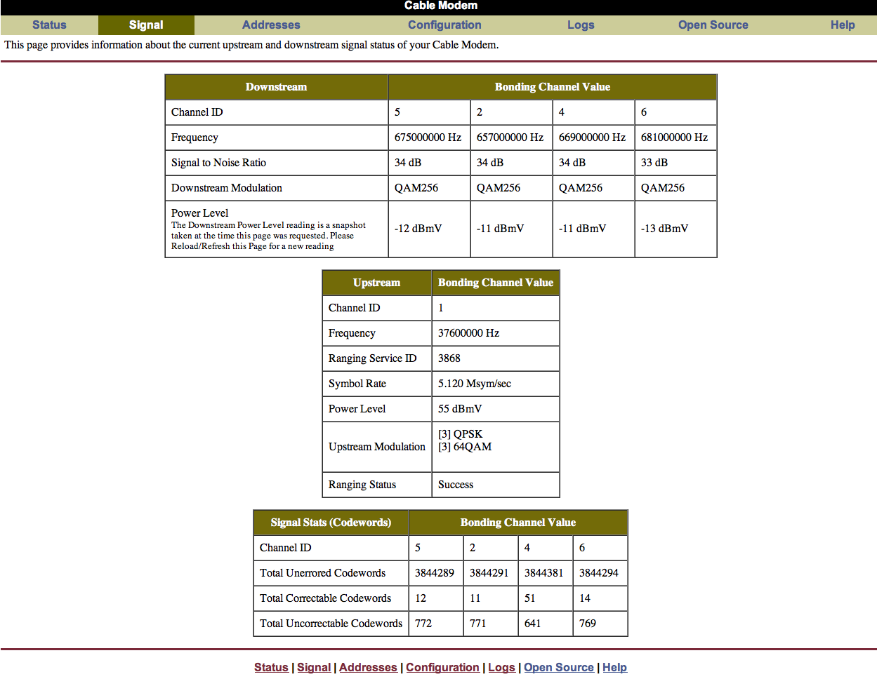

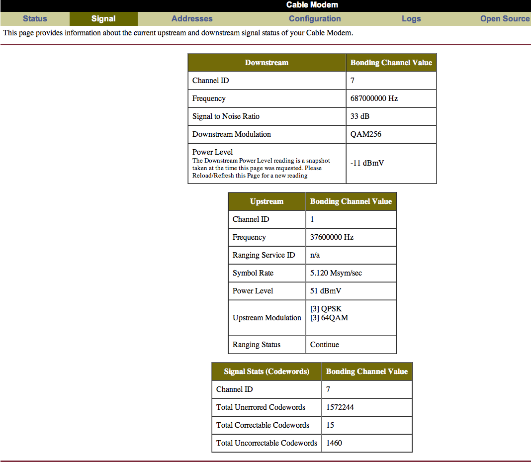

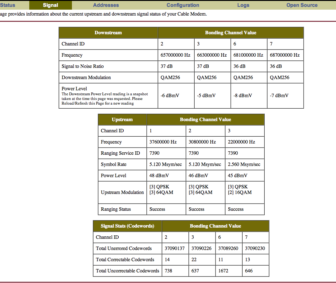

so i posted two.
the one with only 1 upstream channel was taken before i just switched the router to link only ipv6
2nd after with 3
then the last, as i was posting this, modem reset and went back to 1 upstream channel 55 dbmv power level

ok, so im thinking its the splitter.
here is the issue though. i do need the cable line split in the office, as i have a cable box in there as well.
but after removing the splitter, i see the upstream power is at a better level then the 55 before/ with splitter.
as well as the downstream power
and no modem reboots...yet
the splitter is a 5-1000 Mhz
and each split is -3.5db
do they make ones that do not amp the signal at all or less than 3.5db ...
however, i do need a split in the office as i have a HD cable box attached to the imac via eye tv.....any suggestions?

From what you have posted so far, it looks to me like with the splitter in the picture it makes your signal levels too low. That first set of screen shots with -11 signal levels is not going to work well, and that is what is causing the T3/T4 timeout errors. What those errors are is the cable plant sends out a signal (sort of like a ping) to make sure the cable modem is alive, and if the cable plant cannot properly talk to the modem you see those errors in the log. One T3/T4 once in a while is normal, but a string of them like you have is a bad connection.
This is made worse by the way Motorola's cable modem firmware works. If it detects a series of those T3/T4 errors, the modem will reboot on its own.
You are likely seeing the double NAT error on the AE just briefly after the cable modem reboots, then it goes away.... yes? That is what mine does.
Bottom line is with that splitter in your signal levels are too low and you are going to have a bad time.
What kind of coax cable and splitter are you using? You want a good quality splitter and good RG6 cables all the way in.
I would just call Comcast and show them these logs and explain what is happening. They can bump up the signal level coming into your building to fix this. There is also a device called a TAP they can use rather than a splitter that has lower signal loss on one port than the other (splitter divides the loss equally).

Up stream (Power level) is a 55 and down stream was a 11. (something)
You want the up stream below 50 and the down stream between -10 to +10
That 55 is killing you, that is the problem right there.
