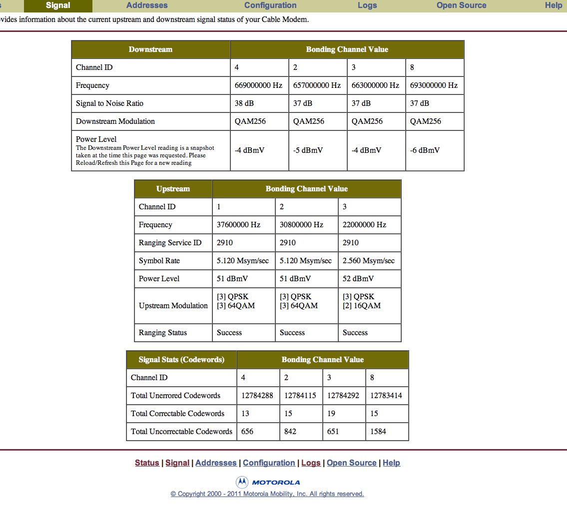

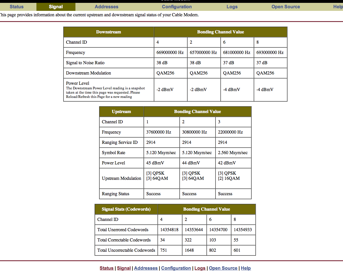

ok, so i did the switch, the modem is now directly split from the entry into the house. at first it looked real good (see the first screen shot with downstream at about -2 and up at about the mid 40's. It then rebooted (see error T4) and now its been up for a few minutes at ds -4 to -5 and up 51/52.
I have no idea whats going on. Why would i have gotten a t4 error with good up and down stream # s initially ?

Both those shots are pretty good signal levels. If you are still getting t4 errors at those levels there is a bad connection somewhere further up the line. I would call the cable co again and have a tech come out.
I went through this a few years ago and they finally found a bad connection a few blocks away.
