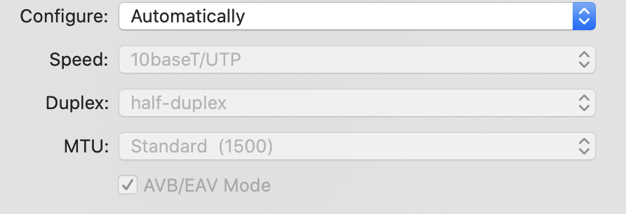

You can see the connection speed in System Preferences/Network/Ethernet/Hardware without using Network Utility.
I might be wrong here but I don’t think that option reflects what your actual negotiated link speed is, but instead is the speed at which you prefer to connect to, both things can differ, I have it set at 1000 for example but the actual speed on Network Utility can read 100.
This very option you mention is what ifconfig outputs, the value can even be “autoselect”, which differs from what Network Utility prints which is the actual speed you end up connecting at.
If your adapter is set to autonegotiate (and it should be, except in very limited circumstances), the network preference pane will indeed reflect the actual connection speed and duplex status as long as there is an active ethernet connection.
Not the negotiated speed.

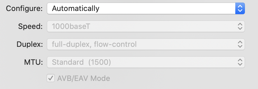

The first screen capture here reflects my switch port locked to 10Mbps/half duplex and the adapter set to autonegotiate. The second screen capture shows both the switch and the adapter set to auto.
This same information is also available in System Information, under the network section.
