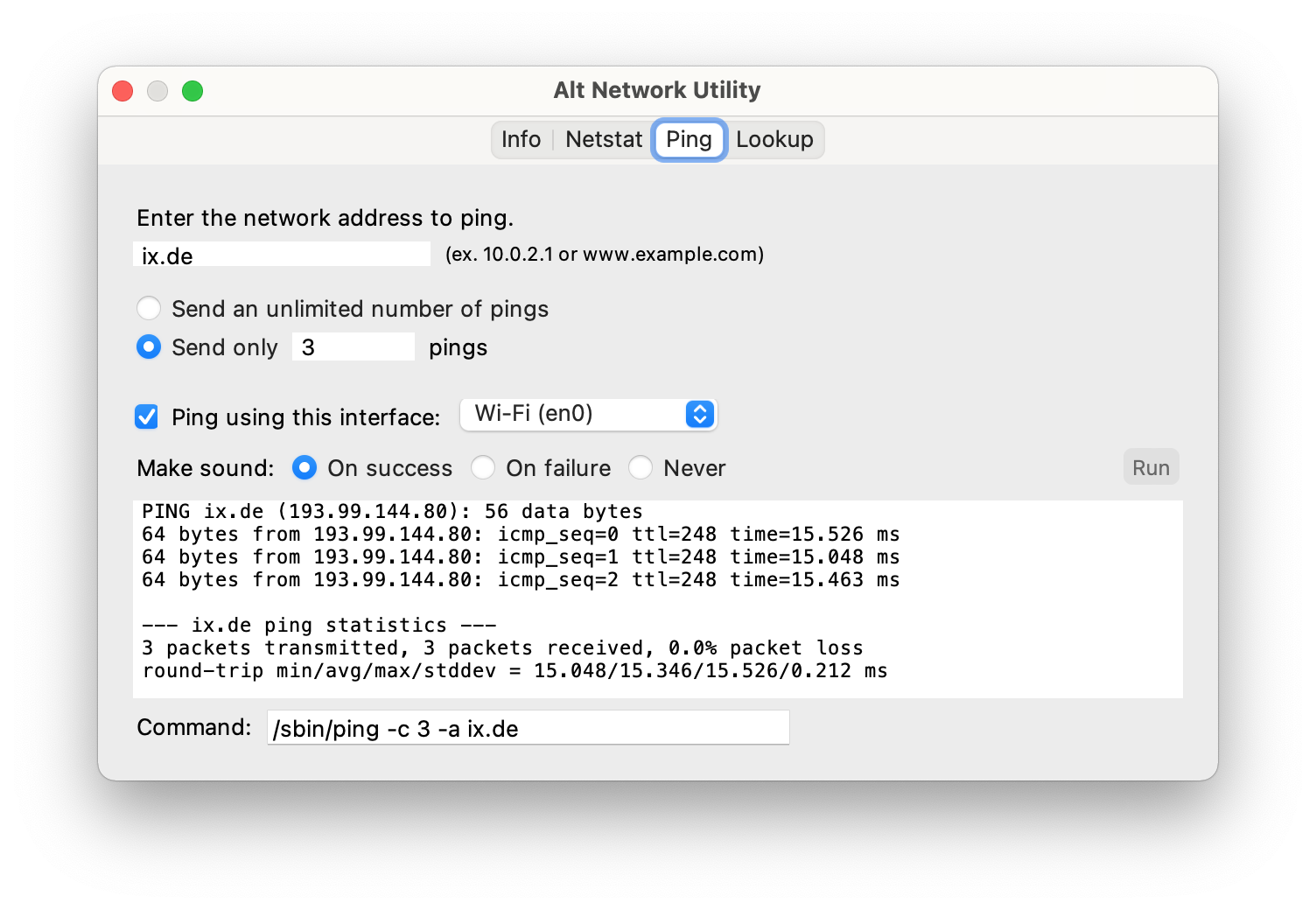

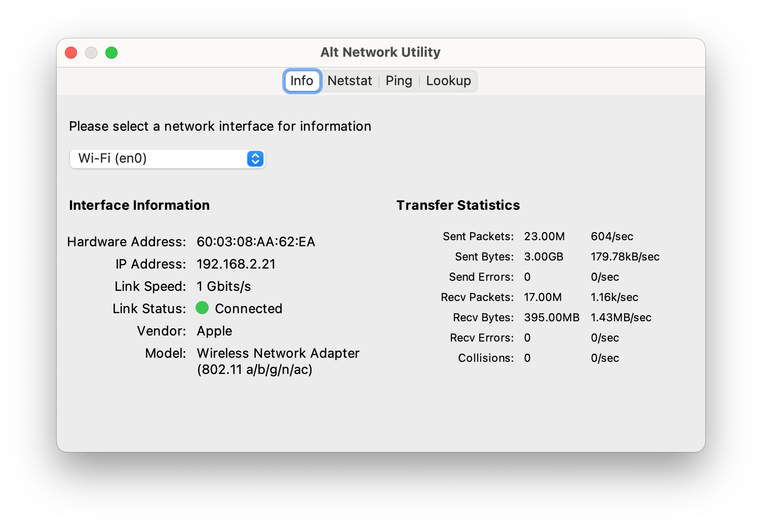

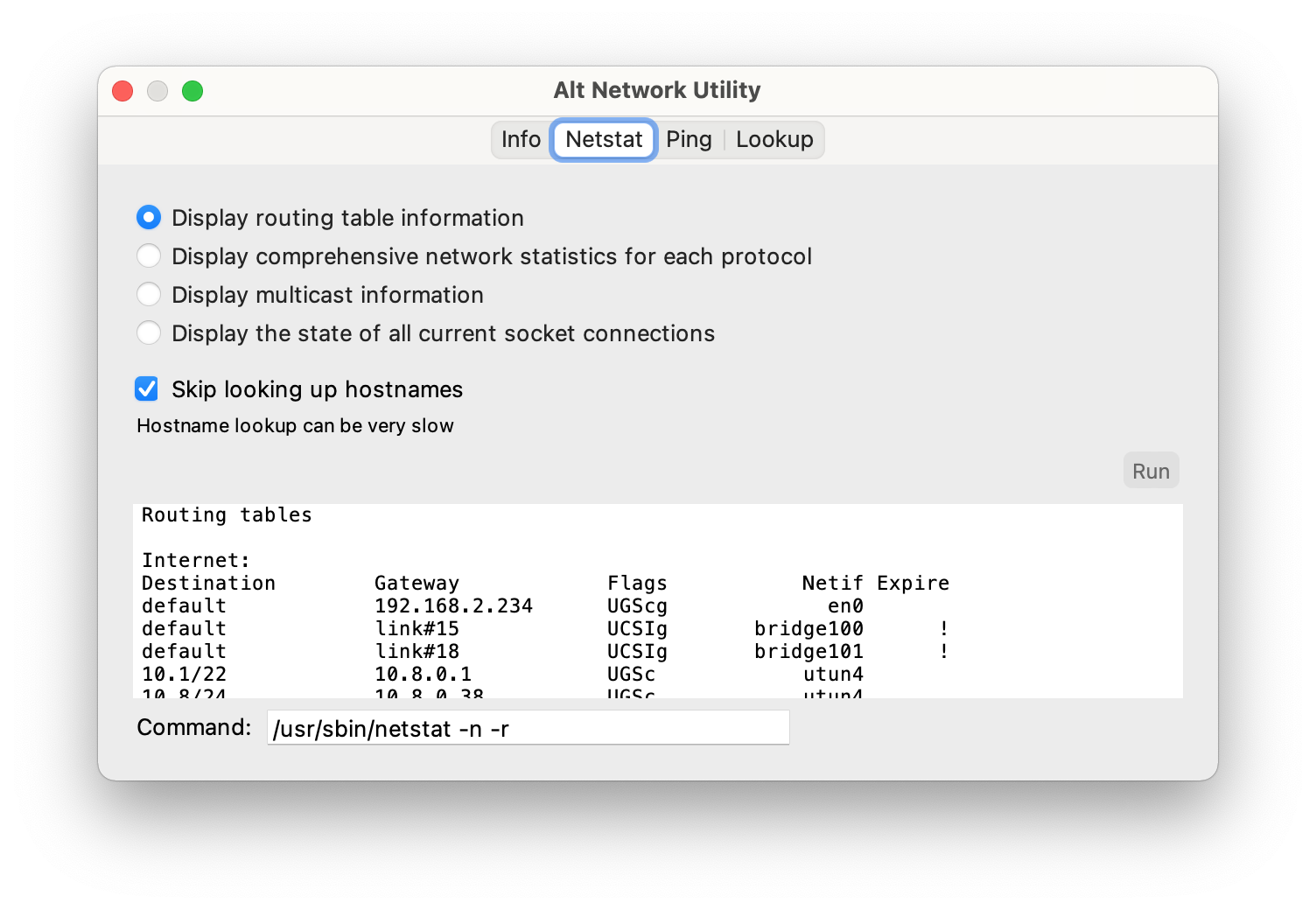

OK, so I've started making a tool (a year ago, actually) that tries to bring back some of Apple Network Utility's ideas, and I'd love it if someone could try it out. It has no icon yet, and it's also not code-signed (so you get a scary warning when macOS first runs it) yet — I'd prefer to wait on giving Apple $99 until I know there's some interest. 🙂
Right now, only the Info, Netstat, Ping, and Lookup tabs are there. No Traceroute, Whois, Finger, Port Scan yet. Here's what they look like:
There's some additional functionality; for example, the Ping tab lets you ping from a particular interface, and the Lookup tab also lets you see how macOS's and BSD's name DNS cache may differ.
Also, the tabs show you (at the very bottom) what equivalent command you could type into Terminal. You can click around in the GUI, and the "Command" field at the bottom will reflect your changes.
If anyone's into that, the project is at https://github.com/chucker/AltNetworkUtility, and you can get the first public beta from https://github.com/chucker/AltNetwo...nload/1.0-beta7/Alt.Network.Utility-1.0b7.zip. You can also opt into an automatic update check if you like.

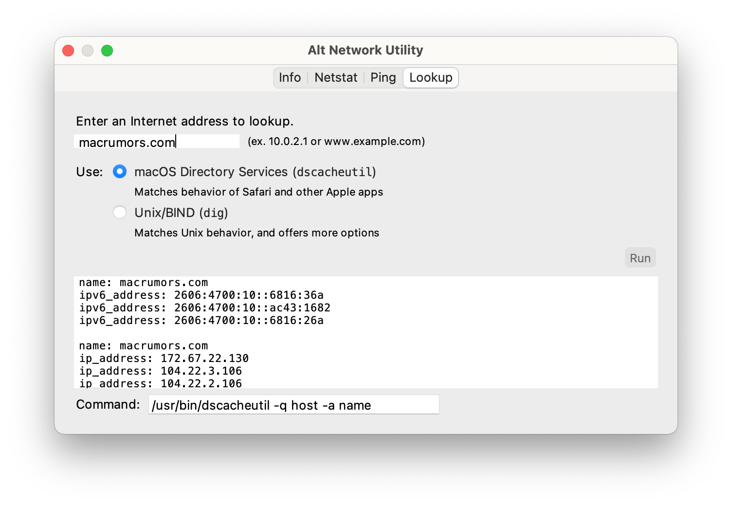

For lookup, what my tool does is:
  • you can choose macOS's directory services (long ago known as "NetInfo"), in which it creates a command line such as dscacheutil -q host -a macrumors.com
  • or you can use BSD's, in which case the command line looks like dig a macrumors.com, dig mx macrumors.com, etc., depending on your choice
Apps such as Safari will not go through the BSD pipeline for hostname lookup. In particular, their caching behavior may be different. So you can have situations where tools like nslookup, dig and host tell you one thing, but Safari tells you another thing. That's why I'm also offering dscacheutil, which more closely mimics how many Apple GUI apps do their lookup.

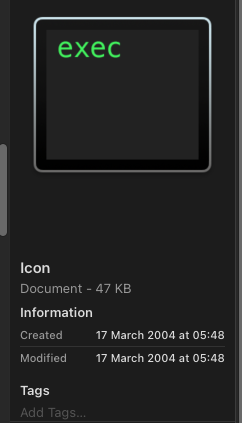

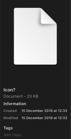

Hmmm, that did not work anymore, I had an Icon set on my Document Folder, can't even recall when I did that, might have been years ago, I deleted the Icon without a problem, pasting it back....not so much.
This is my Custom Document Folder, I restored it from a Time Machine backup.
It's (Custom Icon) done years ago, I have 2 Icon files in there, one from 2004 and another one from 2018.

there are several ways in macOS to do a DNS lookup - and it certainly doesn't help that they give different results! To try it out, put the web address of your choice into the /etc/host file and point it to localhost - then check what the different tools give you as the IP address.
Correct. Most Apple tooling goes through Directory Services instead of Unix. Third-party browsers often add their own DNS settings on top, too. So BSD tools like nslookup, dig and host won't reliably tell you how GUI apps will behave.
