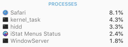

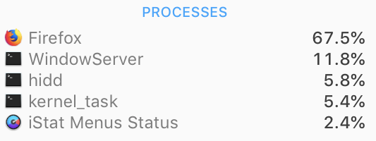

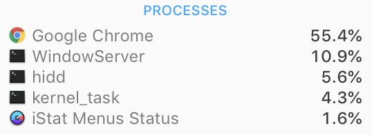

Interesting... I mainly use Safari too, but I did not realize how much more CPU-efficient Safari apparently is compared to Firefox and Chrome (which I only use occasionally). Just letting the forums.macrumors.com page sit after letting it load and stabilize, Safari only consumes about 10% CPU, with Firefox and Chrome are both in 50-60% range. That would likely explain the heat.
