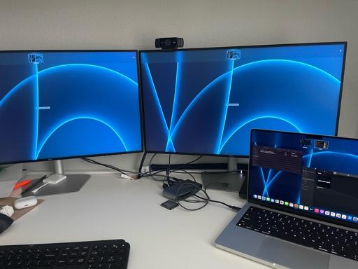

Please see below. I have a thunderbolt dock plugged into one TB port with two HDMI plugged into it and it drives both monitors.
Base 14” model

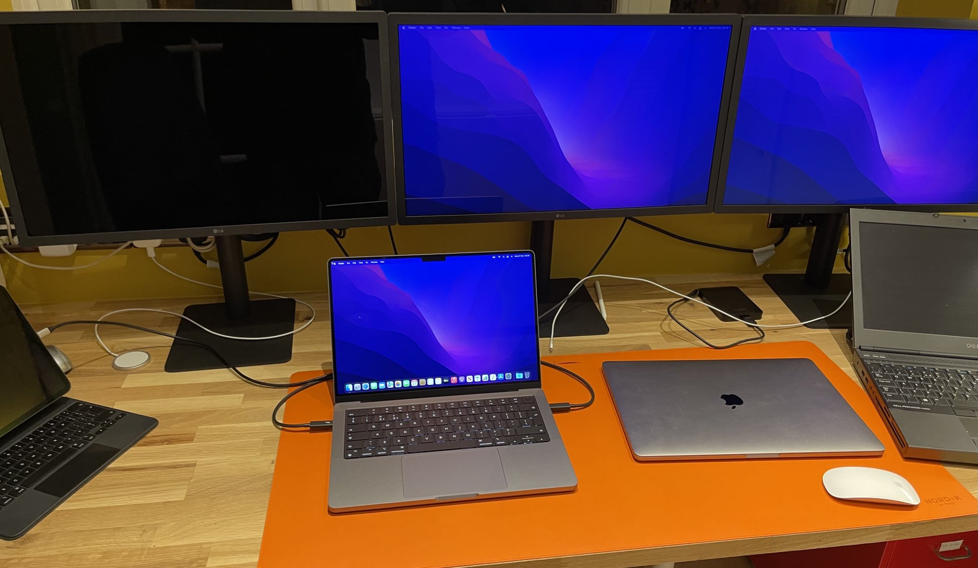

Ok so have been following this thread as the only reason I was considering the m1 max is the advertised two monitor limit of the m1 pro. I was hoping that you would be able to daisy chain 2 4K monitors using TB on the pro as well as using a third 4K on the opposite side port. Unfortunately it doesn’t work as shown in the picture third monitor is blank whatever I do with the thunderbolt cables, using 3 LG Ultrafine 4K 23.7” models. So looks like definitely limited to 2 external monitors on the M1 Pro whatever the resolution of the monitors.
Reactions: pshufd and ascender
View attachment 1881274Ok so have been following this thread as the only reason I was considering the m1 max is the advertised two monitor limit of the m1 pro. I was hoping that you would be able to daisy chain 2 4K monitors using TB on the pro as well as using a third 4K on the opposite side port. Unfortunately it doesn’t work as shown in the picture third monitor is blank whatever I do with the thunderbolt cables, using 3 LG Ultrafine 4K 23.7” models. So looks like definitely limited to 2 external monitors on the M1 Pro whatever the resolution of the monitors.
