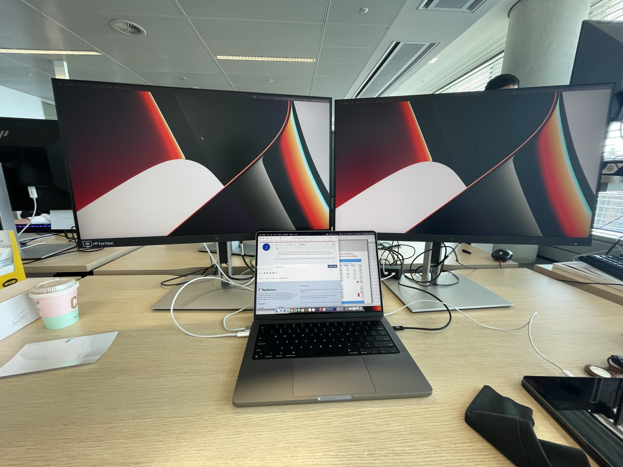

I picked up a 14” 10 core with M1 Pro. When I bring it to work I’d like to be able to have it run the two (crummy, 1080p) HP Monitors there. They’re currently hooked up to a Surface hub with USB C out of the hub into the HDMI port of each monitor. Will I be able to plug those two USB C cables into my MBP and have it work?
Yep. It works. No charging of course but it easily drives all three displays with two USB-C to HDMI cables.
Edit:I should add the the image quality is so bad that I may just give up on this anyway. These are not good monitors to be sure, but, as usual, they are much, much worse on MacOS than they are with Windows (off a Surface through the hub into HDMI). Ugh.
