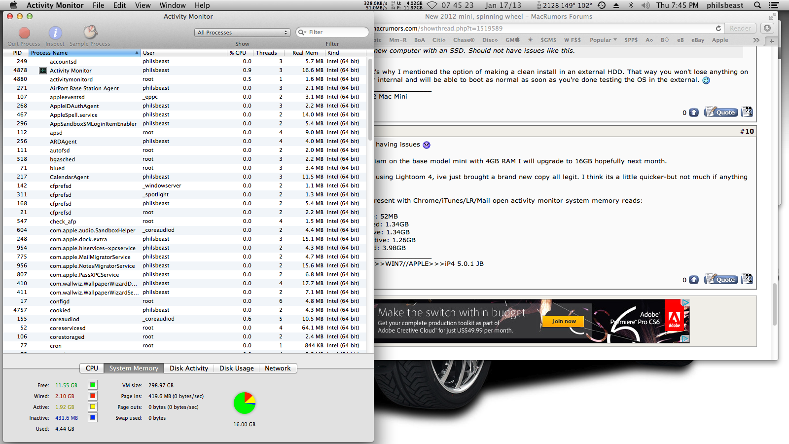

look at my system memory on a 2012 i7 2.3 16gb ram.
page ins 420 mb
page out 0
swap 0 this means i never was short ram a single time.
from boot to now in my case 30 hours .
if I boot again page ins goes to 0 along with the other counters.
my current breakdown is 11.55gb free out of 16.0gb.
so i don't need more ram and since I am maxed it is good I do not need more.
the op is at 3.98 gb out of 4.0gb as he reports for a current view he needs more ram.
