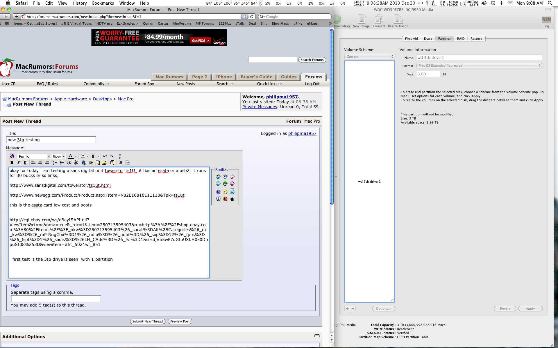

first test is the 3tb drive seen with 1 3tb partition yes
next test is writing 0's it starts out writing 0's at 95 MB/s

I know the low cost esata JMB360 chip boots and runs systems around 100mb/s so for a 1 drive external it is nicer then a fw800 which is lucky to run 70MB/s. Not sure if it will so it with a 3tb drive but it would be nice to know. the screen shots below have info showing the hdd is seen and the speed of the 0 over write.

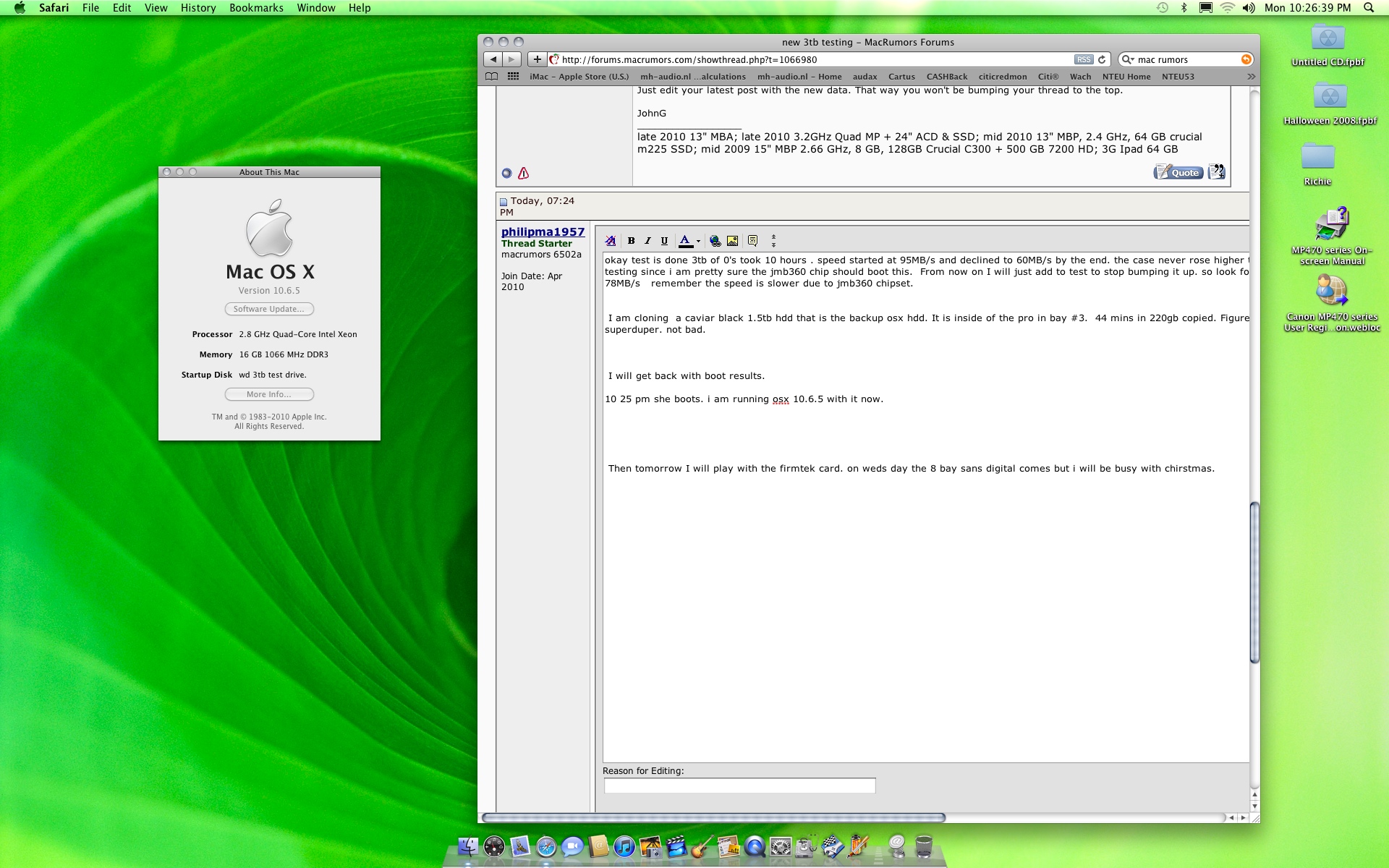

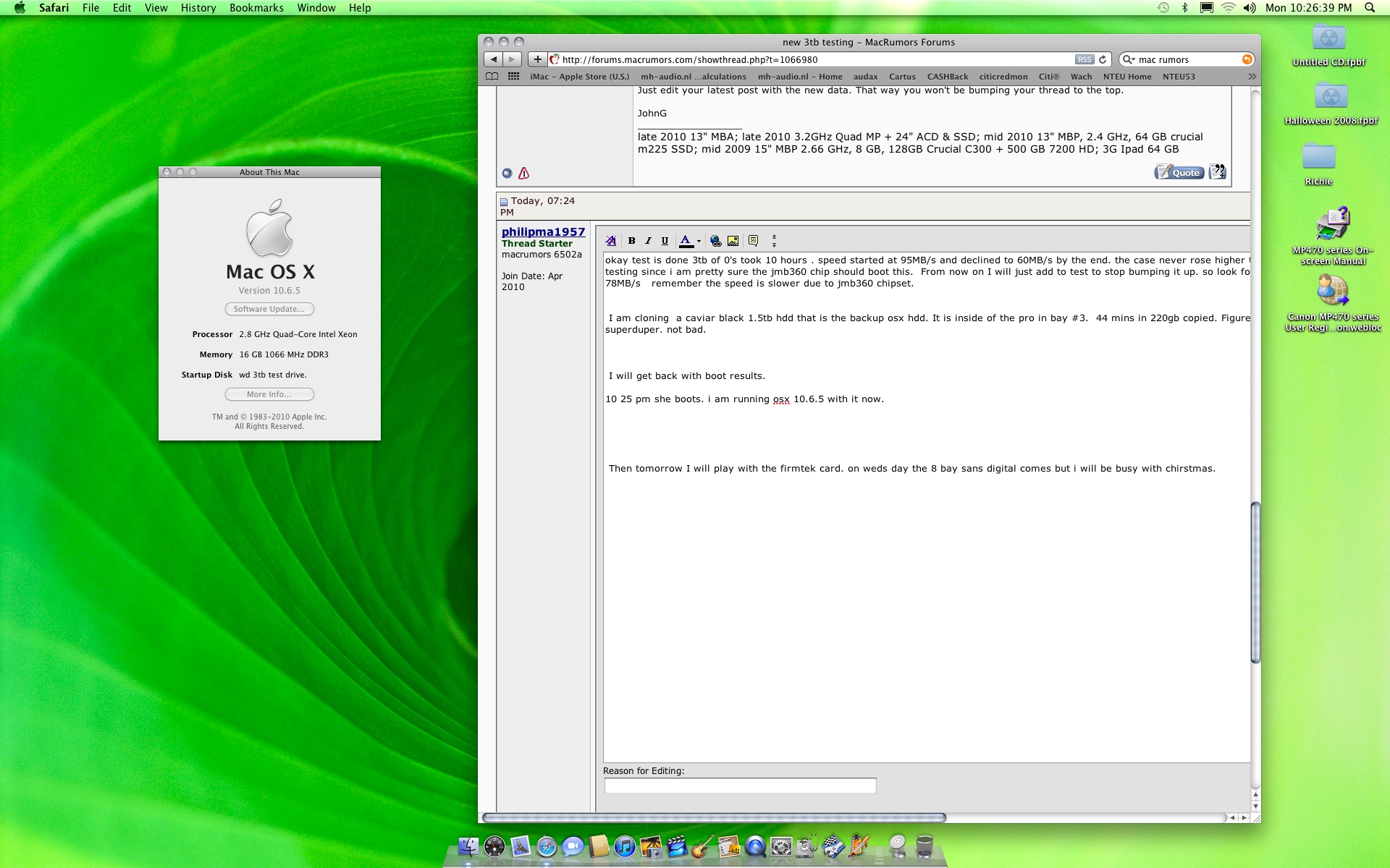

okay test is done 3tb of 0's took 10 hours . speed started at 95MB/s and declined to 60MB/s by the end. the case never rose higher then 92f house temp was 76f. I am going to load an osx via a clone and do some boot testing since i am pretty sure the jmb360 chip should boot this. From now on I will just add to test to stop bumping it up. so look for this later for more info. Now doing a superduper osx clone of 500gb. Avg speed is about 78MB/s remember the speed is slower due to jmb360 chipset.
I am cloning a caviar black 1.5tb hdd that is the backup osx hdd. It is inside of the pro in bay #3. 44 mins in 220gb copied. Figure about 2 hours to clone 500gb via superduper. okay 1 hr 45 minutes to clone 500gb via superduper. not bad.
((( I will get back with boot results.
10 25 pm she boots. I am running osx 10.6.5 with it now.))))
