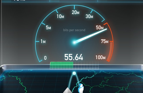

This is not definitive because my connection speed fluctuates from time to time, but overall I think it is definitively faster. Web pages load noticeably faster.
This is a little irrelevant. I don't know what kind of modem you have, but have you considered a new DOCSIS 3.0 modem with bonded channels? My wifi speed used to fluctuate horribly until I upgraded. The bonded channels can help with a more consistent connection.
