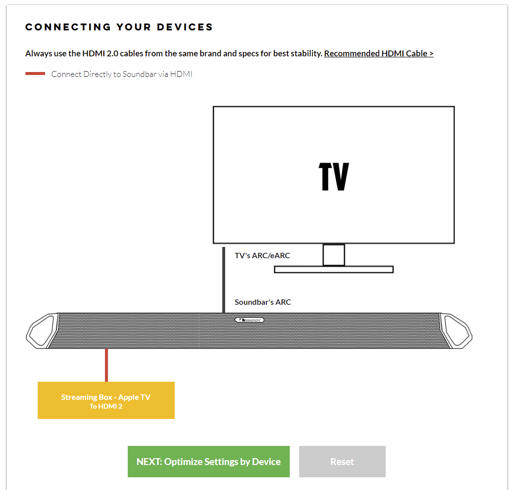

So, I just purchased the new Apple TV 4K with Siri remote and it just refuses to turn on my TV and sound bar. I have a Samsung Ru8000 (2019) and a Nachamichi sound bar. The Apple TV is connected to the sound bar, sound bar is connected to the ARC HDMI port on my TV. CEC is on, on the TV and the sound bar and control devices is turned on, in the Apple TV remote settings. When I press the power button or home button, the Apple TV will turn on but nothing else. If I then use the TV remote to turn on the TV, TV starts and it powers on the sound bar, but...The siri remote control pad will let me move around screens but the volume, home and back buttons don't work. At this point, if I restart the Apple TV, boom, the remote works great. Home, volume buttons start working again. Once I power off the Apple TV, it does power off the TV and sound bar.
