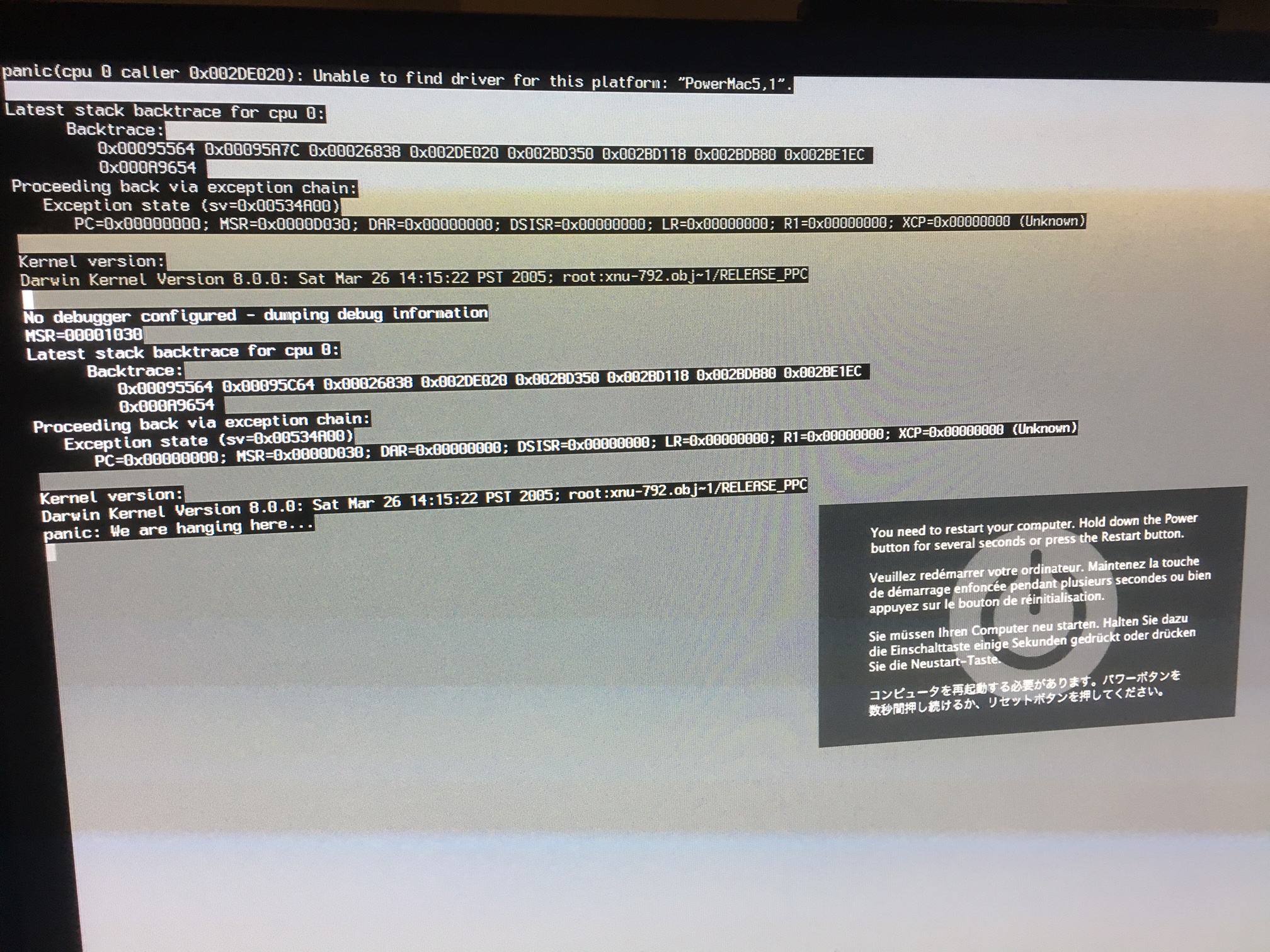

Tonight I'm trying to install Tiger, but keep getting this while booting from the DVD. I have managed to get to the setup screen a couple of times but haven't dared format the drive in case the install fails and I 'brick' it (if I can't install from DVD I have no other way of getting an OS on there.) Anybody know what this error is? The Cube seems a bit unstable at the moment.
What does that Tiger disc that your trying to boot from look like? For OS 9, it sounds like your cube does not have the OS 9 drivers installed. You'll have to erase the hard drive in order to install those.
I don't have an original, it's just a 10.4.0 ISO I downloaded. It does sometimes boot so I don't think it's the disc, more likely the drive.
Sorry could you elaborate on installing OS 9 drivers?
Well sadly it looks like this thing might be scrap. The USB ports intermittently stop working, I need to unplug and re-connect the keyboard and mouse repeatedly. Also, the DVD drive won't boot at all if the Cube is upright. If I lay it on its side so the disc is facing up as it should be, after about 10 minutes it eventually gets to the 'welcome' screen, but can't get any further than that.
Without a working optical drive it's pretty much useless as I can't think of any way to get an OS on there.

For anybody interested I have found a work around. You can't boot a Cube from a USB optical drive, but you can install from it once already booted! So I used the faulty internal optical drive to (slowly) boot to the install screen, then in disk utility I ejected the disc, and then put it in my external USB drive and carried on with the installation. Works like a charm 🙂
However it looks like the HD is faulty as I can't get the install to complete, it keeps failing at various stages. I've ordered a new HD (managed to find a NOS 80GB 7200RPM drive for $10 on eBay) so will try again when that arrives.
