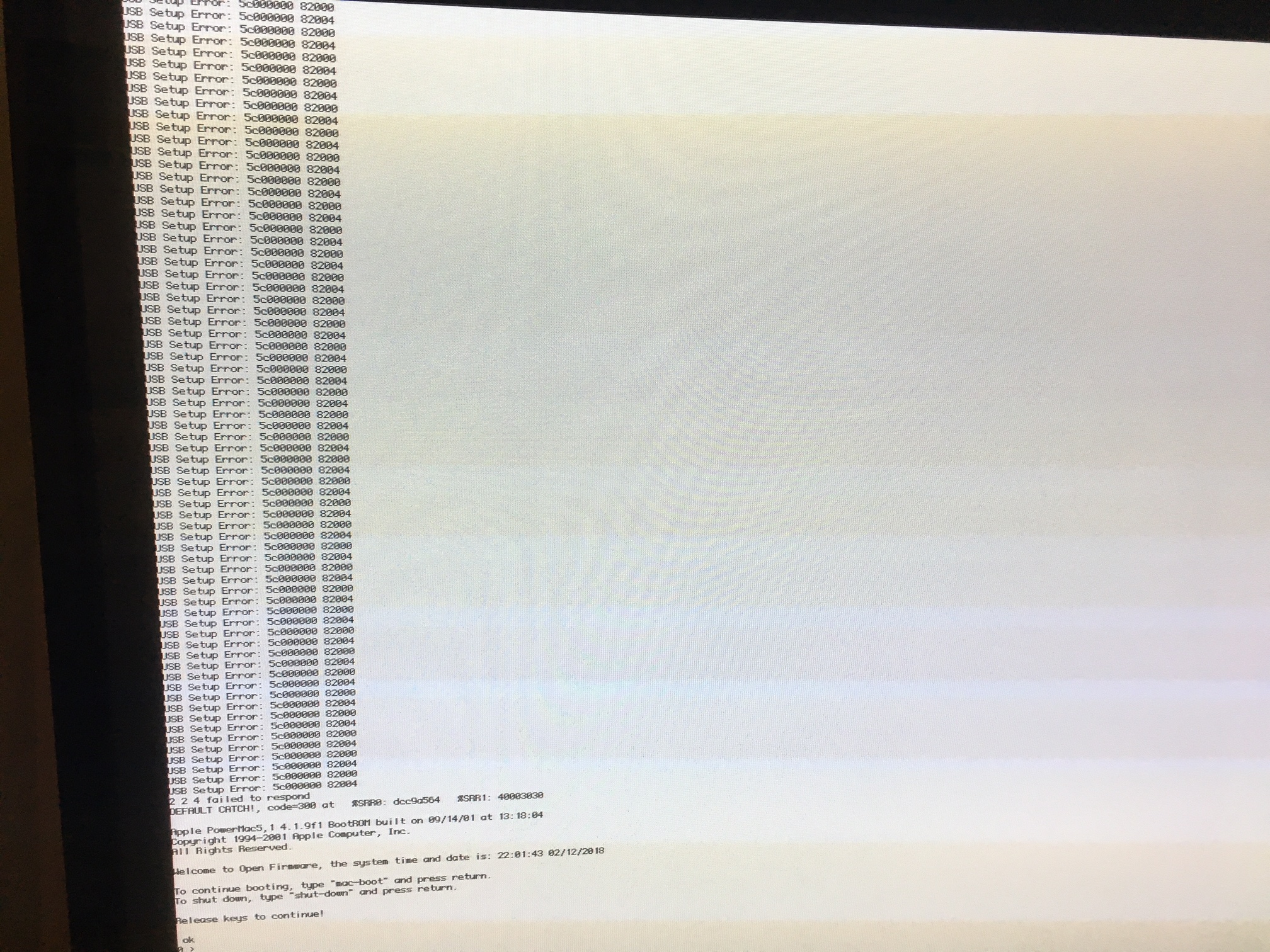

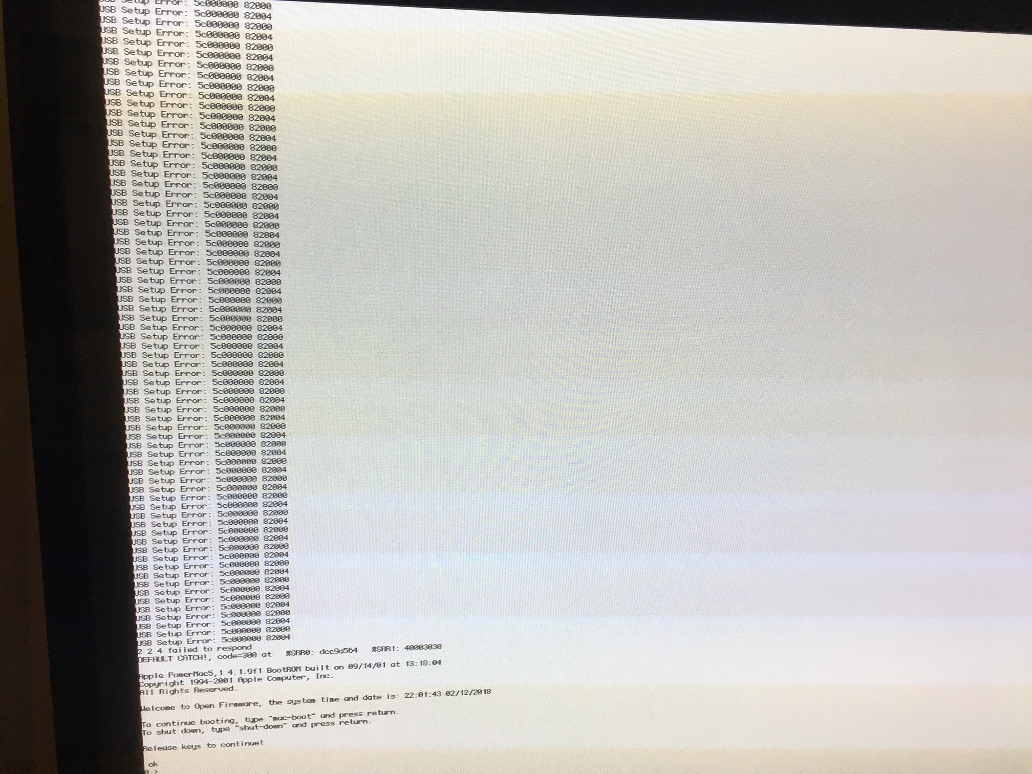

Tonight I'm getting this error at boot. As mentioned before my USB keyboard/mouse only works intermittently, not sure if it's the ports or the peripherals. Anybody seen this error before?

Finally I'm getting somewhere! It turned out the 'new' hard disk I bought was also defective as the installer kept failing at various points. So I bought another one and third time lucky, on this HD it installed first time. I have also traced the USB/kernel panics down to the mouse which had a faulty cable and was rapidly connecting/disconnecting, freaking the Cube out during boot.

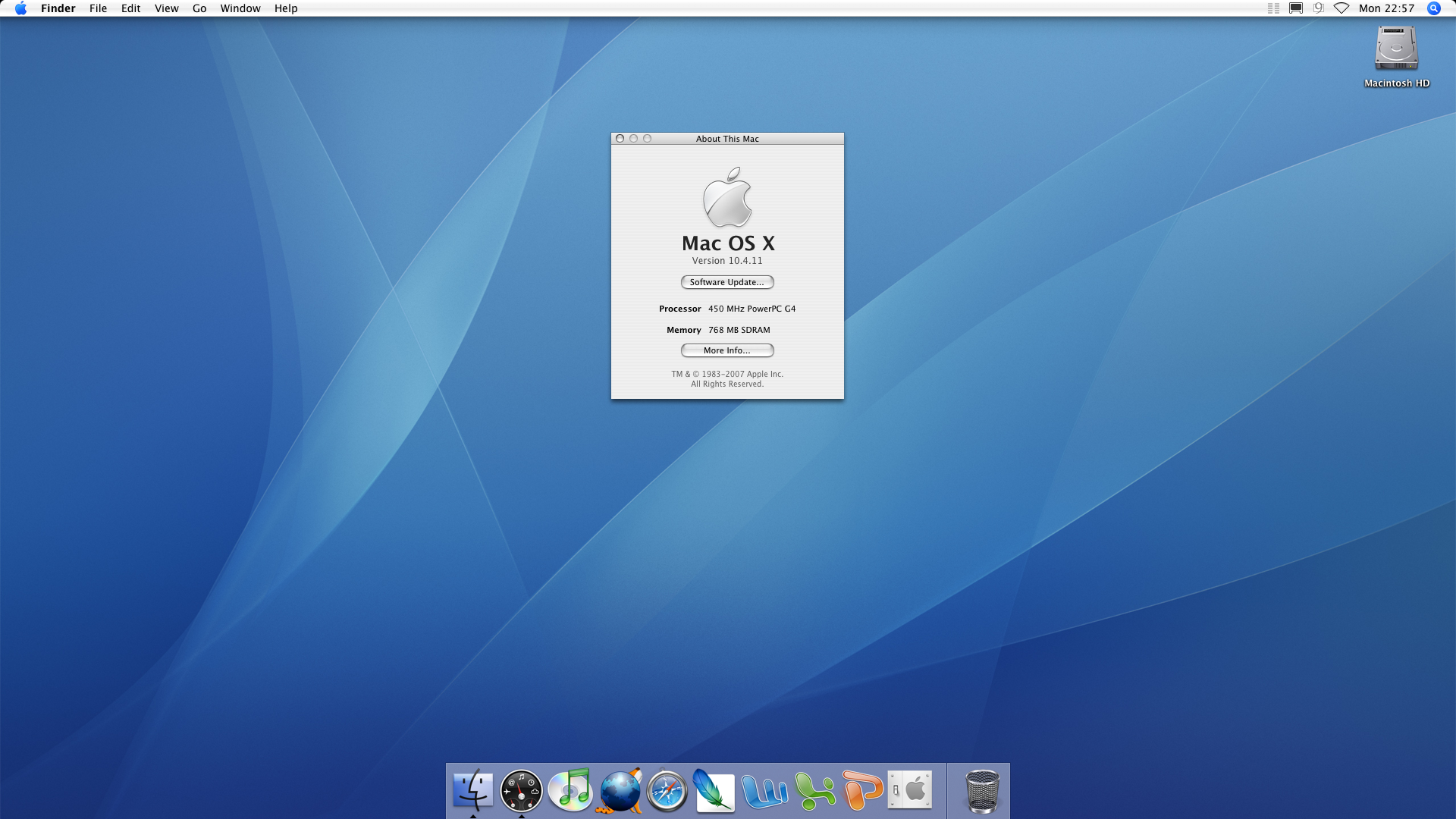

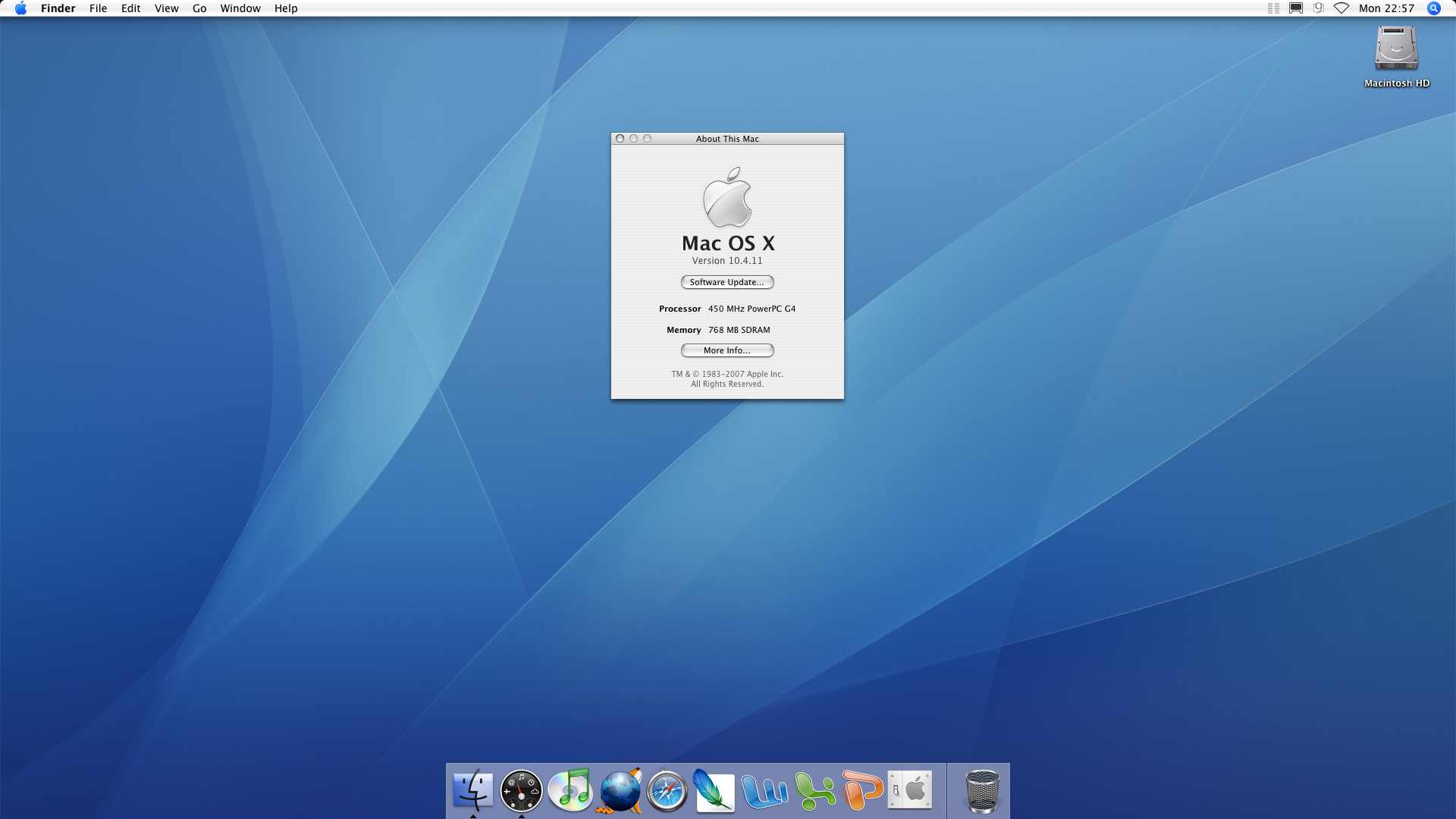

Attached is a screenshot of my new desktop with a few installed apps. It reminded me how beautiful OS X and digital design in general was during that period. I love the Photoshop and Office icons, and OS X itself is more colourful. This flat/minimal movement of the last 5-10 years has really gone too far IMO.

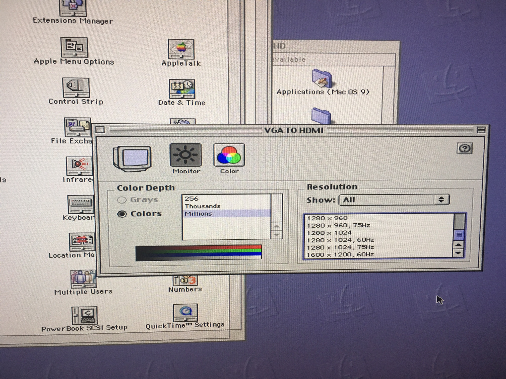

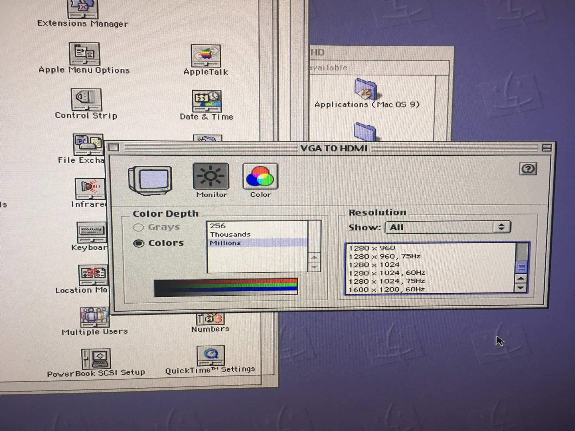

Another issue. I have bought a VGA to HDMI adapter as sadly my monitor doesn't have VGA (so far I've been tinkering on my large LCD TV which does have VGA.) This is a neat solution as it also acts as a sound card and provides audio via USB. However in OS 9 I can't get it to display 1080p!
I know the adapter can handle 1080p because it works in OS X, and I know OS 9 can do 1080p because it works on my LCD TV via VGA. Any idea how I can add 1080p to the list of available resolutions? I have tried changing it to 'all' as you can see.

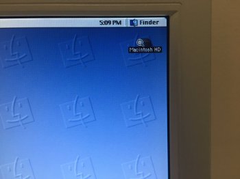

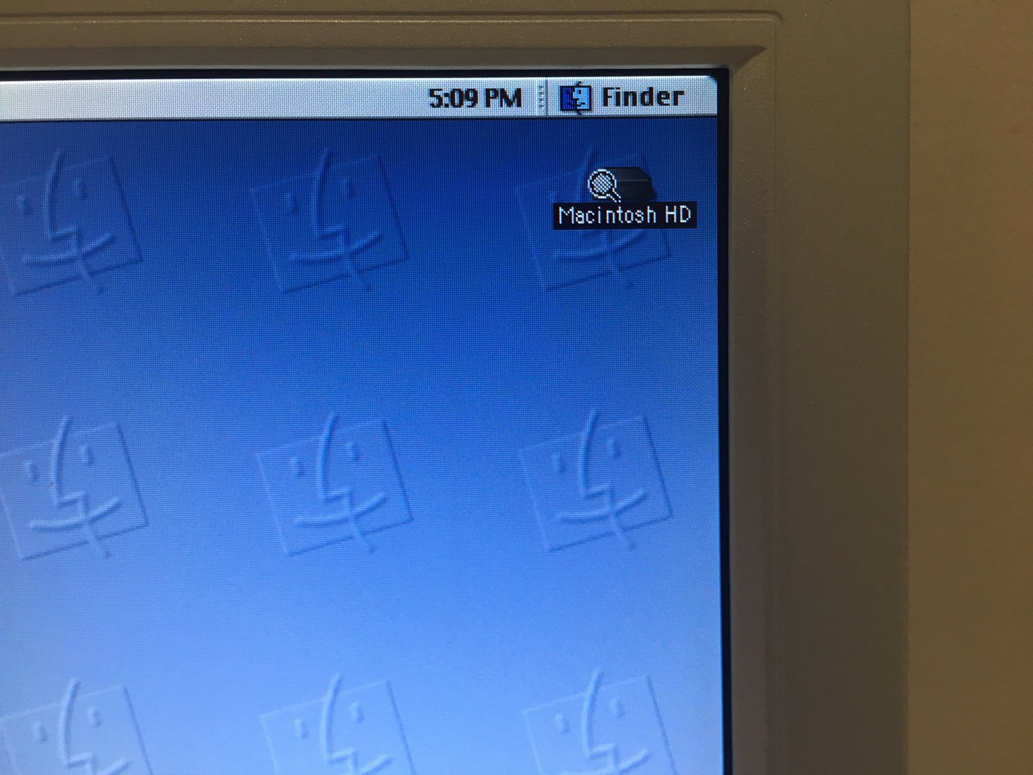

Can anybody help me with this novice OS 9 issue? I seem to have accidentally pressed a key or something that disables double click, so I can't open any folders or apps! Double clicking now just shows a magnifying glass as pictured. Any idea how to turn this 'feature' off? Can't see anything in mouse preferences.

That's the "Spring-loaded folders" cursor. I'm not sure how it's sticky like that, but you could turn the feature off in Finder Preferences (under the Edit menu)
Reactions: eddjedi
Have a look at the Universal Access control panel. I can recall that "sticky keys" was activated by hitting the shift key 5 times or something, so maybe there was a "sticky click" mouse option which was activated in a similar way.
