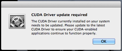

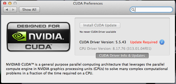

Installed NVIDIA web driver update 313.01.04f01 and then was prompted to install CUDA update. Update downloaded, then tried opening Adobe apps... nothing would start. Restarted machine and was prompted with CUDA needs to be updated but no update available error.
Restoring from my clone ASAP...

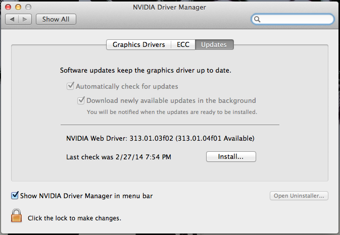

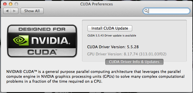

Update: Successfully restored from a clone made minutes before updating the drivers via NVIDIA driver manager. Again, running 10.8.5 and there were several issues with CUDA driver install/update after 313.01.04f01 was installed. All Adobe apps I use (AE, PPro, Photoshop, etc.) were not opening - some would crash, some wouldn't even get to the "loading plugins" screen before freezing completely.
System is back to pre-update state and all Adobe apps appear to be functioning again. Update is still available (has not been pulled) but will not be touching it for awhile. Likely will be staying on 10.8.5 for a bit longer, too...

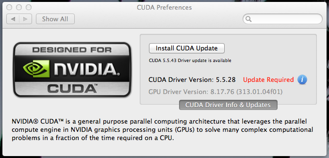

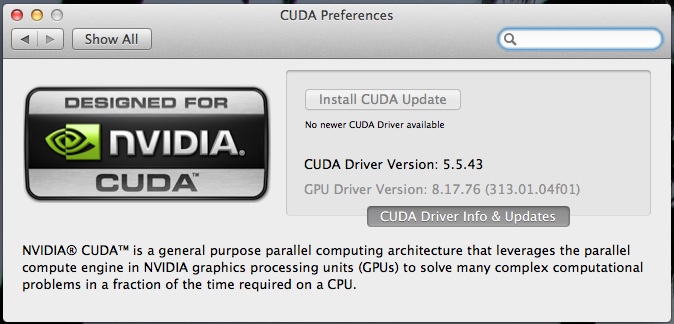

Same here. Is it possible to downgrade (I'm on 10.8.5)? I don't have a Backup... 🙄
Edit: Installing the latest 5.5.28 Version from Nvidia will fix the problem. Yeah!

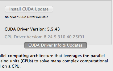

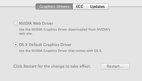

Hi!
Same problems today with AE CC and Premiere CC on Os X 10.9.2.
I've first re-installed AE and PP but the solutions is to go back to OS X Default Graphics Driver on the Nvidia Driver Manager panel.
Now AE and PP start without problems.
BUT: AE don't recognize my GTX 780.. so no CUDA.
