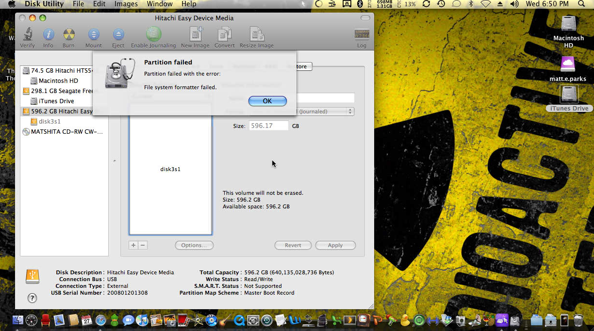

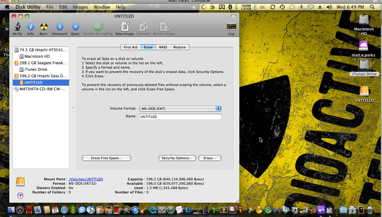

A new Hitachi external HDD i downloaded will open in disk utility, but wont allow me to partition to format (gives me an error) and wont let me run repair or anything else. Trying to figure this one out. Thanks
All it will let me do is erase the drive to FAT
I attached screengrabs when it was showing up and mounted as a FAT drive, and then how it goes away when I try to partition to format(only way I know how to format it is to use disk utility to format 1 mac os journaled partition

And you can't format the drive as anything else but FAT and why partition the drive as one section? (that's what the 2nd screen grab looks like)
Try changing the partition map from MBR to GUID. (with the Partition tab open, click the "options..." button)
You will need it to be GUID, anyway, if you ever want to put a bootable partition on the drive (assuming you have an Intel Mac).
That worked!! Thanks so much! I had no idea I needed to do that. Really appreciate it
