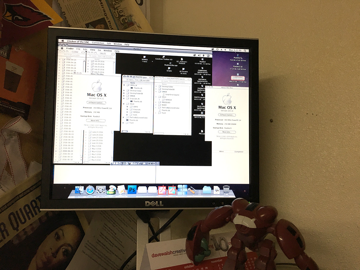

I have a 450mhz running tiger and it flies, I do have 2GB ram in it tough I think. I would try a tiger install and see if it runs also try a different gpu. I had a similar issue in an MDD and it was a bad ram stick.

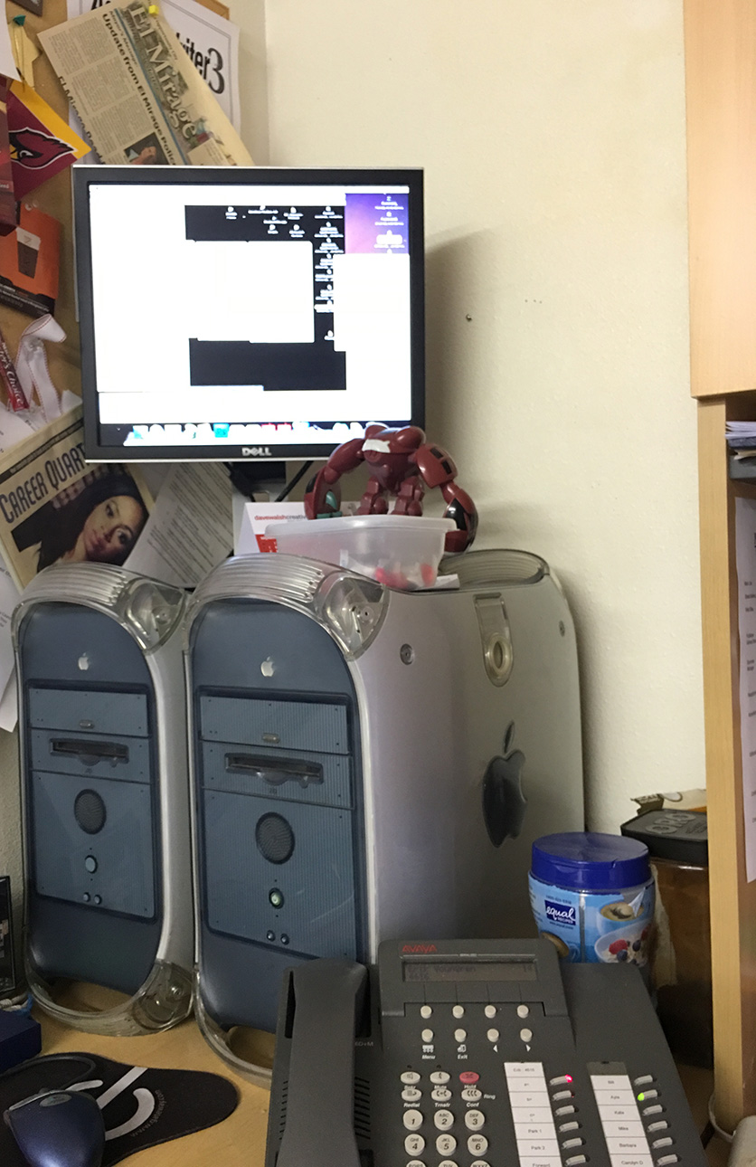

What I'm seeing above looks like a questionable GPU, that would be the first place I would test.
Reactions: beanboy89
I have a 350Mhz PCI at work running Tiger with less than 200mb of ram. Right next to it is a 450mhz AGP with 192mb of ram running Leopard.
So, the statement of not being able to run Tiger or Leopard is false.
Granted, both machines at one point had higher amounts of ram when these installs were made (and the Leopard machine had this done via TDM) but they both run and run well.
The Tiger Mac runs headless and is our Applescript server while the Leopard Mac controls the Tiger Mac via VNC, while also serving as a print server for my Mac Pro.
My money is on the GPU. The card looks quite dirty, as was the rest of the interior of the machine. I will likely try cleaning the card and contacts to see if that does the trick. Otherwise, I might temporarily test the card that currently resides in my MDD and see if that works.
