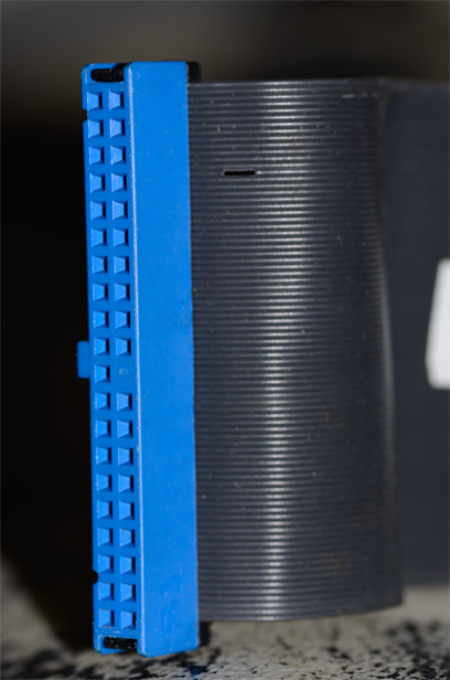

On PATA cables there are often one nick taken out of them towards the center width of the ribbon that is used to differentiate the master/slave status of the drive when the drive is put in cable select.
Like this?
That looks like physical damage to me.
Is it possible that those boot and disk errors could have been caused by that damage to the cable?
Here's a bit of a long-term update, and I don't want to jinx anything here, but ever since I've replaced that IDE cable, the computer has been booting just fine. I closely inspected the IDE cable that I took out of the G4 and I've noticed that there are a few nicks in one of the wires of the cable, and I can actually see exposed metal inside the cable. That might have been the problem.
Had that happen numerous times and the data errors often occur if the insulation is broken on two or more ribbons and they touch or if the cable grounds against the case or other metal!
Quite possible, in fact most likely!
