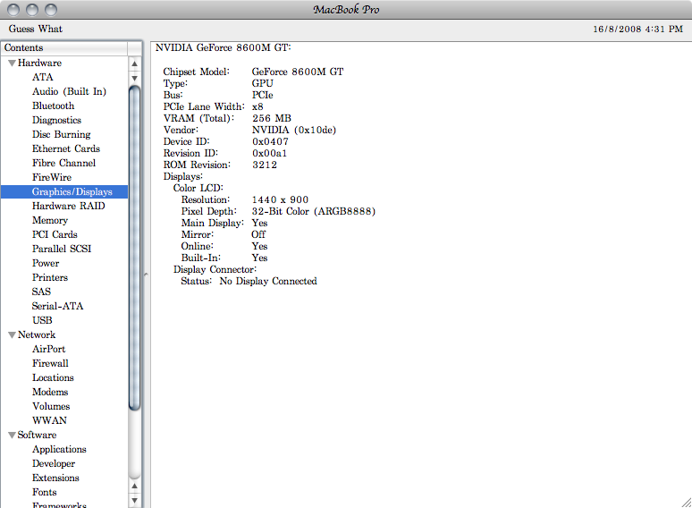

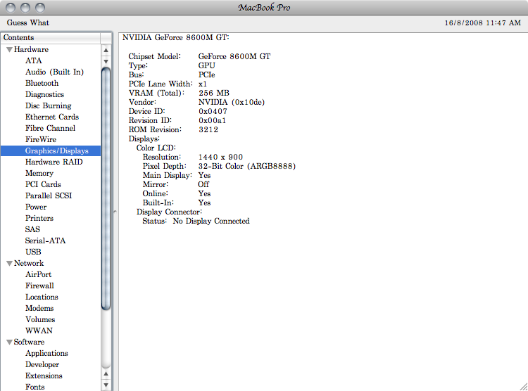

As an update, my PCI-e lane width got down from x16 to x1 then to x8. I took it to a Premium Reseller, and they said that the fix should be free, but they couldn't check, as they had to send it, and I needed the computer.

My PCI-e Lane Width should be x16, right? This time, I actually got screenshots of it being in x1 and x8.
Don't jump to conclusions just yet. I've not seen anything on this myself, but I'd hazard a guess that it's more likely to be a power saving feature than an actual fault. Is your system crashing? Any visual artifacts? Does this info change if you open something that does 3D rendering?
My computer is plugged in to the charger most of the time (my battery has a problem), and that even happens when its plugged in (the energy saver level is high, or whatever it is when it favors high performance. When the graphics goes to x1, the system gets slow and transitions don't get smooth. Also pages 97, 98, and 99 of https://forums.macrumors.com/threads/515067/ should have information about it jumping from x16 to x8 and x1.

I passed by :apple: last week, and they fixed the computer the same day. The test it failed was the PCI-e lane width test (it was on Stop on error mode).
