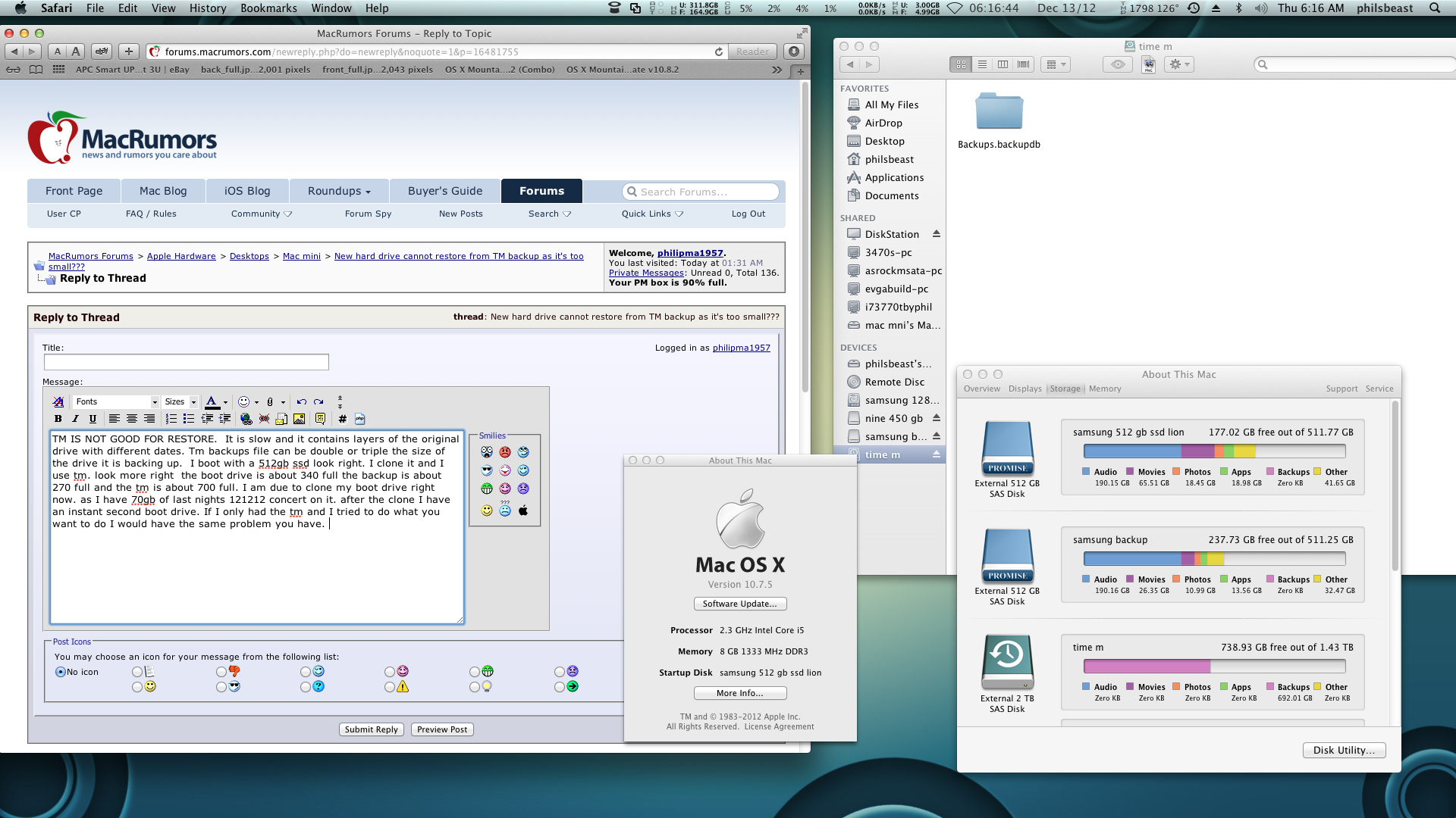

TM IS NOT GOOD FOR RESTORE. It is slow and it contains layers of the original drive with different dates. Tm backups file can be double or triple the size of the drive it is backing up. I boot with a 512gb ssd look right. I clone it and I use tm. look more right the boot drive is about 340 full the backup is about 270 full and the tm is about 700 full. I am due to clone my boot drive right now. as I have 70gb of last nights 121212 concert on it. after the clone I have an instant second boot drive. If I only had the tm and I tried to do what you want to do I would have the same problem you have. you can clone your oem 1tb to your new ssd with ccc or super duper.
you could do a internet recovery and make a booter with the ssd then try using migration assistant and the tm that may work. both superduper and ccc cloners are now paid software.
