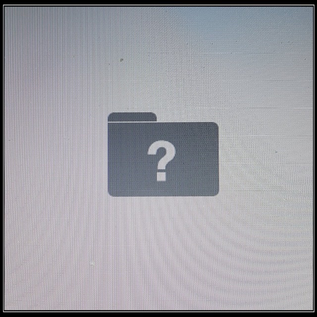

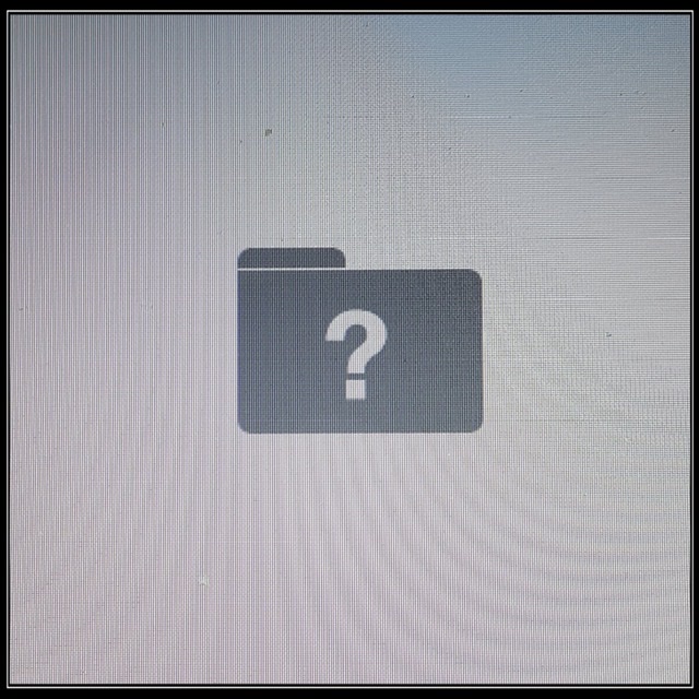

The hard drive in my old MacBook Pro died recently and so I replaced it with a brand-new 480 gig SSD. When I tried to boot the old darling back up again, it first of all started some sort of Internet download and then stopped after a while with an Error 501. I shut it down again and tried to find some information about Error 501 (without much success) so I fired it up again and now I get a folder icon with a question mark in the middle and I can progress no further.
Does anyone have any ideas on where I might go from here?

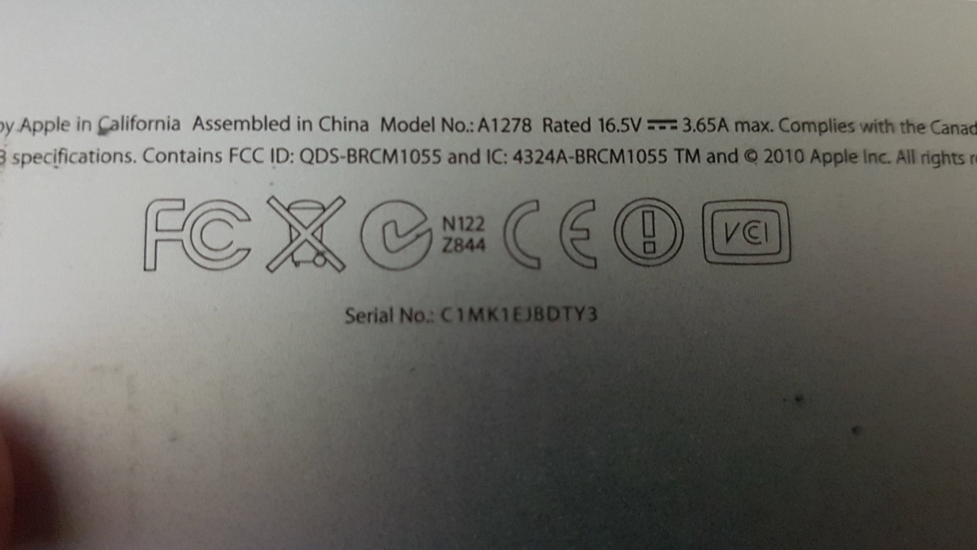

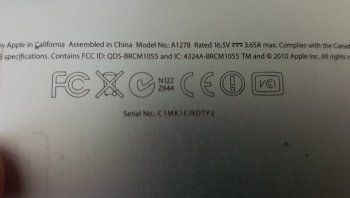

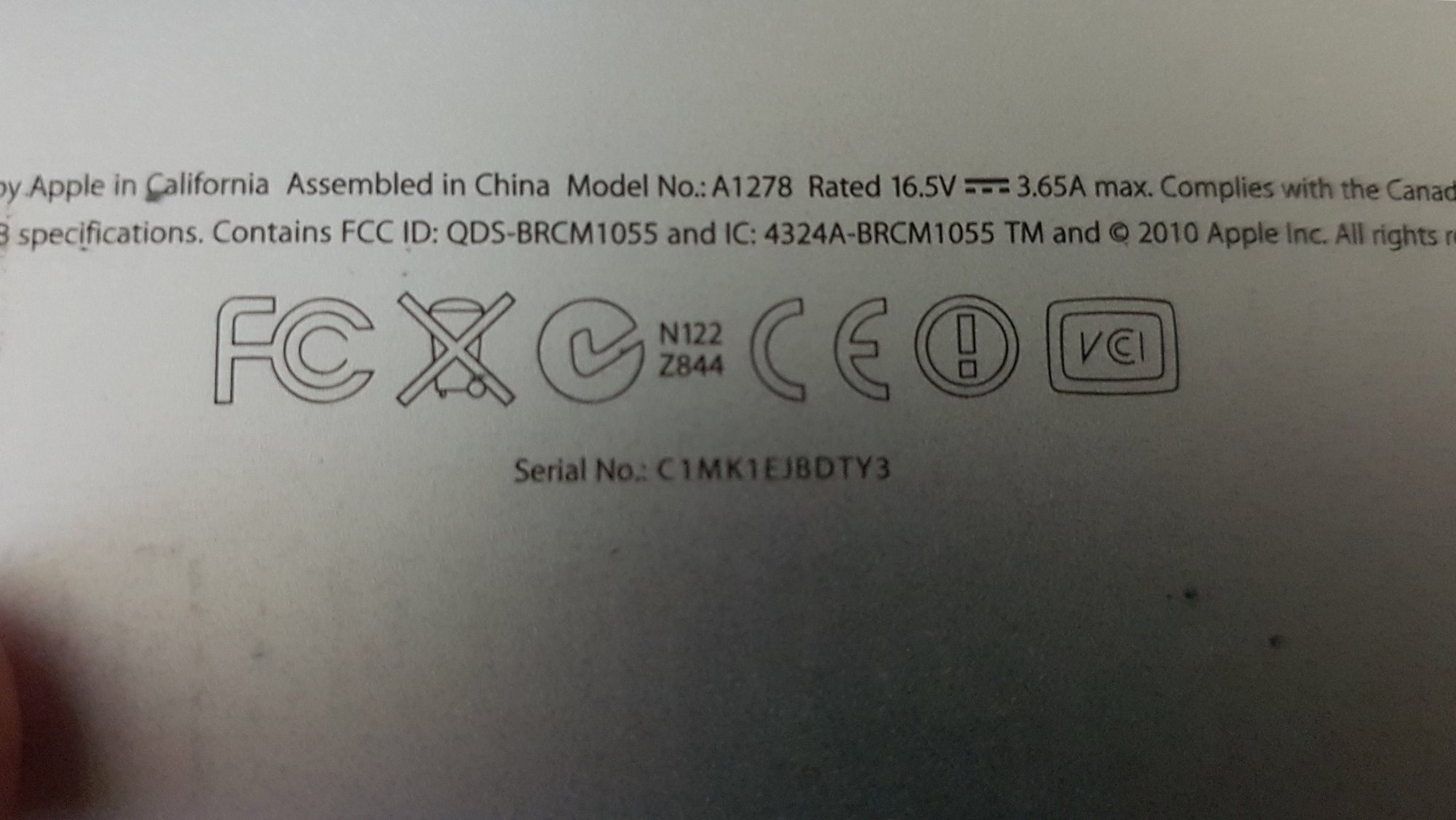

Thanks for your response. Unfortunately, I don’t have “About this Mac” available but it is a 13” model from around 2013 (I think). Would the serial number help?
MacBook Pro (13-inch, Mid 2012) C1MK1EJBDTY3
This device was made during the week beginning January 1, 2013. Making it more than 7 years old.
If a flashing question mark appears when you start your Mac

BEFORE YOU DO THE ABOVE, TRY THIS:
Your OP did not say whether you tried to boot to internet recovery or not.
Do this:
Boot to INTERNET RECOVERY -- NOT to "the recovery partition".
Command-OPTION-R at boot. You'll need your wifi password.
Can you get to internet utilities?
If so, open Disk Utility and ERASE the internal drive.
Try Mac OS extended with journaling enabled, GUID partition format.
Then... quit Disk Utility, open the OS installer, and try again.
Thanks to everyone who looked at and responded to my cry for help.
It turned out to be a combination of two things -
(1). I wasn't using the OPTION-Command-R keystroke to start it up in Internet Recovery Mode.
(2). More research on the Error 501 indicated that it may have something to do with loss of Internet connectivity. This tied in with another observation that I seemed to be having sporadic, very short dropouts in my Internet connection recently. I changed over to the Internet connection on my phone (which a bit slower but stable) and tried again. SUCCESS. I reached the Recovery Utilities screen and from there I was able to erase the drive and install Catalina without any further problems.
Once again, thanks for your help and I am pleased to report a successful outcome.
