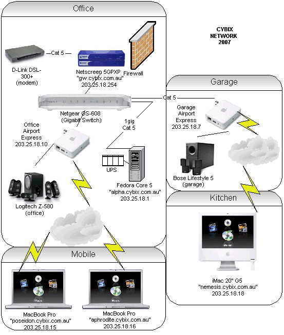

I wired SOME locations (from one end of the house to the other).
One end of the house has the comms gear (net connection). A wired run goes from this end of the house, to the other end.
At both ends I have an Airport Express (wired ethernet), not using WDS.
So both have the same SSID, and the wireless strength in the house is great, from end to end.
Previously, with just the one airport, there was near no signal at the other end of the house.
My home office is fully wired (has comms gear, and one airport in it)..
I didn't see the need to wire every room, wireless covers the whole house 🙂

see this image. "office" (back of house) has most of the gear, and is wired (in-wall wiring), with ONE Cat5e run going to the garage (front of house) with another airport attached
works sweet.
