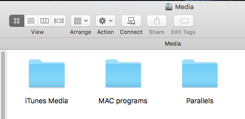

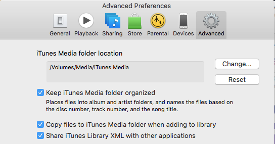

Does the path in iTunes preference/advanced MATCH the same location on your external media drive? If you show a screen capture of you iTunes perferences/advanced window and also show the contents of /volumes/MEDIA we can help verify its right.
here are mine
And
