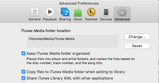

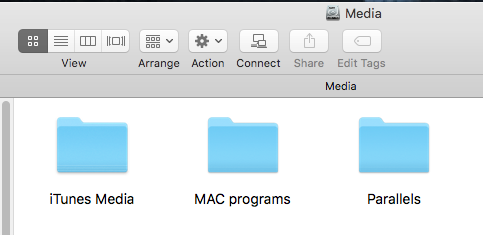

Does the path in iTunes preference/advanced MATCH the same location on your external media drive? If you show a screen capture of you iTunes perferences/advanced window and also show the contents of /volumes/MEDIA we can help verify its right.
here are mine
And
Thanks. This is what i have.
This is what I have
Reactions: deany
This is what I have
You didn't follow my directions or they weren't simple enough. Your iTunes 1 directory is a copy of your iTunes folder and NOT your iTunes media folder. Inside your iTunes 1 folder is your iTunes media folder.
There are two generally accepted ways to keep your iTunes on an external
Method 1....move the entire iTunes folder then tell iTunes to use the new library location (hold the option key when starting iTunes). Upside is the ease of doing it. Downside is the album artwork cache and database is on the external.
Method 2....what I do....only move the media folder and adjust your iTunes preferences to the new media folder location. Upside is much faster access for operating iTunes. Downside, setup is a bit more complicated.

What you do is this
1) buy 2 external USB3 drives (a 2TB and a 4TB)
2) make the 4TB a time machine backup drive, call it backup
3) make the 2TB a media drive, call it media
4) make sure your iTunes preferences/advanced tick boxes are selected that say "keep media organized", quit iTunes
5) copy the entire folder "iTunes Media" from your home iTunes folder to the external "media" drive
6) start iTunes and go into iTunes preferences/advanced and tell it your new media folder location
7) quit and restart iTunes, test your songs, movies, ...that they play
8) now you can delete your old "iTunes Media" folder in your home iTunes folder. It is no longer used.
9) turn on time machine and have it backup both macintosh HD and media
IF you add music, it will go automatically to your external media drive. The artwork cache is still on the SSD so seeing your stuff will still be fast.
