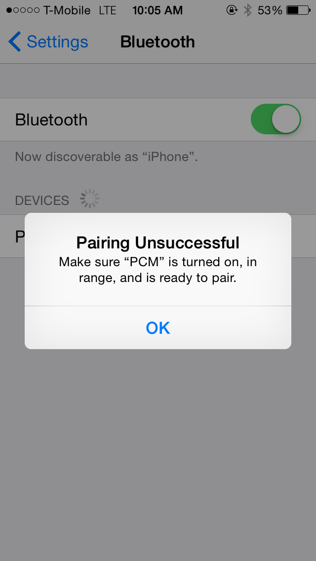

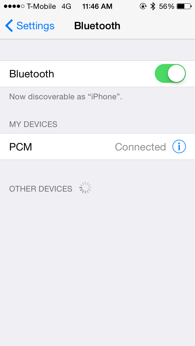

Bluetooth issue with Porsche PCM - fixed
To solve the problem here is what to do
- Remove all the bluetooth devices from your car
- On your iPhone 6 : Settings/General/Reset/Reset settings
- Your phone will then reboot
- Start your car and initiate pairing
- Turn on bluetooth on the iPhone 6 as requested by your car
- Complete the pairing and you should be good to go
It worked on my 2014 Cayenne this afternoon
- This worked for me too. It also made my iPhone 6 a whole lot faster. Perhaps when you migrate an existing backup it makes sense to reset all settings by default.
PS - I haven't tried to pair the phone with my private jet as yet - will let you know how that progresses ;-)
Phones tested:
- iPhone 6 and iPhone 6 Plus
OS:
- 8.0 and 8.02
Car:
Porsche Cayenne 2014 with Porsche Communication
Issues:
Both phones managed to connect, could play music over Bluetooth.
Calls received could not be answered from car.
Calls made disconnected after a few seconds.
Managed to fix:
- reset PCM to full factory reset and car handover mode.
- reset iPhones with 'reset all settings' (tried all other forms of reset before without luck)
- once reset was complete went to Bluetooth settings in phone and removed the leftover profiles (tried this before phone reset without luck)
- changed iPhone name (tried this before phone reset without luck)
- paired phone and PCM in car.
Now all works as it should!!!
Notes: issue defiantly comes from the phone being restored from a backup of a previous phone when upgrading. All reset instances still had the Bluetooth profiles left in them. Only reset all settings deleted the profiles internals but still left traces. Which had to be manually removed.

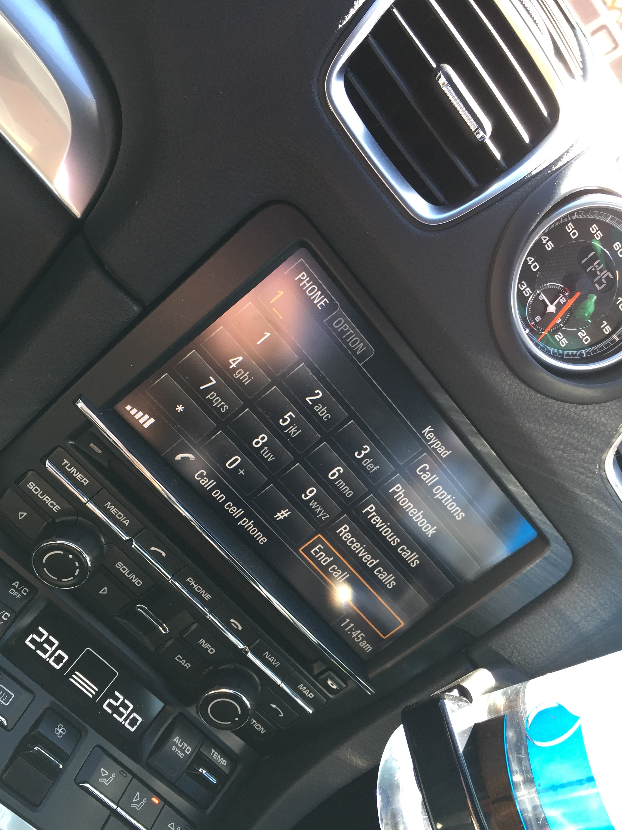

I now have another bug which shows on the car as connected as if the call had placed when in reality they are neither connected nor has the call been placed :rolleyes:
