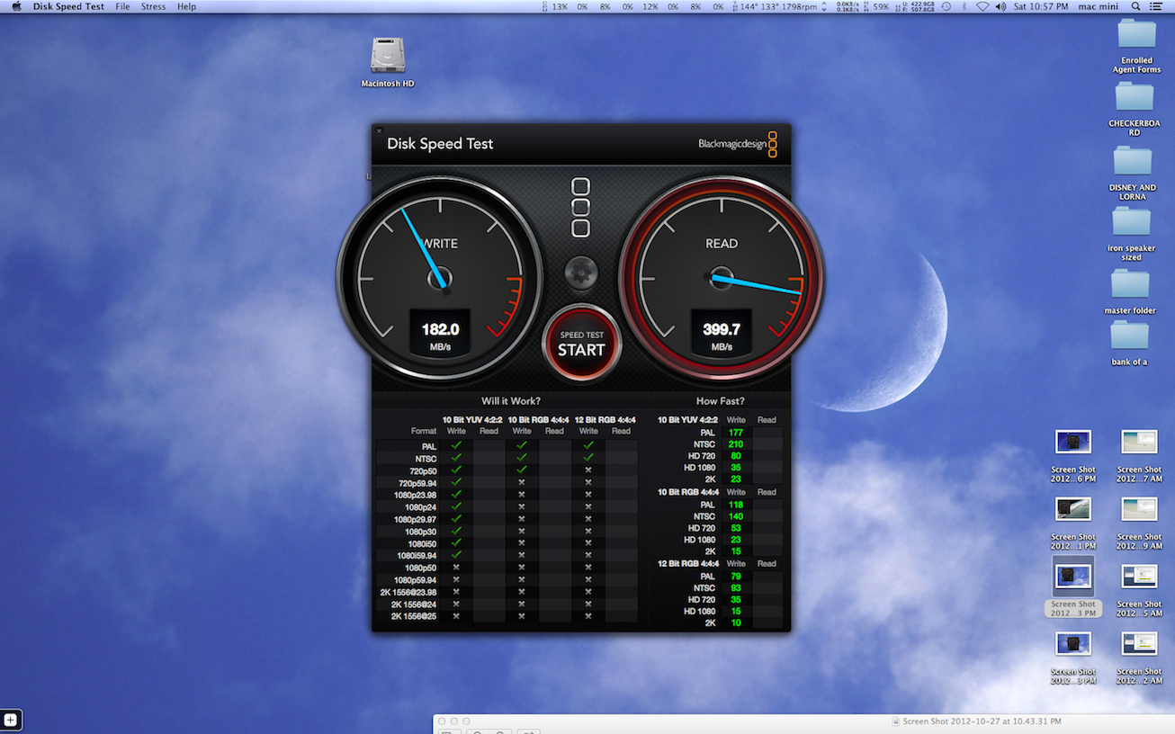

Could you run BlackMagic Speedtest please?

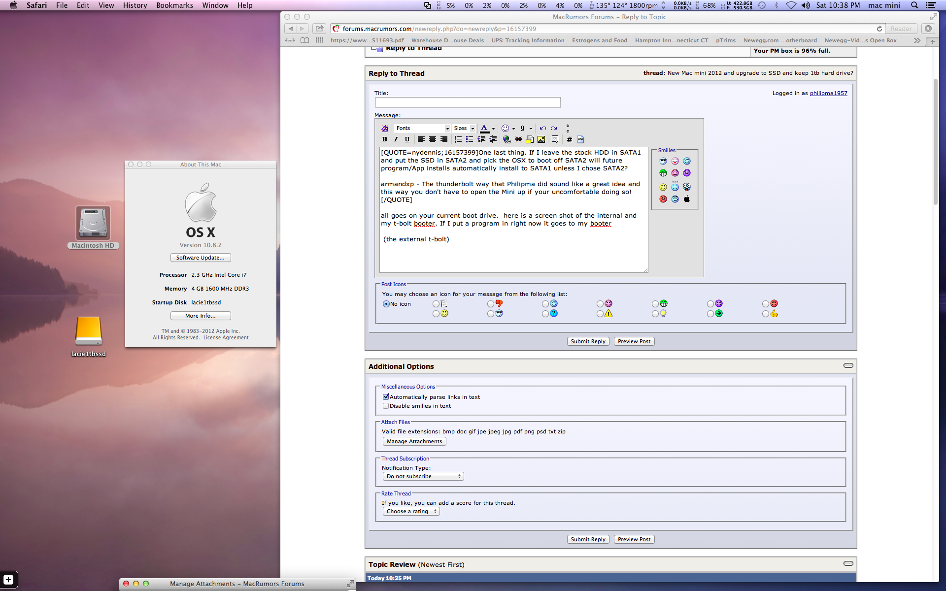

One last thing. If I leave the stock HDD in SATA1 and put the SSD in SATA2 and pick the OSX to boot off SATA2 will future program/App installs automatically install to SATA1 unless I chose SATA2?
armandxp - The thunderbolt way that Philipma did sound like a great idea and this way you don't have to open the Mini up if your uncomfortable doing so!
all goes on your current boot drive. here is a screen shot of the internal and my t-bolt booter. If I put a program in right now it goes to my booter
(the external t-bolt)
here is a black magic test.
it was about 199 399 but I froze it with a screen shot just a bit off. remember black magic gives very low write numbers. still these are good enough for me.

Can you post what kind of Read/Write speeds you get on the TB drive? (in the time I wrote the question you posted the picture!! Thanks!)
Does the OS feel nice and snappy (just like an internal SSD??)
Lastly: So what external drive do you have there (Lacie_1TB) is this a Little Big Disk Thunderbolt in Raid0 with two 512G SSD's? Write speed looks more like SATA2 not 3.... just curious...
