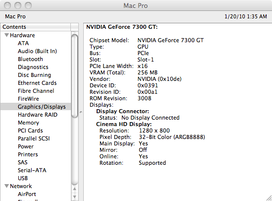

Looks very promising...I was able to dump and flash new ROM on a 7300GT. Also working on 8800GT. It is likely that we will find this to not work until an Nvidia card is already a "Mac" card...but again Netkas little "helper" app that enables PC Nvidia cards to work with a "helper" EFI Nvidia will be the "go around"
BTW...the new 7300GT ROM is indeed quite different...can't tell what it changes but doing a "compare" shows many changes.....most notably in the EFI part.

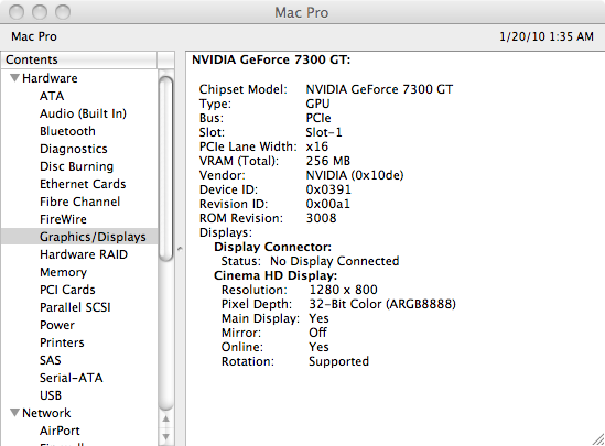

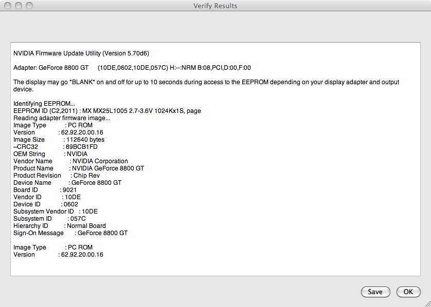

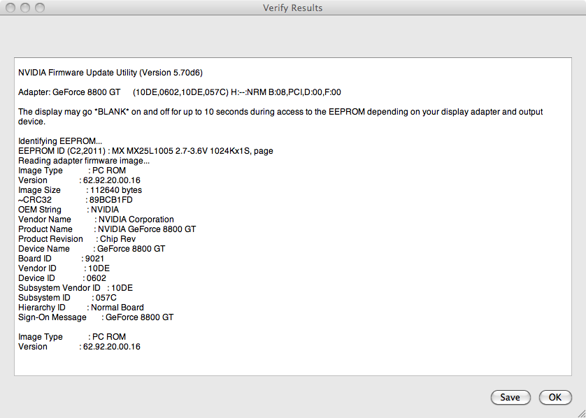

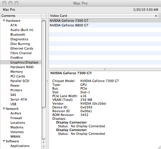

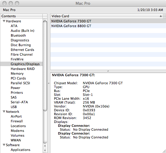

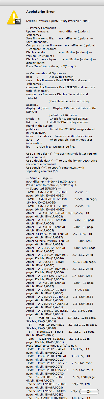

Not working for me. Error: No Nvidia card detected. Tried -c and -a with 7300GT (original) and 7800GT (PC). I extracted nvcmdflasher and nvFlashDriver.kext. Kext installed with KextHelper. Without kext also that same. I'm running 10.4.11 (MP 1.1). It requires higher OS version?

I can NOT figure out how to use Platypus to update the commands. The "Flash" and "Dump" buttons apparently link to unseen commands which WERE the right ones in NVFLASH 4.44 that this was originally written with. With new version 5.70d6 the only correctly linked command is "Get Info".

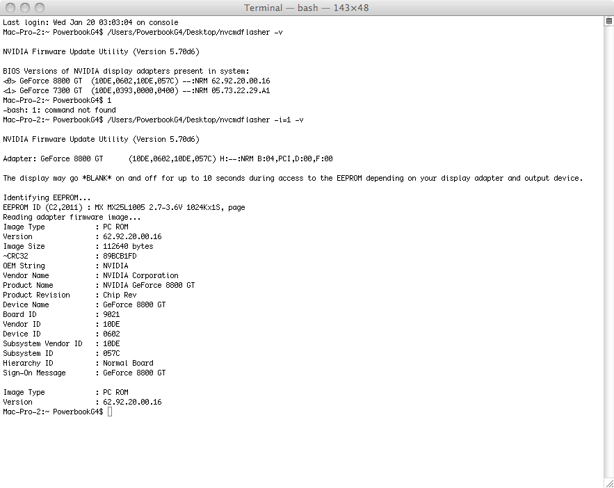

SOme useful commands that I have tested in OSX :
"-v" = information....even gives EEPROM Chip part # ...also gives index #
"-i=X" = where "X" is the index # given from above....needed when there is more than 1 Nvidia card
"-4 -5 -6" = overrides MOST flash troubles...Device id, subsystem id and board id.
"-b dumped.rom" = dumps ROM with name given

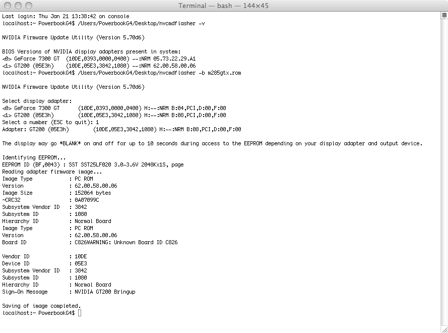

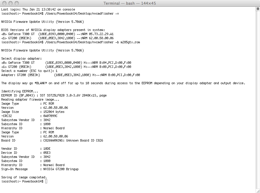

BTW...I was just able to get info from and dump rom from a GTX285.....I think because I finally had cards in proper slots.

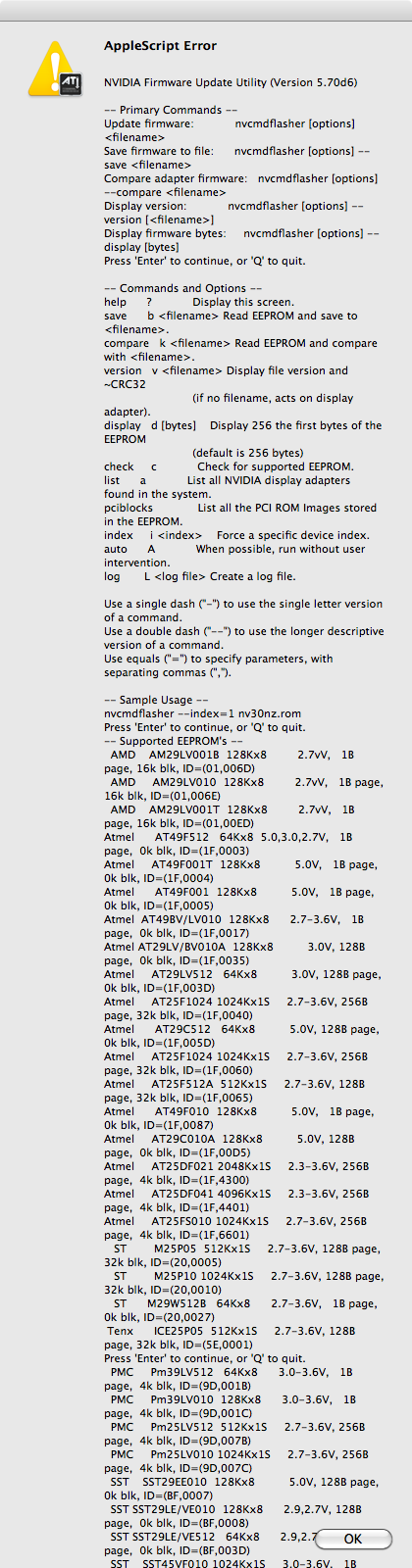

Just tried with 7300GT as only card, worked to dump but couldn't flash..gave the attached error
The index # is gonna be an annoyance. I have never been able to get it to work right for flashing in Mac Pro, either in DOS or now in OSX. Works to pick which ROM to save, but in example of GTX285 and 73gt, it always flashes the 7300GT, even if I specify index number for gtx285
I have been able to flash non EFI cards....but need to clarify under what circumstances

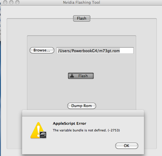

still a no go

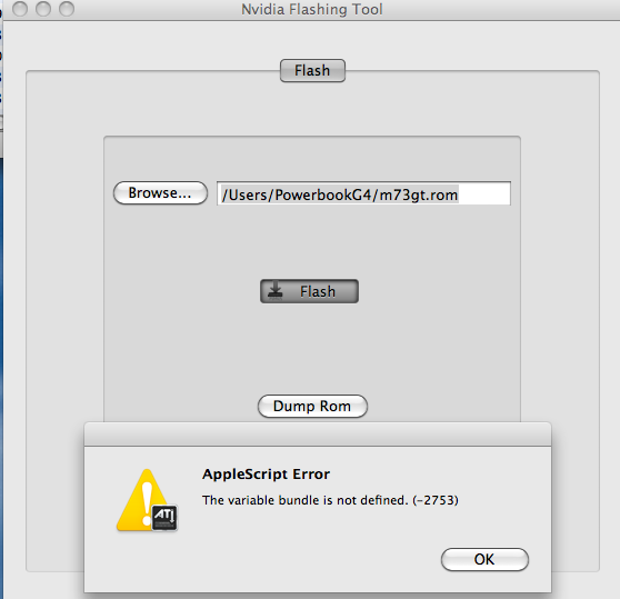

it would appear that it isn't getting commands it expects, any attempt to flash results in screen attached.
Does ANYONE know Platypus?

I am getting this problem... It says it can't flash with file. I'm using the dump from card. Im having same issue if I go terminal.
But the flashing script should be fully functional.
Info button not done yet.
btw knowing platypus would not help anything cause what you want is the sourcecode of the script. you need the source, you can't access this in binary.
I can flash just fine in terminal...so issue must be in your script

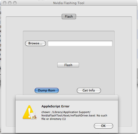

this seems to think I have the kext someplace it isn';t.....but maybe is on your HD?

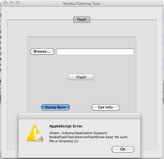

look:
so script is working like terminal...
anyway for that kext problem, fixed it, now try:
http://groths.se/Nvidia.zip
try to not use any other functions, only browse/flash
I'll break down for you what buttons does:
Browse creates directory NvidiaFlashTool in Application Support, copies your selected rom there, named flashrom.rom
Flash creates directory Kext, copies driver there, repairs permissions
Copies nvcmdflash to NvidiaFlashTool
Loads driver
Then calls nvcmdflash with command "flashrom.rom"
reason behind all the copying is because I can't figure out how to properly load the kext from inside app resources.

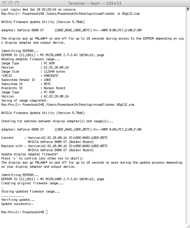

useful info. I can do all of those functions when commands typed correctly and ROM is where it is expected to be.
Look at my terminal logs above....btw...it looks in your user folder for the ROM specified...not at root.
rommy did you try my updated link?
btw what did you meant with "it looks in your user folder for the ROM specified"
Yes, I have tried 3 versions.
Can you number them? ie....1.01...1.02...1.03....easier to be certain which version we are testing
it (nv flash app) looks in your user folder (folder of user you are logged in as) for the ROM specified" (Rom specified means the one you are asking it to flash with)
So...............if you want to flash with a ROM called "m73gt.rom" you would place that ROM in your user folder. Looks like yours is called "Oskar". The other folders in your user folder are "Desktop, Docuents, Downloads"...etc. AFter you place the ROM in your user folder, then you load the kext. After it is loaded, then open a term window. Next, drag the app to the window, it will load in the path, after this type the name of the ROM you have placed in your user folder. To override all of the usual tests, you then type in "-4 -5 -6" then hit return. It should ask for a "y" three times or 4 times if needed keep hitting "y".
so, in term window is "(path to nvflashhapp) m73gt.rom -4 -5 -6"
hit return...hit "y" where appropro...working for me
