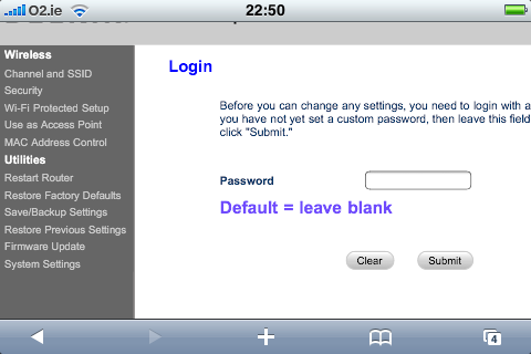

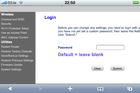

This is the web interface on my Belkin router (taken on my iPhone), is yours different? The 'Use as Access Point' option is visible there, so I'm guessing your web interface must be different?
Have you looked in your MBP's network pane to see how it's IP address is allocated, either it's manual; or it's receiving an IP address via DHCP from the N router or the wired hub.

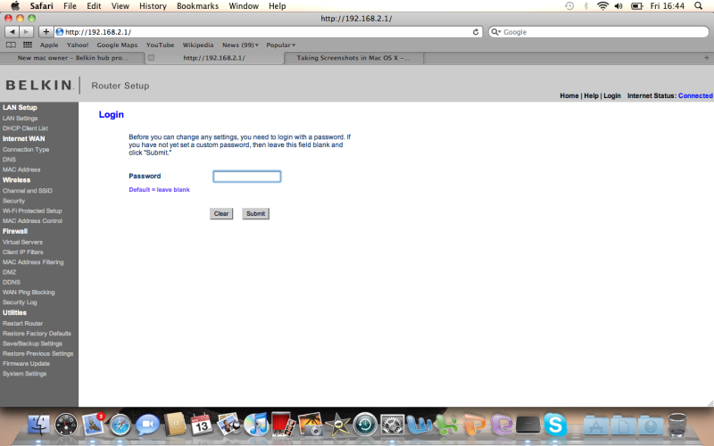

My software must be different form yours;
Really struggling with this now😡
Ah, sorry. It does look like a different version.
Can you post the model/serial number of your Belkin router, I can take a look at the online manuals.
